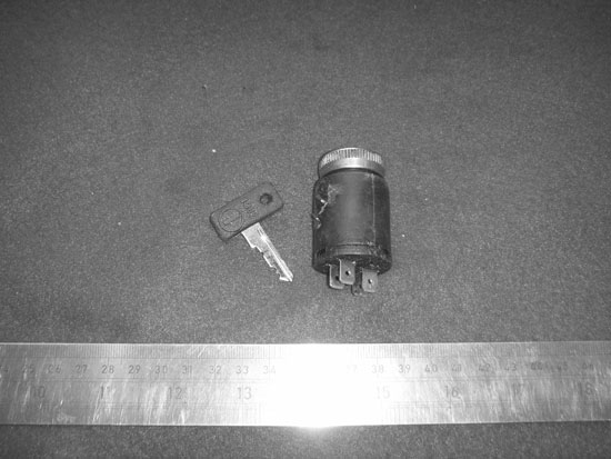

    Anyway - this one any good?
    Fits Moto Guzzi Le Mans 1000, Le Mans 1, Le Mans 2, G5, Convert, Le Mans 3, T3, T4, 1000S, Mille GT, Strada 1000, Spada ALL, Cali 2, Cali 1100 (1994-1997), V35 ALL, V50 ALL, V65 ALL, V75, 750 Targa, Strada 750, 750T, 750 SP [​IMG]
    Ignition Switch
    ELA17735
    £27.30 INC VAT
    £22.75 EX VAT [​IMG]
    [​IMG] Zadi ignition switch with 2 keys
    4 male spade type connectors on underside, replaces original switch with bullet connectors. See ELA10005 for female spade connectors
    quantity[​IMG]add to basket
    Dimensions: 54mm long overall (including pins) x 29mm More than 5 in stock
    31735360 GU31735360 31 73 53 60
    3173 5360 3173.5360 31.73.53.60

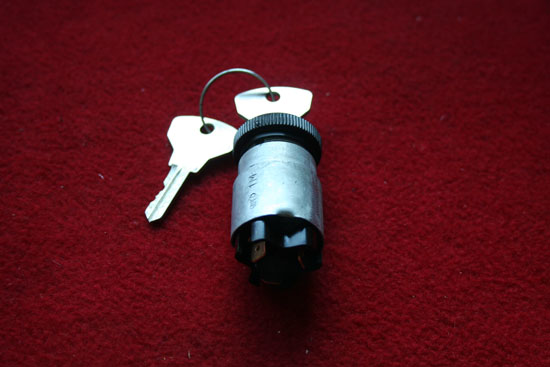

    Or this one?
    Used Ignition Switch
    ELG17735
    £12.60 INC VAT
    £10.50 EX VAT [​IMG]
    Example photo for illustration only Zadi ignition switch with key
    6 month warranty on this part [​IMG] We are still working on listing our used stock, please call or enquire to check availability of this part

  13. Top one Al (@Arquebus ) is the Zadi I have in it. It's Ok, but if it's the switch and not my sausage fingers that causing the issue I'd like summit else.
    The second does look like an original, bit tatty
