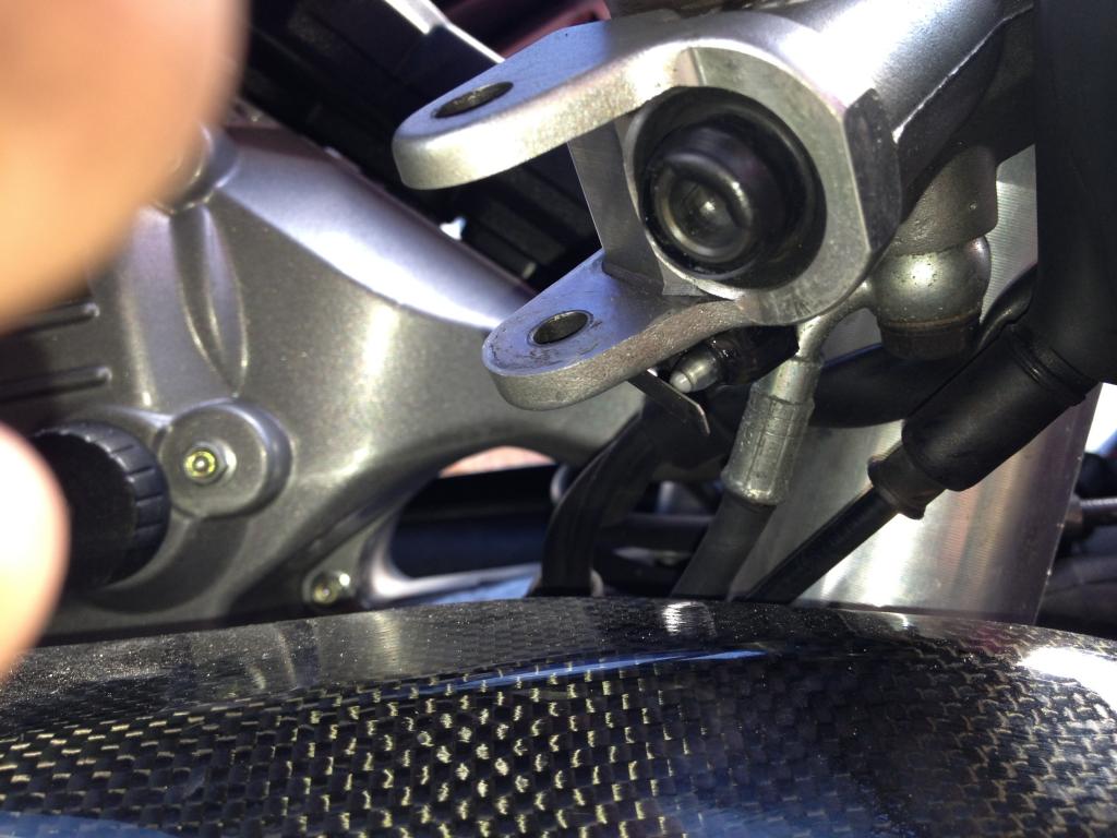

    Had the lever off as in the pic. When I push in to the black concave part fluid leaks out from the micro switch below. Would anyone with more knowledge than me know what part I need to replace?
    Thanks.

    I can't see any fluid in your pics, so it doesn't look like the master is at fault to me. The little weep you're gettting round the switch isn't enough to lose *all* the fluid, is it?
    It's far more likely to be the seal on the clutch slave. Take the 3 bolts out of the slave cylinder and check if it's wet.

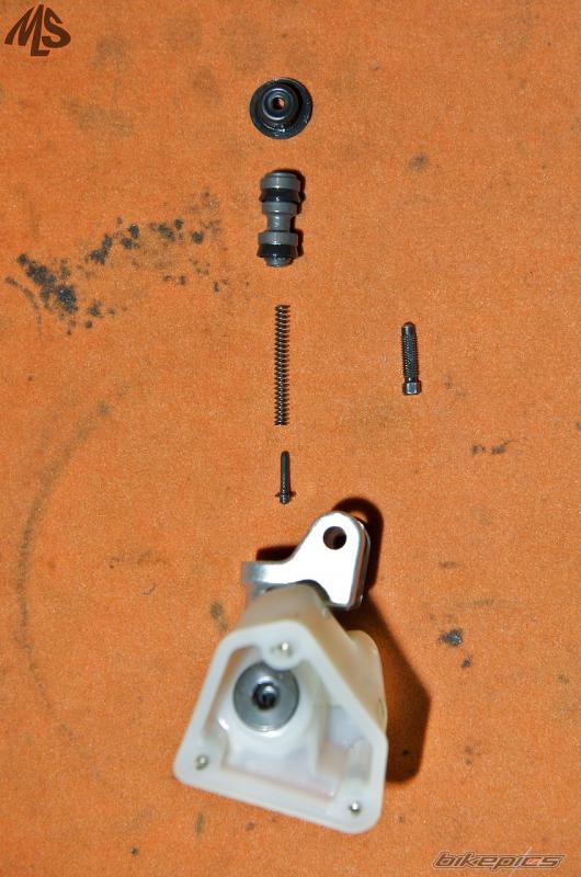

  9. Thought I'd give this thread a little bump. I had a similar problem today on my baby r. Mine didn't empty the reservoir but there was fluid around the dust seal. When I removed the lever a couple of mililitres came out.
    I have followed the advice on here and stripped the master. I figured I would post an image up so people can see it stripped and explain how simple it was. I was a little unsure of how to do it but I went with it anyway. A fine tip flat head screwdriver to remove the dust seal which holds the piston. Slide the piston out followed by the spring and holder thing which keeps the spring in place.
    I always thought it strange that there was no capability to bleed just the master at the lever end. I now know that the little 6mm nut/bolt is the bleed nipple as I can see daylight through the hole into the cylinder.
    I also checked the slave for fluid and all was well. I'll re-assemble tomorrow and hopefully it'll be ok. If not I'm sure I can find the seals somewhere rather than replace the whole unit.

  12. Yep, master strip is easy. And you can bleed the master via the bleed nipple in the reservoir .... However, you can not buy a rebuild kit for the standard master fitted by Ducati grrrrrrrrrrr
    The unit is a Brembo radial master, however, it is not designed to be re-built. If leaking, it is a matter of replacing the full master cylinder, either with new unit at approx £160 ish, or used of eBay at £95 ish.
    Went through the same heartache and problems 2 yr ago on my 749.

  18. Still got this problem :(
    I've got the slave off and all seemed ok in there, although this was as the bike has been standing for a while so no clutch fluid remains (apart from on the garage floor) so i refilled the reservoir, pumped it through and it started to bubble slightly at the little hole in the picture. Is this how it should be?
    Thanks.
    http://i.imgur.com/fqZDjrq.jpg
  19. Ended up ordering an Oberon slave in the end to see if that was the reason for the leak (as the puddle on the garage floor was just in front of the rear wheel) and seems to have cured it. :)
    Not sure why there was a tiny weep at the master. A local bike mechanic thinks maybe i overfilled the reservoir.
