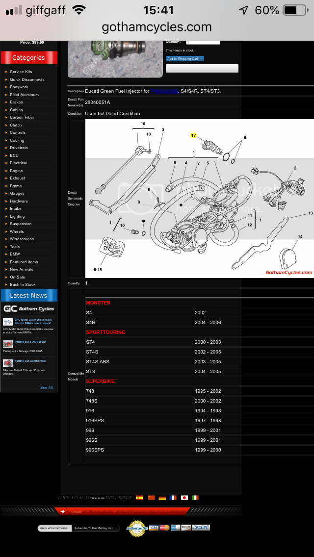

  13. did you look at the link on that post oldtech? WEBER IW 031 is the Weber designation on the body for 748/996 etc as per link... ??
    A good trawl on the Internet will give you most of the injector data and cross referencing, there is even quite a lot on this forum. 8v Lancia integrale use IW 025 but I’ve fitted 031 injectors before as so little difference.
