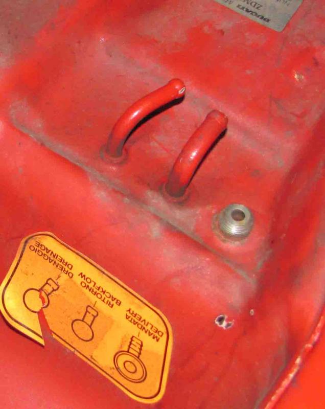

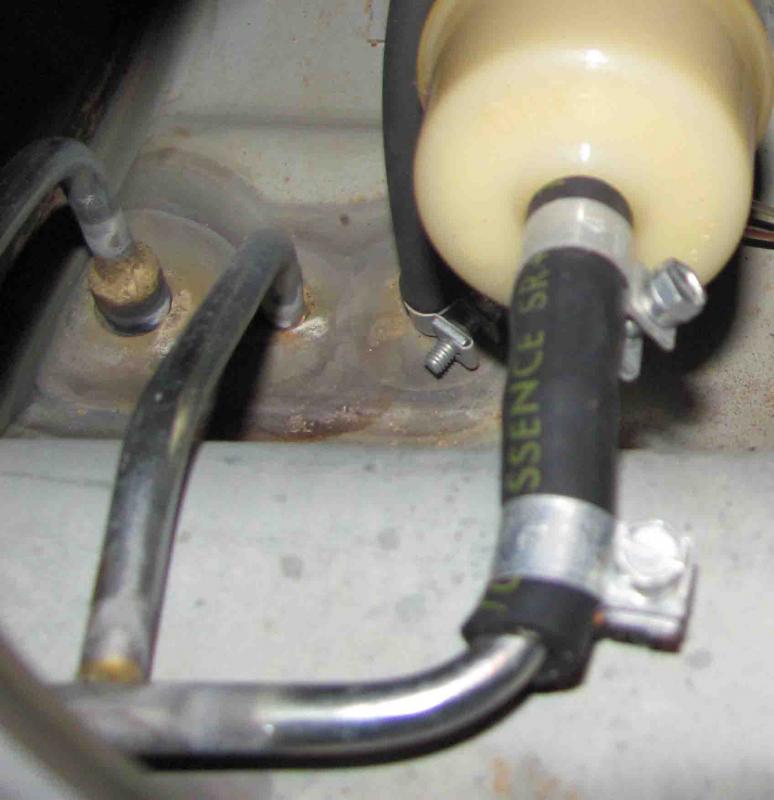

  13. If you couldn't find a suitable union, it wouldn't be too difficult to make one.......Say, a 12 - 15mm dia brass threaded bolt and suitable nuts & washers, drill the bolt 8 - 10 mm dia hole after having cut it the right length.........then bend a length of 8 - 10mm dia copper tube (I have got a coil of it here) at right angles, insert the straight leg into the bolt after having given it a damn good clean with abrasive cloth; then blow torch; flux and solder......
    But for added info....see below (not mine I hasten to add).......I reckon the return spigot is 10mm dia (the hose is 8mm bore) so guessing, the drain is 8mm diameter.

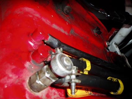

    As you can see from this pic (if you squint enough) the outlets on my tank are a tad more complicated than the ones in the pics above. I'm not entirely sure how I would remove them (it) without making a rather large hole in the tank floor.
  16. Well you can certainly drill the drain spigot out easily, because the floor of the tank looks as though it is reinforced around the spigot and I'm sure we could find a source for a suitable 'bolt - in union'....
