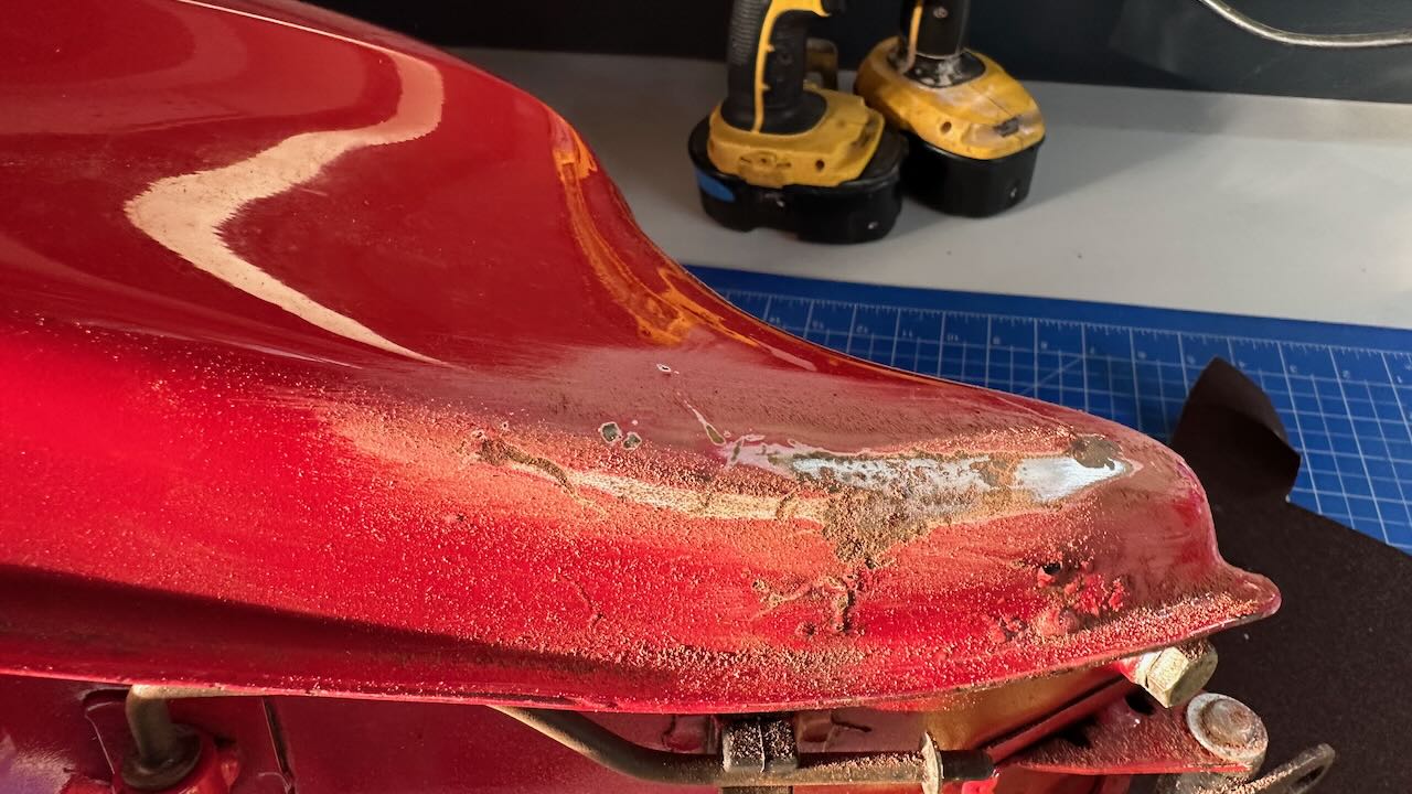

  1. Went to fill up and start the bike for summer, and discovered fuel is weeping out of this spot of rust on my tank. It's very slow in leaking.
    The tank has been (badly) painted on the inside by the previous owner with what looks like hammerite.
    Do you have any suggestions on how to approach fixing?
    I'm guessing, rub it down, and solder.

    I'll take the tank apart and give the area a rub, it might be obvious what is going on.

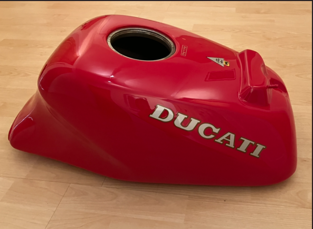

  9. My Tank was literally a sieve. The garage I was using said it was scrap. I sent it to Dream Machine Nottingham. They stripped it and welded in a new plates at the rotten underside. They also removed a dent, new paint and decals. Came back like a new tank ! Can't praise them enough. Screenshot 2025-03-12 100007.png

  13. Looks good and similar to my experience.
    Welding a new section to the underside of the tank shouldn’t be considered as a last resort, it’s a sound solid finish and removes the chances of it perforating again in the near future.
    Did you seal the inside?

  15. Hi, Yes I did seal the inside

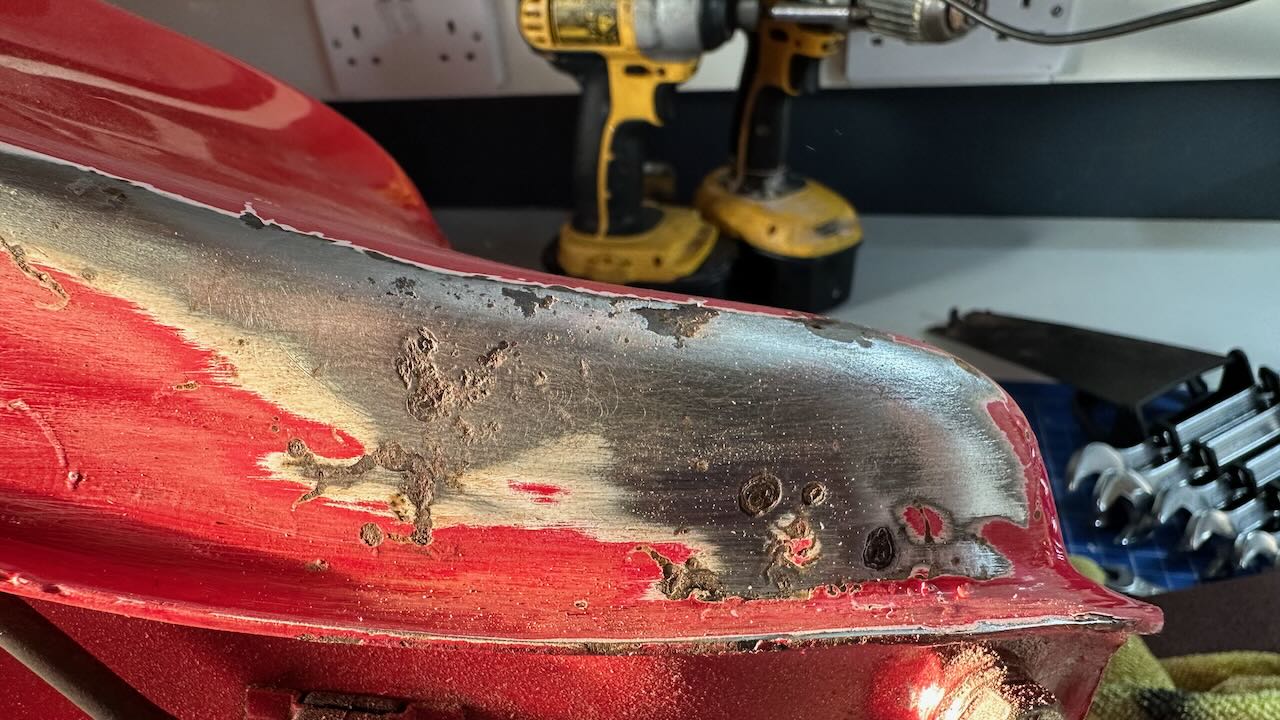

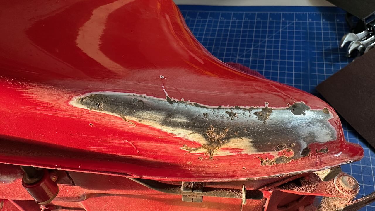

  19. Not entirely sure what I am doing here but I have not seen any apparent holes yet. The tank was only leaking slowly; the smell of petrol was more prominent, and there was a slight damp patch beneath the frame.
    I'll keep rubbing....
