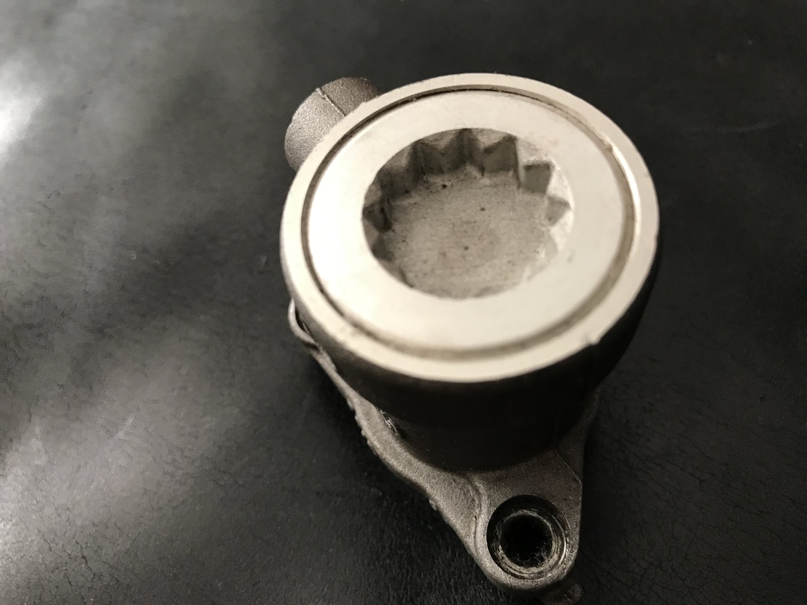

  5. image.jpg If its a ‘star’ style slave like this they are not rebuildable.

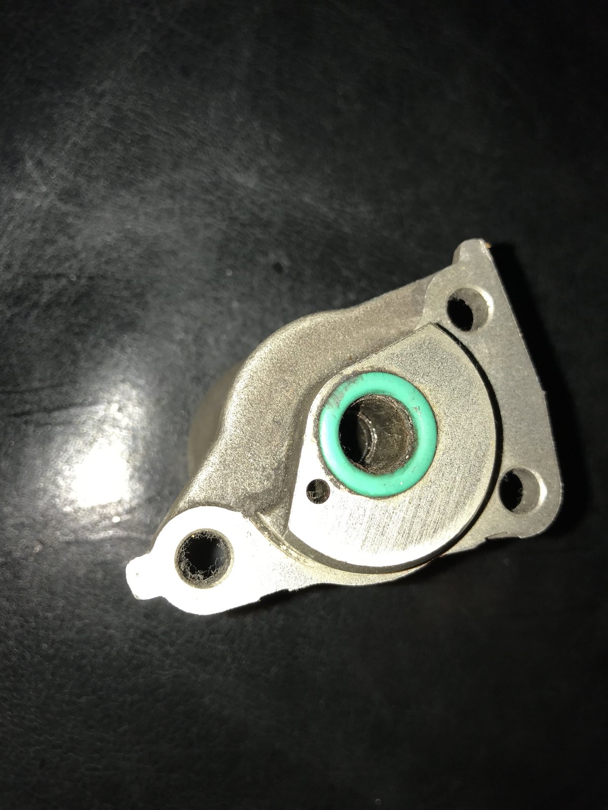

  7. Where is it leaking from? IF it's the slave cylinder O-Ring I can post you one :)
  8. I've not pulled it off the bike yet as it's still working!
    Apart from the reservoir emptying the only sign of leak is fluid on the cases below the slave.
    Where in the assembly is the O ring? My newest parts list features the previous type slave.
  9. Between the slave and the casing, they are all the same O-Ring on all OEM external Slaves, 2 minute job.

  12. The green or red O ring is to keep crud out, similar job to the bellows on old style slave, the piston seal was replaceable on old style, its about 20mm dia with V lipped outer edge.
    To replace the piston seal on later ‘star’ slave, the star would have to be removed which would need special tool plus possibly heat and also need re-sealing when screwed back in, providing the piston seal is available.

  14. What size o ring is it @Exige?
  15. About 11mm OD and 1.8mm ish section dia
  16. That’ll replace the green o ring on pic then.
  17. Yes, that is where it fits :upyeah:
