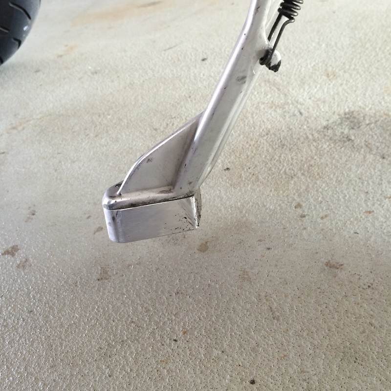

  1. Side stand question anyone else got a 999 that looks like it's about to fall over when it's on the side stand. Or has anyone tried a billet one from slipstream racing (or a UK supplier as they are in the states)

  2. Hi Martin,
    Some differing options here. I went with a new stand, fitted at main dealers for £150.
    A mate took his apart, cleaned and put everything back together with good results.
    Another option is an 848 stand, I have seen it referred to elsewhere on here so you could try searching. From memory it didn't require any other mods.
    Not heard/seen of the billet one, but my problem was that the stand is aluminium and wore away where it rubbed against the steel mounting plate, meaning the stand was allowed to go past the 'stop' on the steel plate and went too far forward. The billet one sounds like a stronger material less prone to wear and therefore straighter...
    Others may know better!
    Flea

  8. 1st I would double check that both of the mounting bolts are tight and the threads are not stripped in the engine casing, this can be easily repaired with a helical thread repair kit on EBay for £10
    With mine I drilled and tapped a Allen head screw to stop the stand going past the 90 degree point, worked perfectly and cost nada.
  9. They wear down at the top so this makes them lean over more. Protwins wielded a new bit back on the top so the profile is like the original and mine no longer leans as much. I have seen them with a thicker foot piece wielded on the bottom but this looks a bit clunky.
  10. I Araldited a 1/2 inch thick nylon disc to the bottom of my stand ,purely as a short term fix until I could think of something else...that was last summer!
    To be fair its done the job up to now, reducing the stress on the stand by providing a shallower lean angle....its a shite design IMO.
  11. Just araldite and it's still there??

  13. Yes ,unbelievably its still there,i keep meaning to do something more permanent with it but never seem to get round to it,i do keep an eye on it and it feels solid as a rock!...I had a fluttery moment when the MOT tester pivoted the bike on it earlier in the year but I needn't have worried.:flushed:
    I've seen an aluminium specifically shaped block with a chamfered hole drilled in it, you just need to drill and tap a hole in the base of the stand... on some website ,just cant remember which one, seems like a good mod.

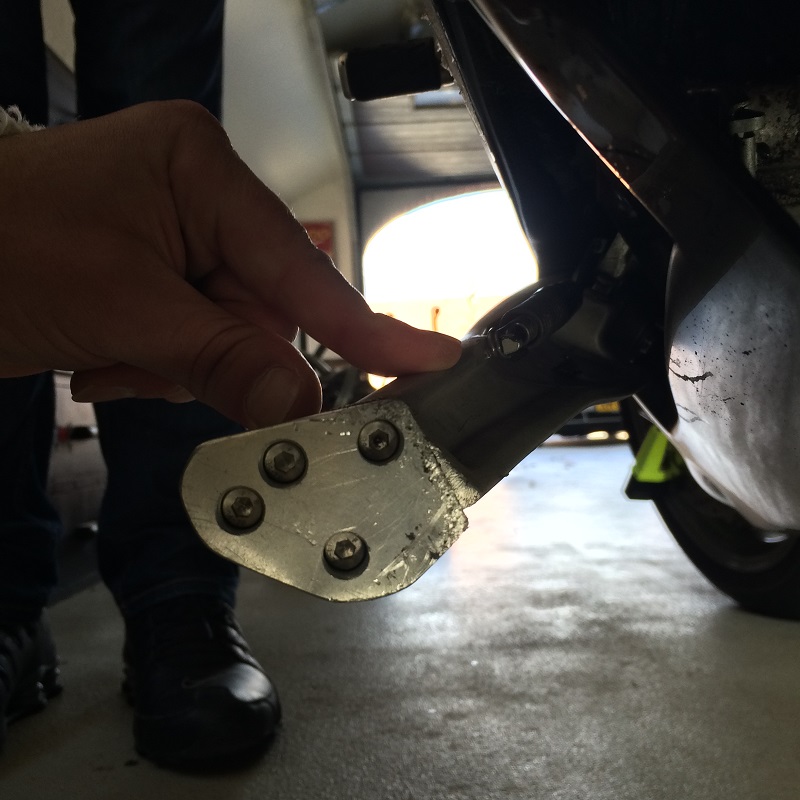

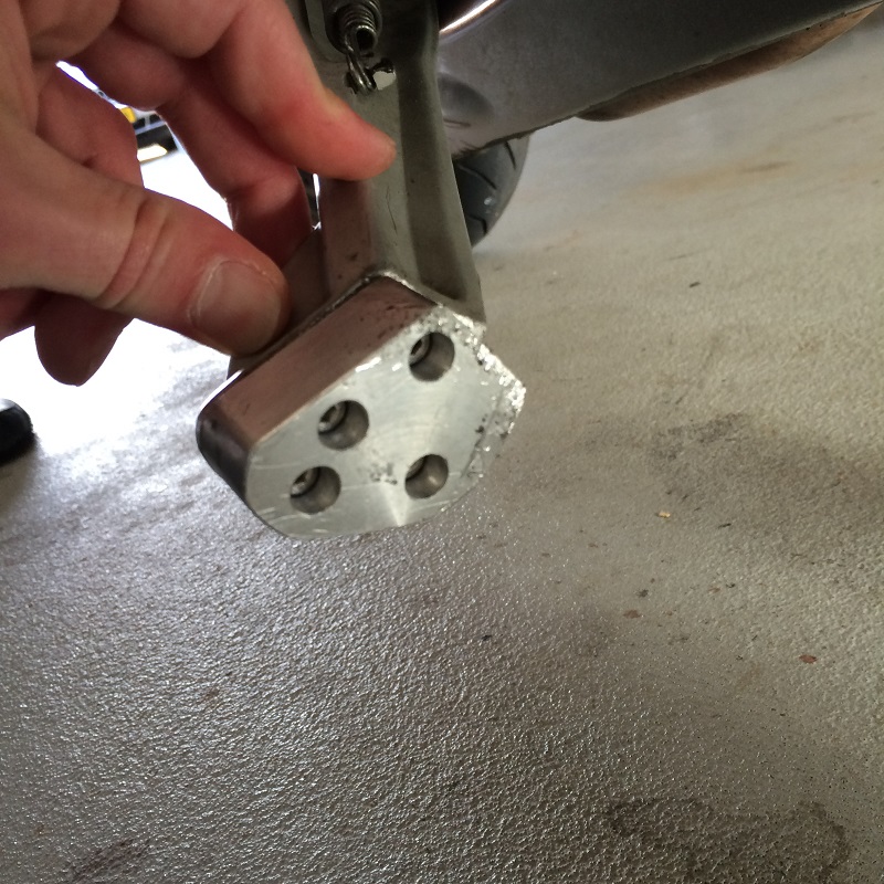

  17. A friend made this for me.
  18. Is he taking orders? :)
  19. Reminds me of Garry Glitter. That alone would stop me fitting it.
  20. I didn't fit it but mine has a very similar thing with a block of shaped black plastic glued to the bottom of the stand, works a treat.
