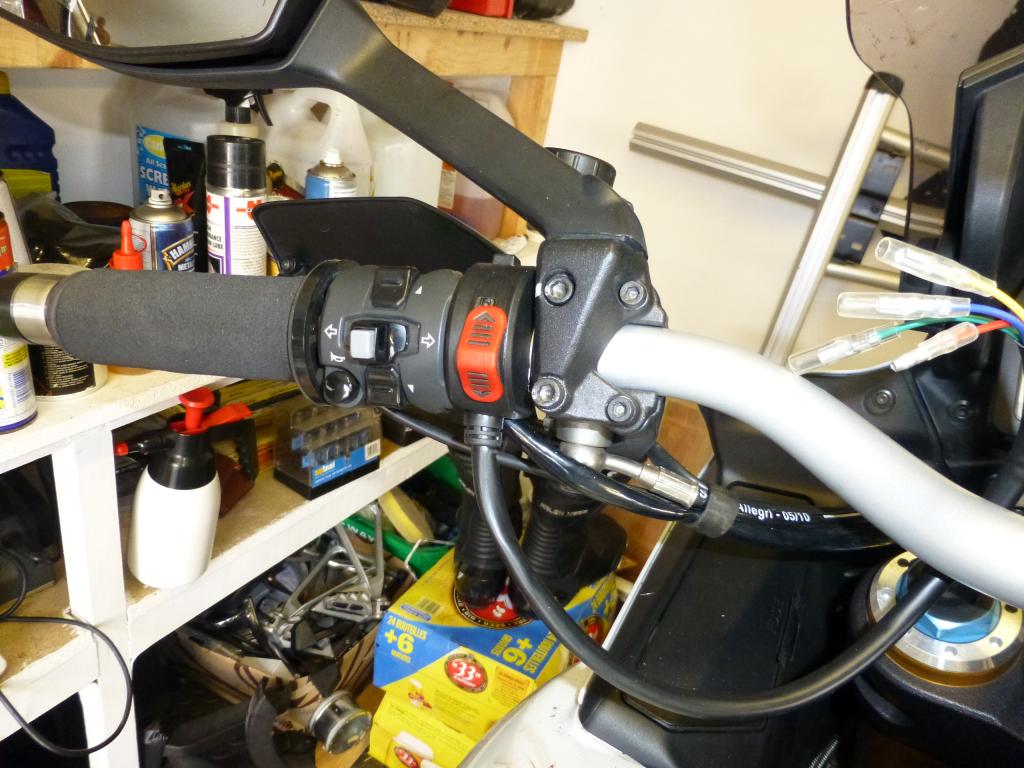

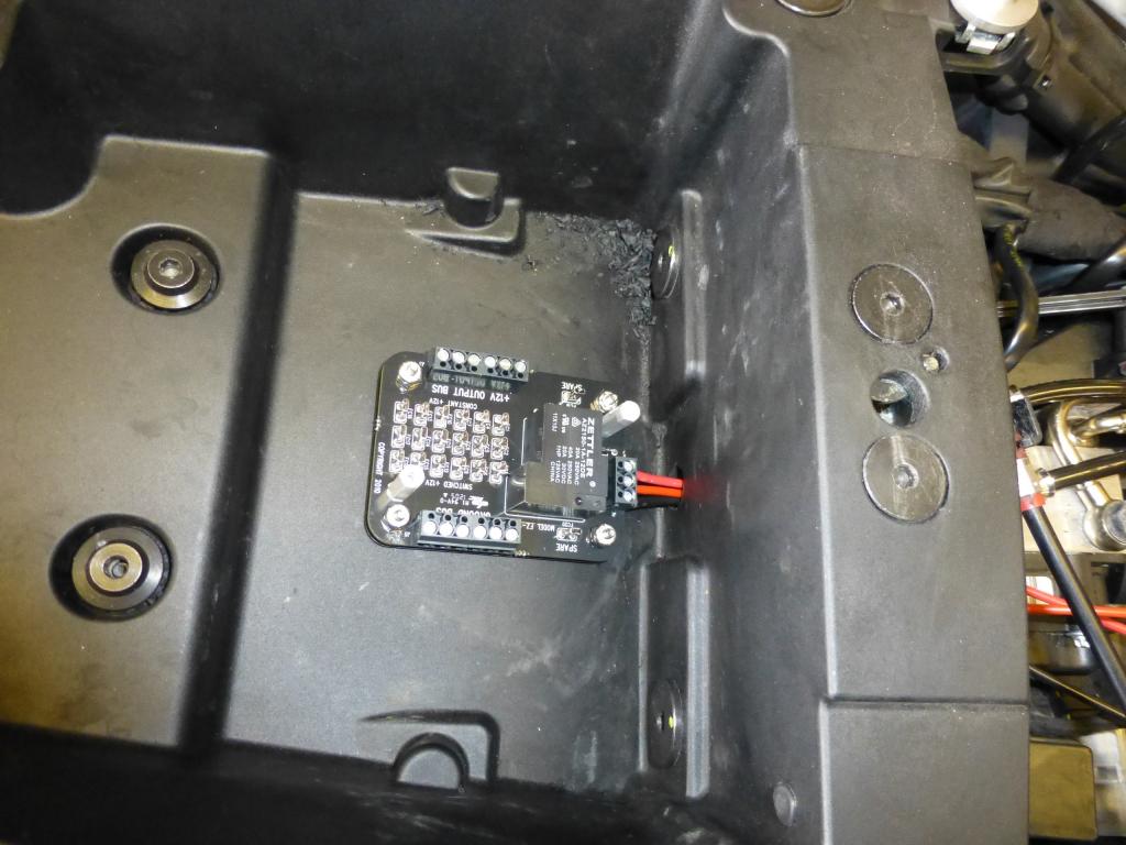

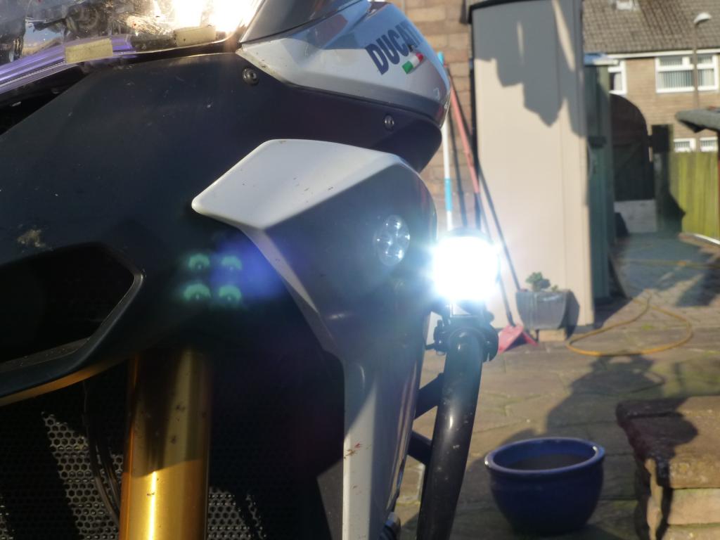

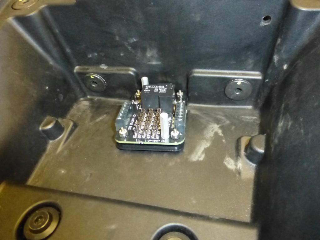

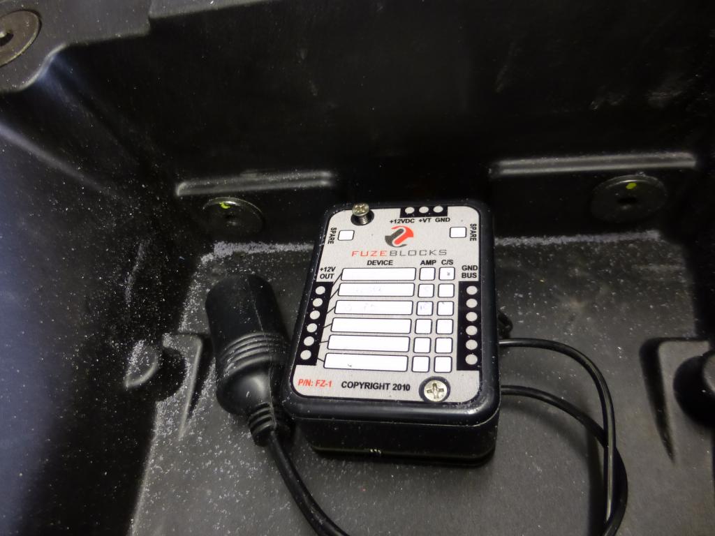

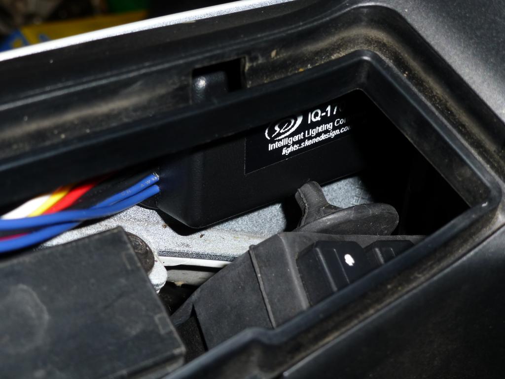

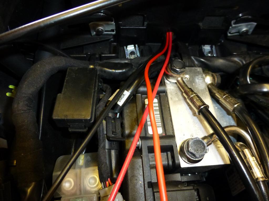

  6. I have. Bought them from E Bay. I also fitted a FuzeBlock power supply unit and ran it all through a Skene IQ 170 controller. Took a day or two to fit but was worthwhile for peace of mind.
  7. Any pics?
  8. That's all I have. All wiring was loomed correctly and I made a Perspex panel to cover the fuseblock. I also added a cigarette lighter socket and a Hella socket in the boot, both ignition switched, so I can charge my phone on the go.
  9. Thanks. Neat install, there's so little space to play with too makes finding a good spot tricky.
