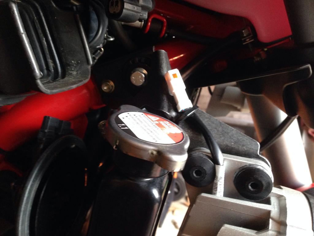

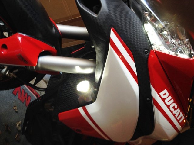

  1. Just fitted the Ducati led lights to the PP and didn't take as long as expected, only problem is that stupid bloody rubber grommet that keeps the beak on under the oil cooler.
    Must have taken at least 12 attempts to get it to stay on. Anyhoo all good to go now :biggrin:

  2. Thanks Jim.....can you strip the plastics again now please, I'd like to see the mounting points and the brackets :tongue:

  3. Thought someone would ask so here's one I took earlier
  4. I'm guessing there's threaded lugs on the frame that are not present pre 2013 bikes?....just curious.
  5. Hi Andy,
    Yeah the light brackets slide over the radiator mount once loosened n then you bolt it together using the original radiator bolt plus a second one in the kit. It's fairly solid, the fitting instructions say to remove tank etc but I left it on n just used a straightened wire coat hanger to pull the left light cable thru the frame n cable tied the right side to the frame.
  6. Those are the Ducati performance ones aren't they? I have them on mine, people will certainly notice you more now
  7. Hi Satzoomer, yeah they are the Duc ones. They were bright enough in the daylight so must be blinding at night.

  10. Something that I have been curious about as well. So today I compared the radiator brackets on a 13` GT and a 12`MTS S. The bracket it self have the same size, but the 13` one have, as you say, an extra nut welded in. But the hole is there on the 12` frame. So with a washer and nut, there is no problem mounting the DP-LED extra lights on the 10-12` bikes. The electric connection is done with a "T" splitter on the GPS power socket.

  11. Hi Andreas,
    The kit I have for my 13 plate came with 2 additional nuts n washers which look like the ones in ur pictures so guess the lights will fit most models.
  12. Jim my bikes a 62 plate pre skyhook and
    They fitted straight on with just the one nut, I believe there was an amendment in the instructions for the later model, I think it would be a nightmare to get a nut n bolt in there and 100% sure it's one kit for both models

    Yeah you are probably right, did your left hand light bracket (looking from the seat) touch the oil cooler braided hoses, mine nearly did but wrapped them in neoprene n cable tied them to try n stop the lines running just to be on the safe side.
    ran the bike out in the dark just to see what they are like....lit everything up, lovely jubbly.
