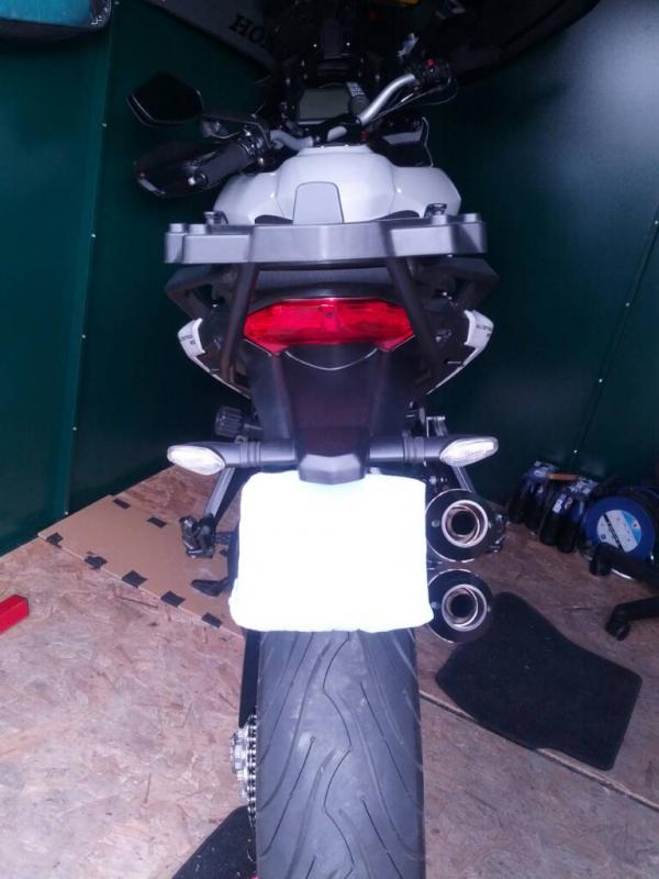

  7. Just ordered the Ducati LED indicators with the part no's mentioned in the link - just over £52 for the pair - thought that was cheap...
  8. Just fitted the new rear LED indicators - work fine and look great - very pleased :)
  9. That was quick delivery Bob, mine are on the way from the factory!......apparently :wink:
    glad they look good.
  10. Photos Bob?
  11. I'll take some photos soon! Ordered them on Saturday arrived today!! :eek::eek:
  12. Here you go - it is a smallish plate so you'll have to take that into account....
    #14 Bob_Cooper, Apr 23, 2013
  13. By the way the new LED indicators are sealed units so when and if they fail they'll need replacing....
  14. Turns out UK panigale use LED all the ones in my dealers showrooms were. £52 for the pair picking up at weekend. Nice little OEM mod.
  15. Yes, that was what I paid
