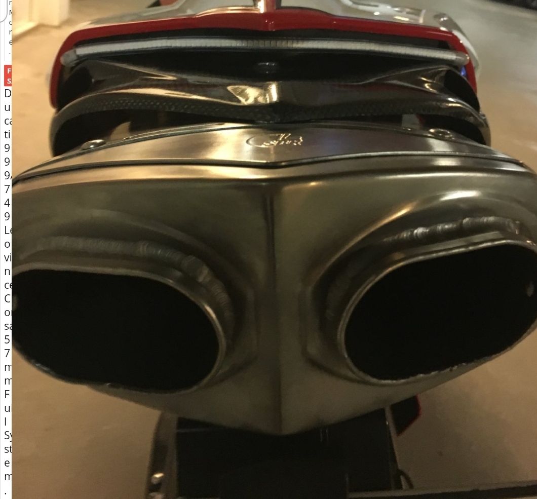

  3. Mines a mk1 749 Screenshot_20200108-063048_Edge.jpg looks like that one, not my bike but same can you can see the difference in outlet sizes? Just wondered why?

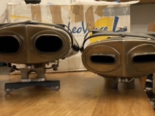

  4. The difference in outlets is that one is for street use and one is for track use (corsa) (see attached).

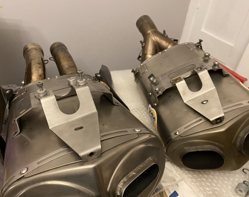

    There can also be a difference in the inlet too. Either the 2-1-2 set up or the asymmetric two pipe set up which is the one on eBay. I assume all 2-1-2 are aftermarket 57mm where as the asymmetric is 54mm and standard with the bike but I’m not 100%. I think the Termi’s have the same options, slip on asymmetric or 2-1-2 full system.
  5. Asymmetric vs 2-1-2 system
  6. Back to original query, as it’s a slip on then there’s a chance your 749 exhaust could fit a 999 if it has the same swing arm (black or grey).
    I believe (more than happy to be corrected) that the full system is the same on the 749, 749S and 999 and that the 749R, 999S and 999R have a slightly different header to address the deep sump. The route of the rear pipes is slightly different depending on which swing-arm you have. So a slip-on with decat pipe isn’t necessarily straight forward.
  7. Ah ok, ones race ones road makes sense, I have the race can then, it does not say on it "track only" so all good for the mot, well so far, I got a local exhaust shop to make some baffles up for me, they seem to work fine.
