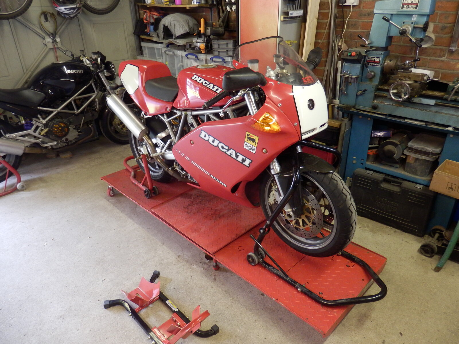

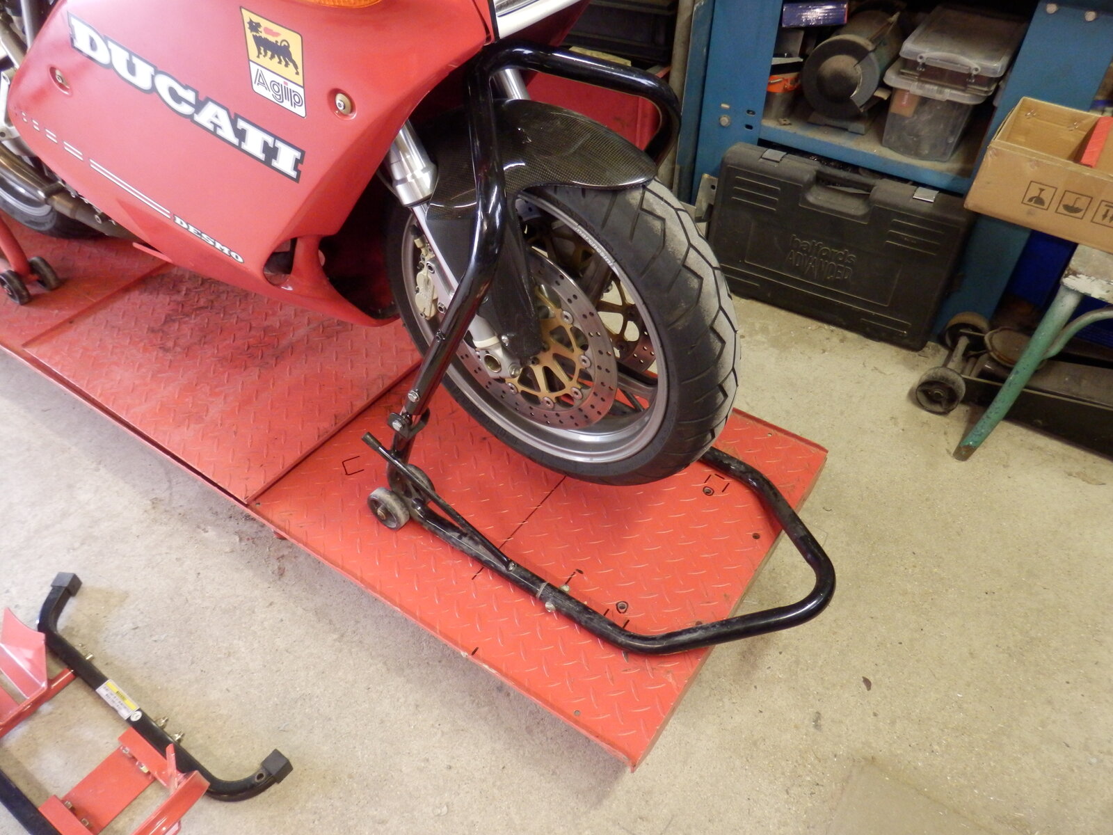

  1. My lift table is one of the best tools I've ever purchased and I really don't know how I did without it before, but it has one annoyance.

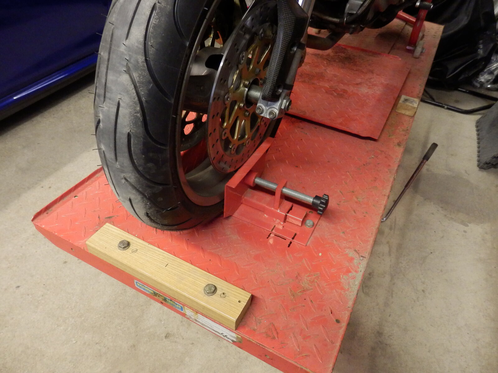

    The wheel chock is this style:

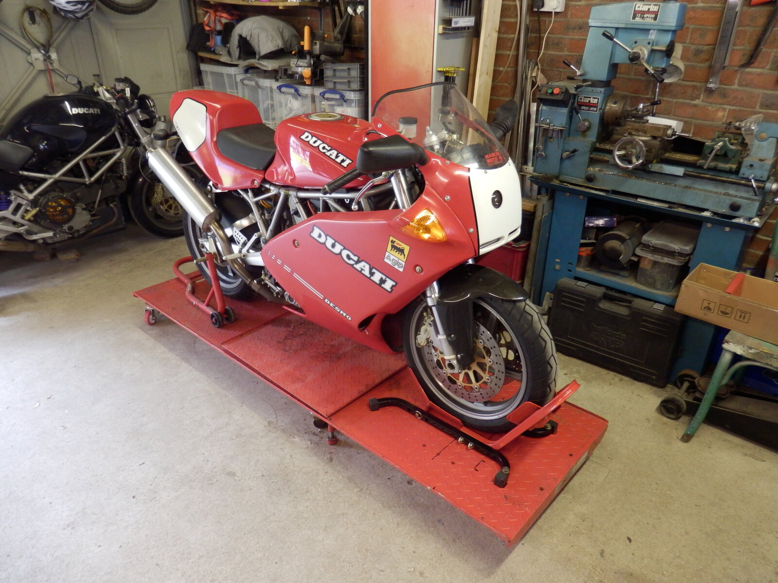

    So I open it right out, wheel the bike on and put it on it's side stand.
    Then I put the bike on a rear paddock stand to get it upright, clamp up the front wheel and strap the bike down when I think I need to.
    But then if I want to lift the front end neither of my front stands which fit under the headstock will work with the front chock in place as it's too wide.
    So I have to loosen it off, unbolt it, and slide it out from under the wheel before using a front stand.
    Does anyone use any other type of chock or clamp that allows a front stand to get in there?
    Ideally I'd like to roll the bike into a front wheel chock without using the sidestand etc.

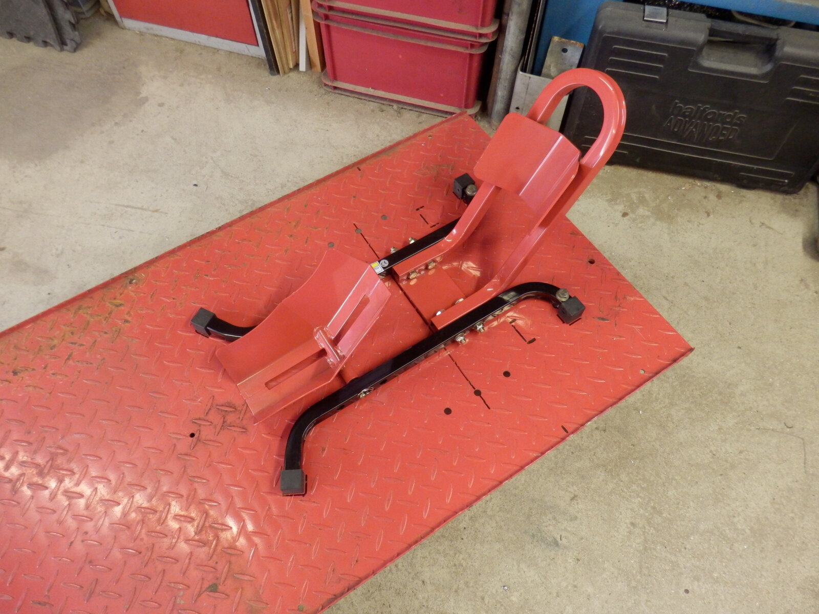

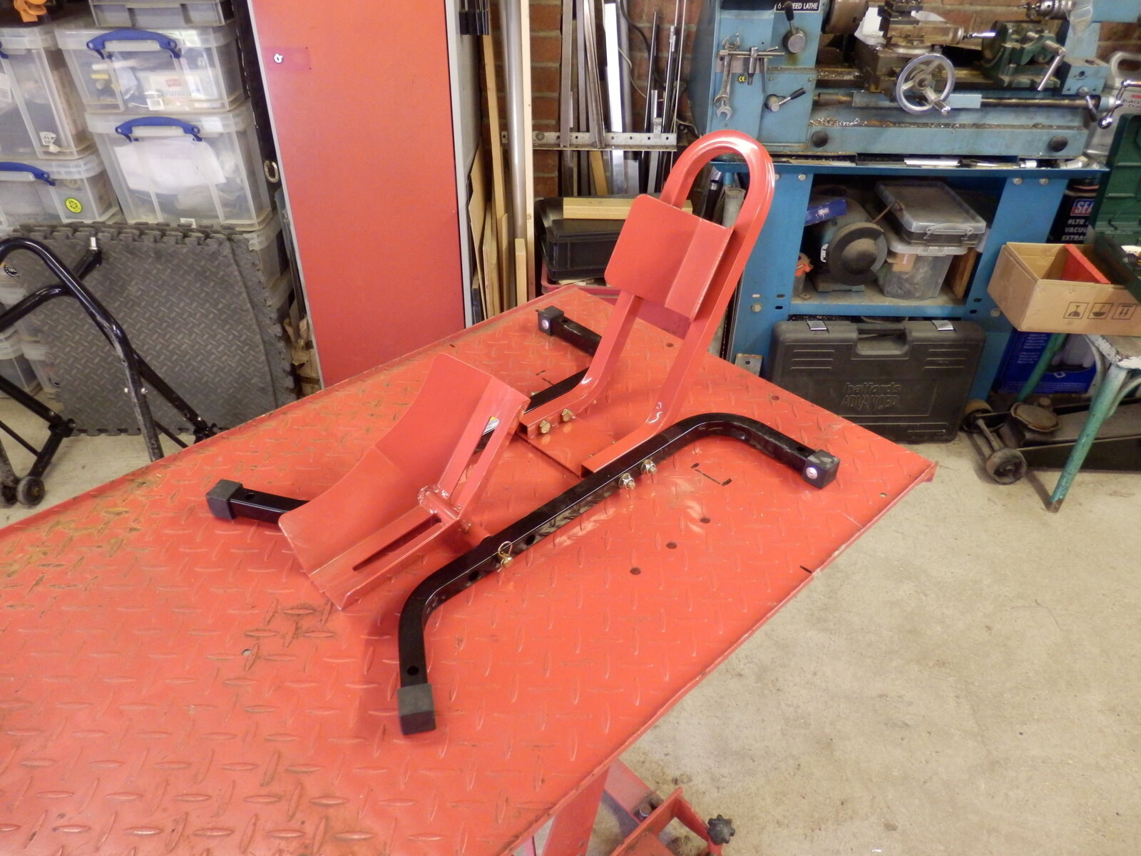

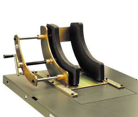

    These types WON'T work as again they are too wide:

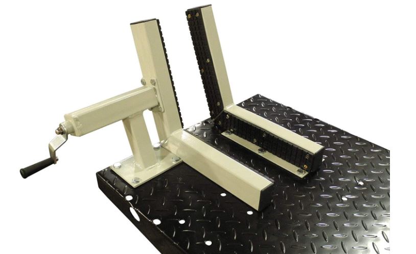

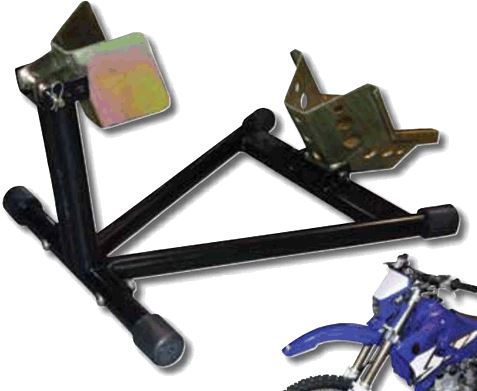

    So I'm wondering if anyone uses anything like these:
    But of course I do want to be able to get a front stand in and lift the front wheel up.
    I don't mind unbolting the chock and removing it if needed after the wheel is lifted, as that will be a lot easier than what I'm doing at the moment.

    You can see my little block of wood in the first two images which I use for that exact purpose.
    It does make it a lot easier.

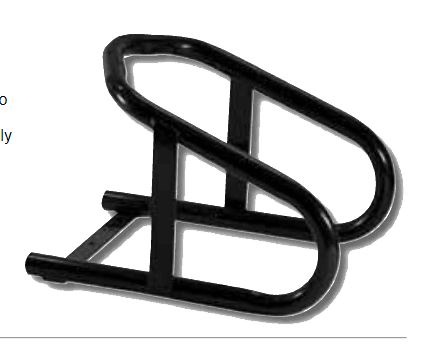

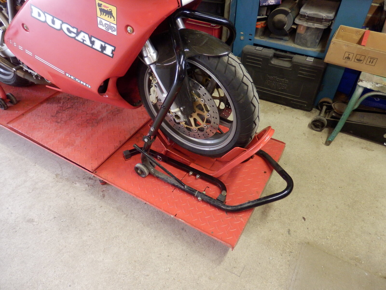

  8. Just to update this thread on what I've done to make my life easier when getting bikes on the workbench.
    I brought one of these from Ebay:
    Which is great.

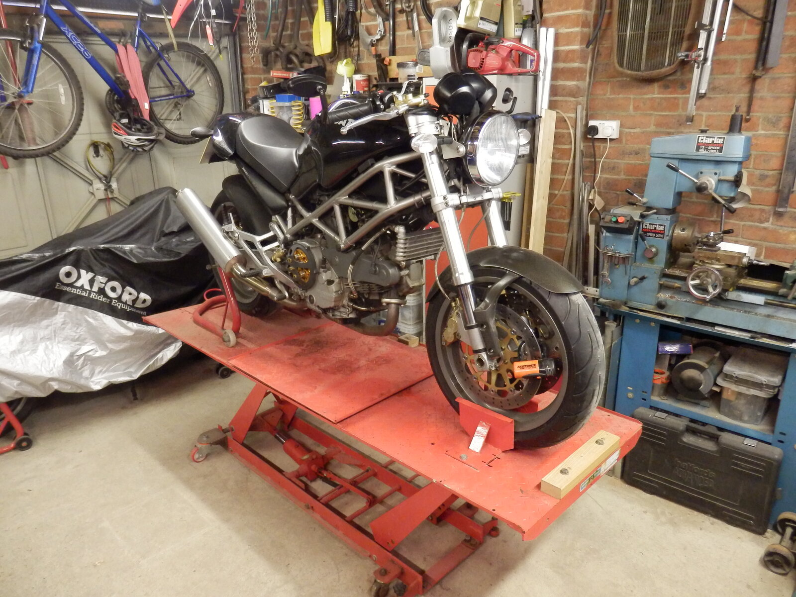

    On the bench or on the garage floor I can just roll the front wheel into it and the bike is held (reasonably) securely in an upright position with no mucking about with the sidestand and lumps of wood.
    I wouldn't want to work on it like that, but it's held firmly enough for me to get a paddock stand under the swingarm.

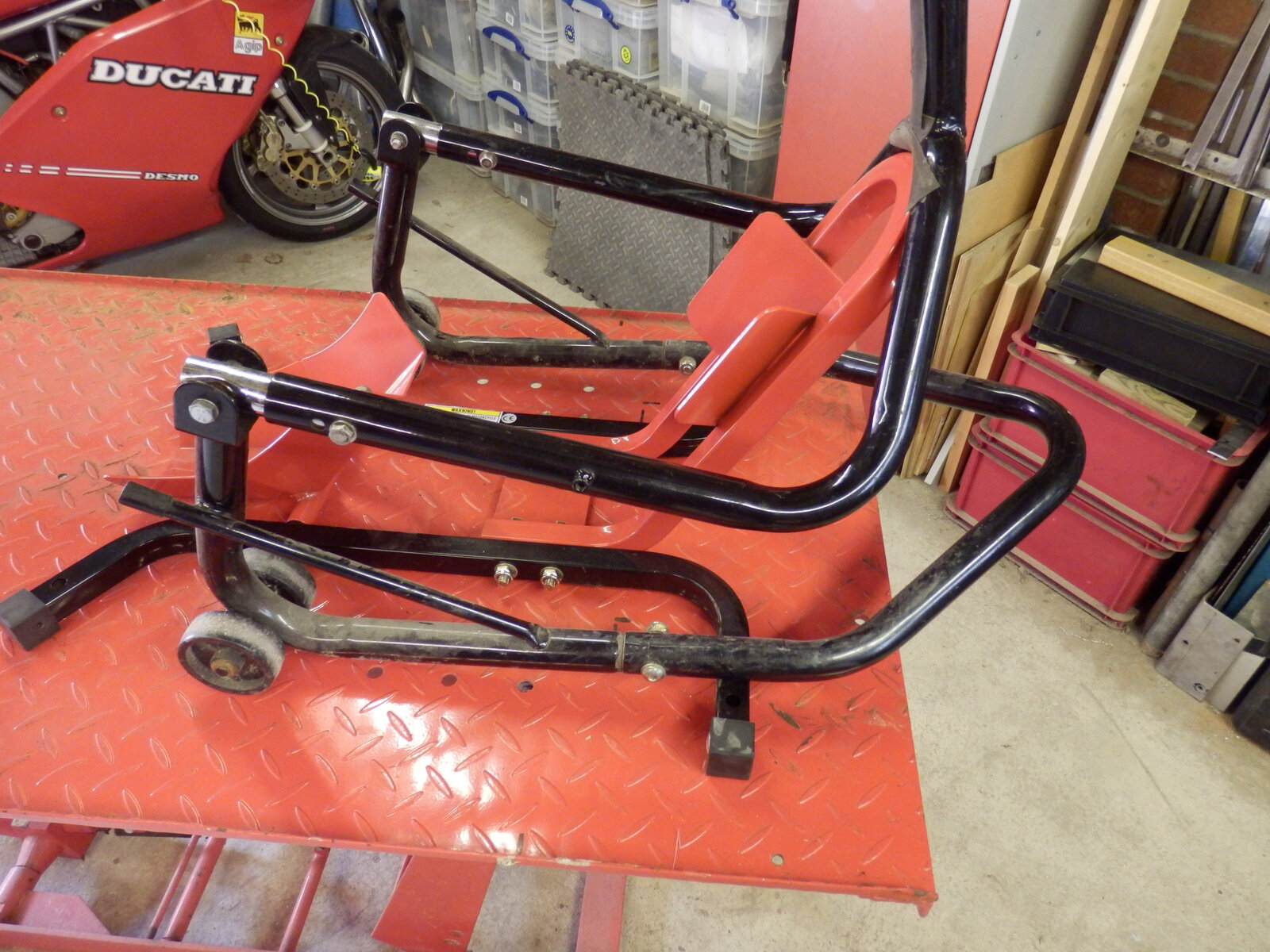

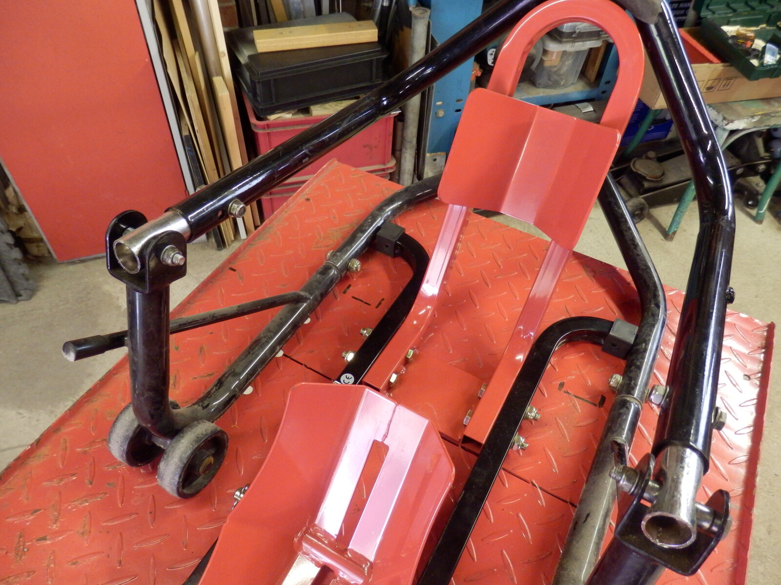

    Unfortunately though, the legs are too wide to be able to then get the front wheel off the ground with a front paddock stand:
    So the legs got made narrower to fit:
    And the stand bolted down:
    So now if I want to get the front wheel out I get the bike on the lift using the chock and paddock stand:
    Lift it with the paddock stand:
    Then unbolt the chock, remove the pin for the 'seesaw' bit, and wiggle it out:
    Then of course reverse the process when finished.
    Nasher.
