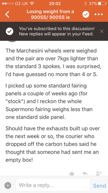

  3. Here you go. He claims 7kg saving between early 3 spoke and IE 5 spoke rims [​IMG]

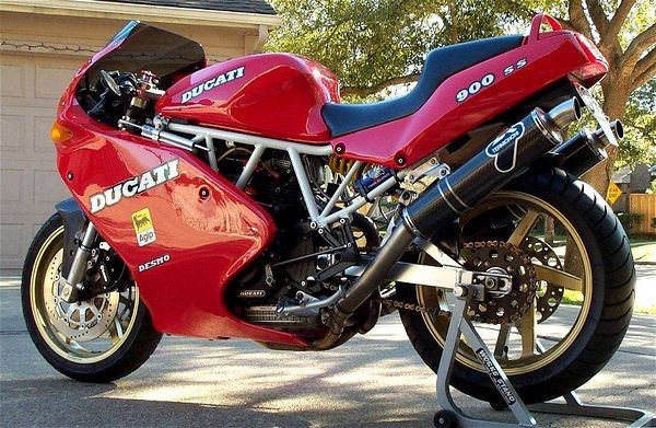

  8. [​IMG]
  9. Confess I don't know if these are the alloy or magnesium versions but I think the cast is identical. Anyway, close enough to to give an impression about the look.

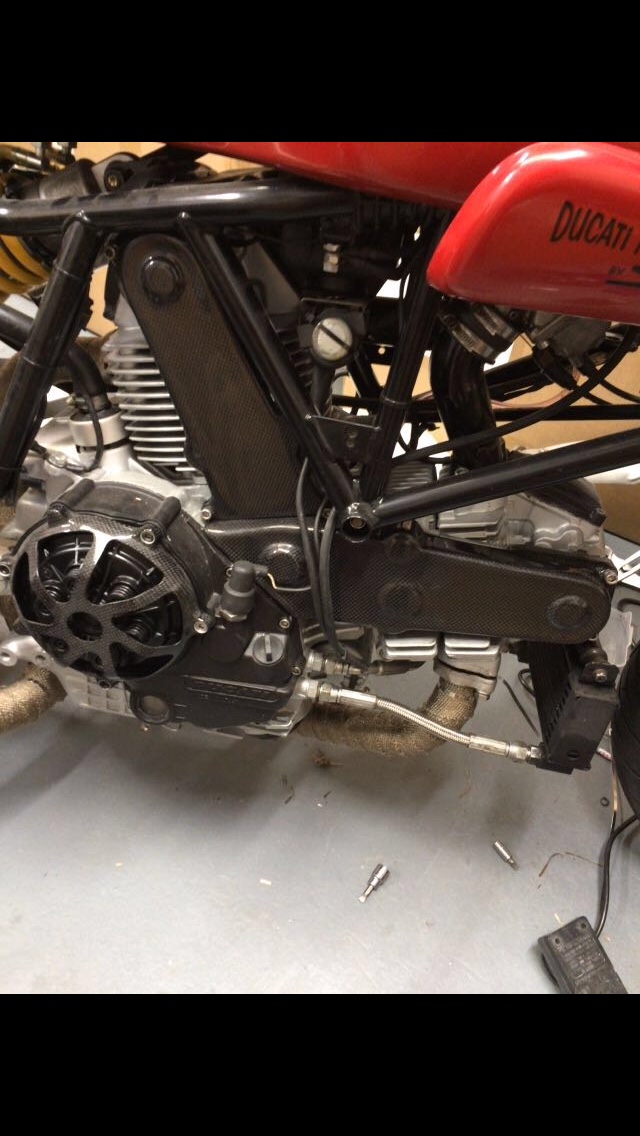

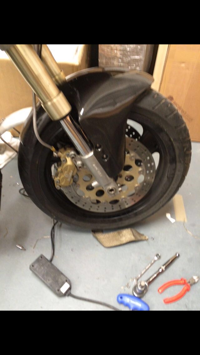

  13. Been dressing the carby in carbon today. It still has the shitty old Brembos on it![​IMG][​IMG]

    How has the exhaust wrap worked out? had toyed with the idea on mine.
