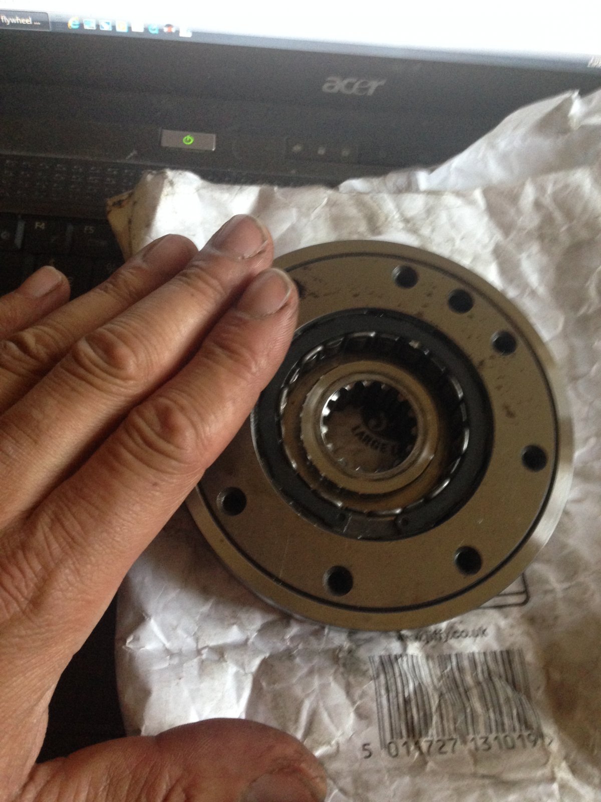

  1. IMG_2219.JPG just machined my flywheel down to 1.5 kg for what you see now. It was 2.488 before. I believe you can go down to 1, but not sure whether that's with the internals removed. Im happy to leave mine as is, if i havent knackered it.??

  4. That'll spin up lovely that will, providing you've left the pick ups in place or the only spinning it'll be doing is from the starter motor.
    I've seen 996RS ones down in the hundreds of grammes. But they don't like ticking over with that little mass.
    Good job.
  5. I dont think that flywheel is part of a twin pickup system
  6. Well that's ok then :Facepalm:. I wasn't aware of so many differences until I started buy bits myself, to find they didn't fit, or needed modifying, or, worse of all, needed another 6 different parts to enable fitment.
  7. When i do them i turn the outer ring further down so that it is removed. (Looks like you have about 4mm left)

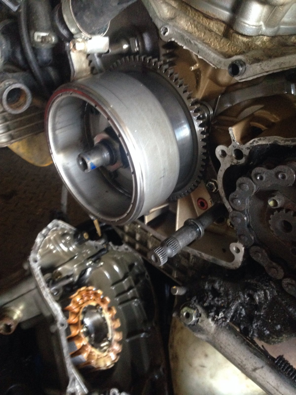

  11. image.jpg On.!! Impeller arriving tomorrow
  12. hows the balance..........
  13. Didn't bother to balance it as I only took material from the circumference, uniformly. When speaking to FE about his approach, he said that he used to have them checked, but the deflection was negligible.
