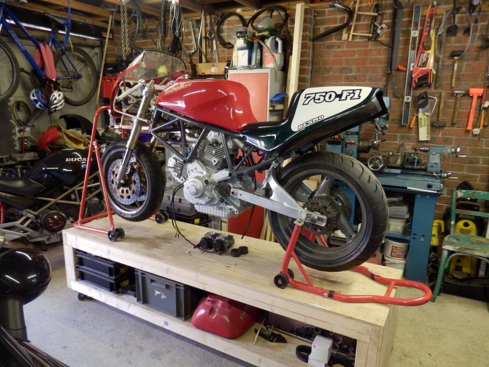

  1. I'm looking to fit some lightweight wheels on a carby 900ss I've just bought, has anyone done this? I'm guessing a set of Marchesinis from a fuel injected model would be the obvious choice but is there anything else out there I should consider? Thanks
  2. ..obvious choice, but axel diameters are different. (obviously not insurmountable)
  3. I've got a pair of ST2 wheels that I machined and changed the bearings in to fit my Carbie 900.
    Although you still need to reduce the width of the speedo drive.
    I believe I also still have the sprocket carrier I machined to get some extra width out of the rear wheel assembly.
    They are not that much lighter than the stock Carbie ones, but I wouldn't want a huge amount of money for them.
    I'll try to have a look in my storage container over the weekend.
    I might even find the speedo drive that I skimmed in my lathe to suit.
    These:

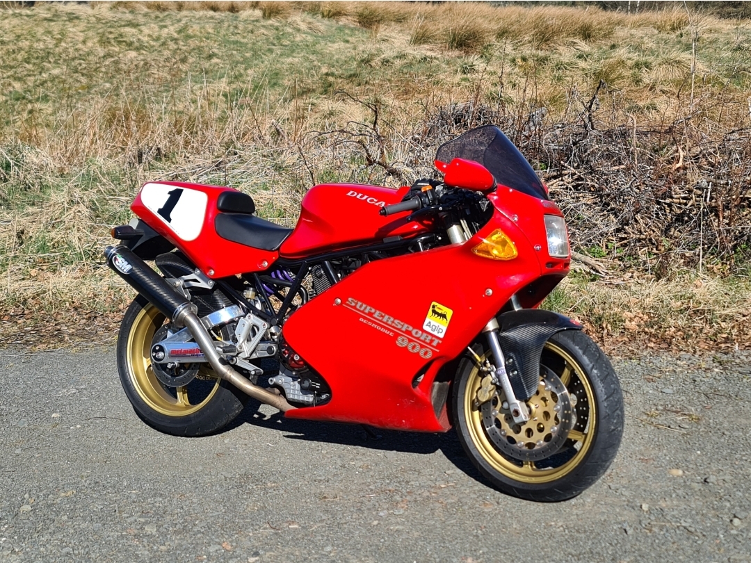

  9. Seen this thread late, I posted here a while ago about mine, Oz Piegas which required a spindle change on the front, easy to do from the later SS. I looked at loads of options, but went for these. A lot of money but no regrets, instantly noticed difference. Screenshot_20210605-192752_Gallery.jpg
