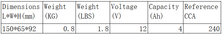

  14. The OEM battery fitted to my Panigale R is an: HJT7B-FPZ-SC, there appears to have been 3 versions of the Ducati part # 39540411 /C, /D & /E, since 2016. I recently purchased a Ducati boxed /D version, which cost ~£180 delivered.
    Links to the Details of the OEM battery are:
    https://www.skyrichbattery.com/p9/Frequently-Asked-Questions/pages.html .
    https://www.skyrichbattery.com/product_info.php?products_id=594 .
    http://www.skyrichpower.com/pro.asp?id=66&g=en .
    The details from the table in link # 3 are in the table below, which states it has a 4Ah capacity, and a CCA of 240A.
