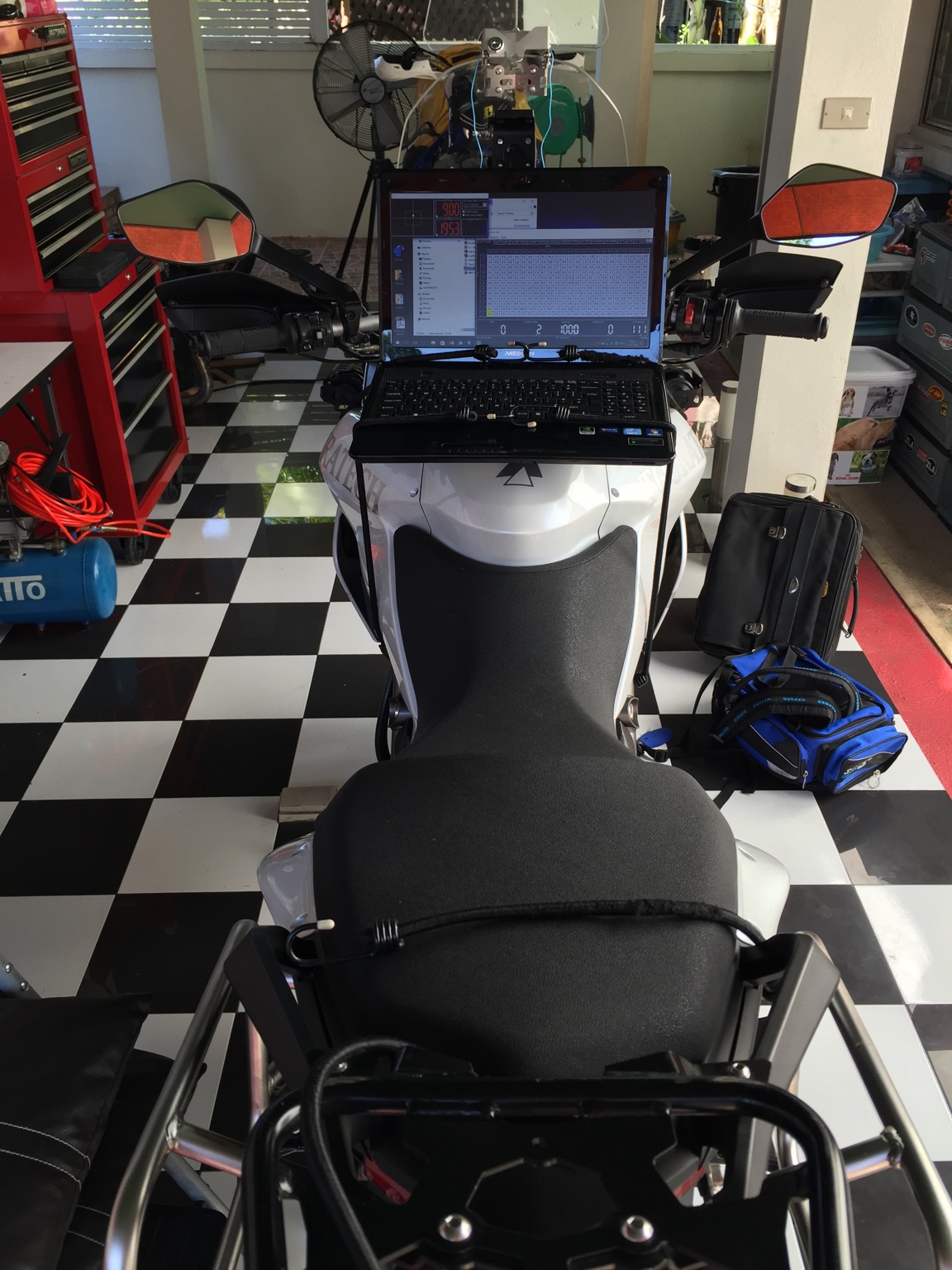

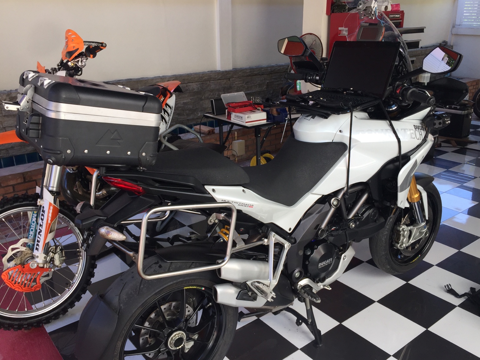

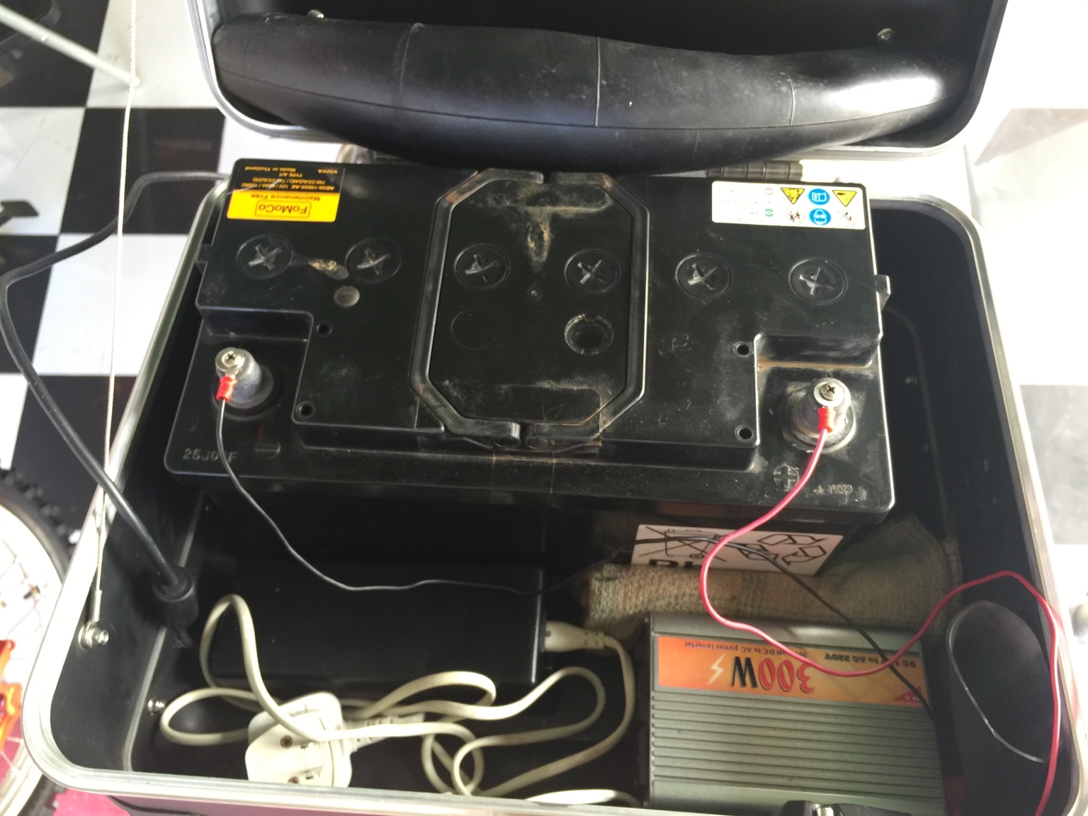

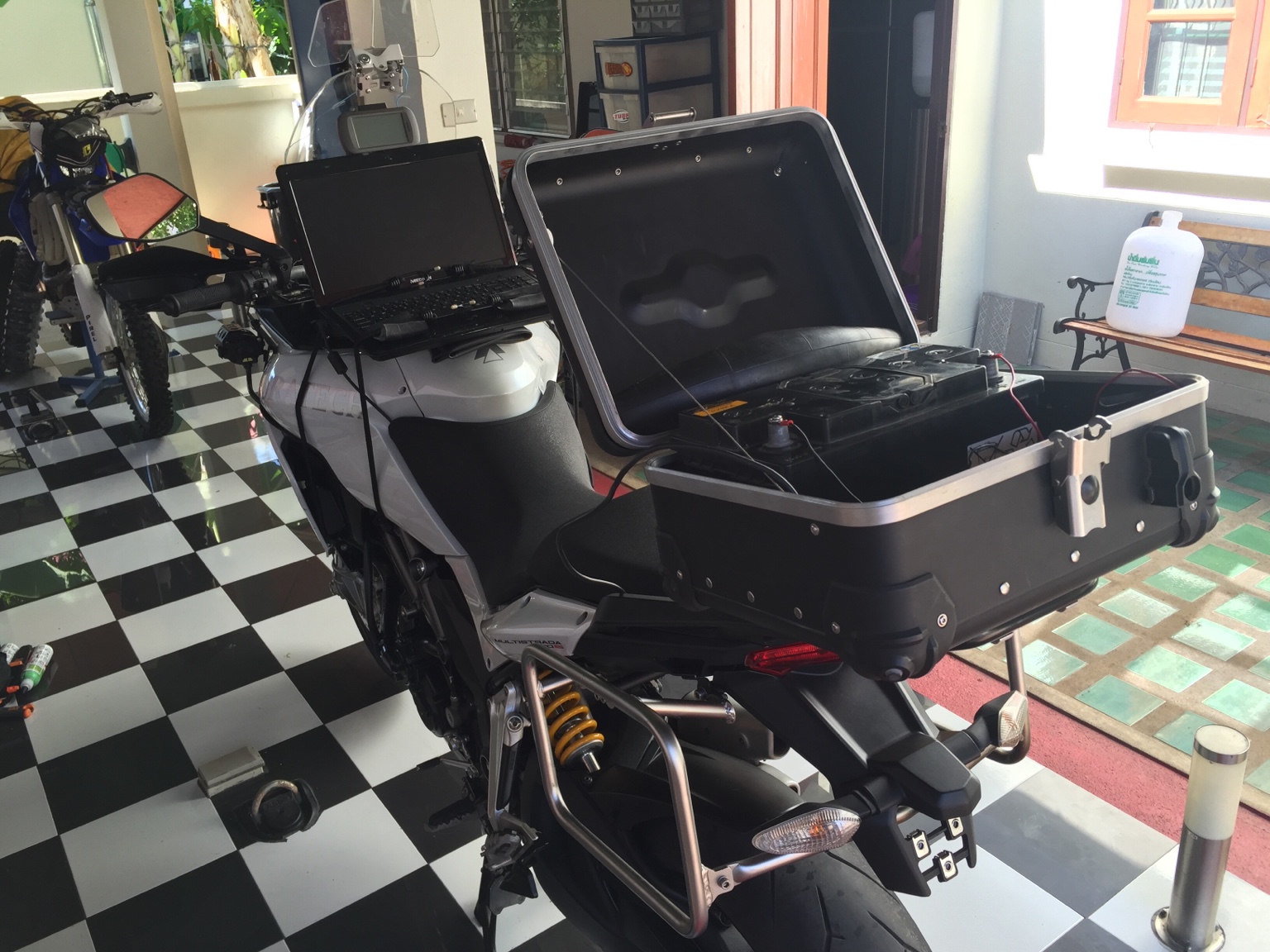

  12. My mobile Dyno setup....(couldn't find a bigger laptop!)

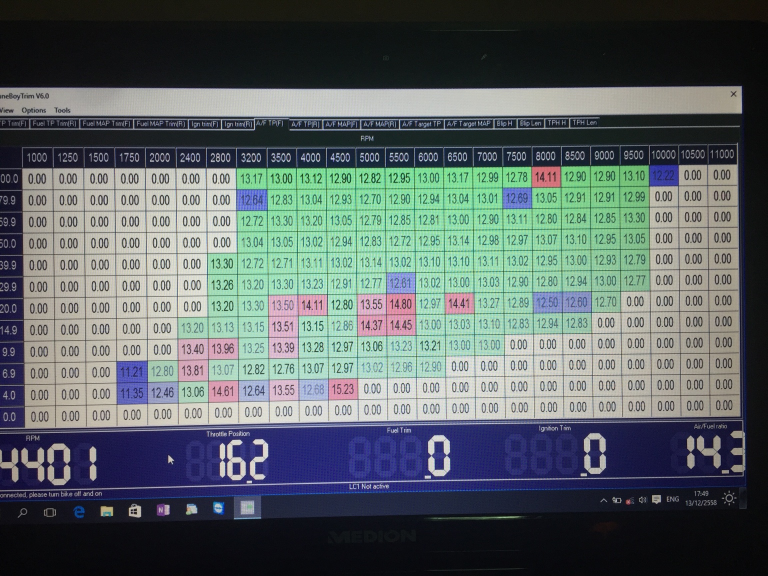

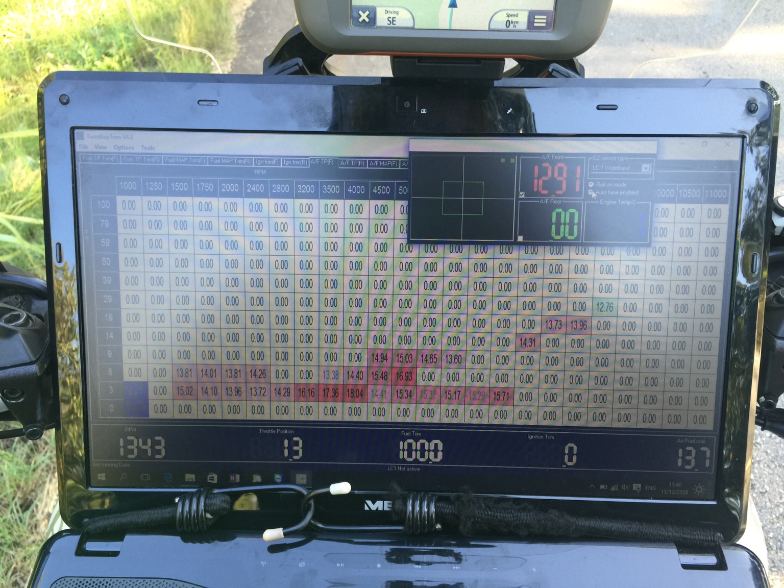

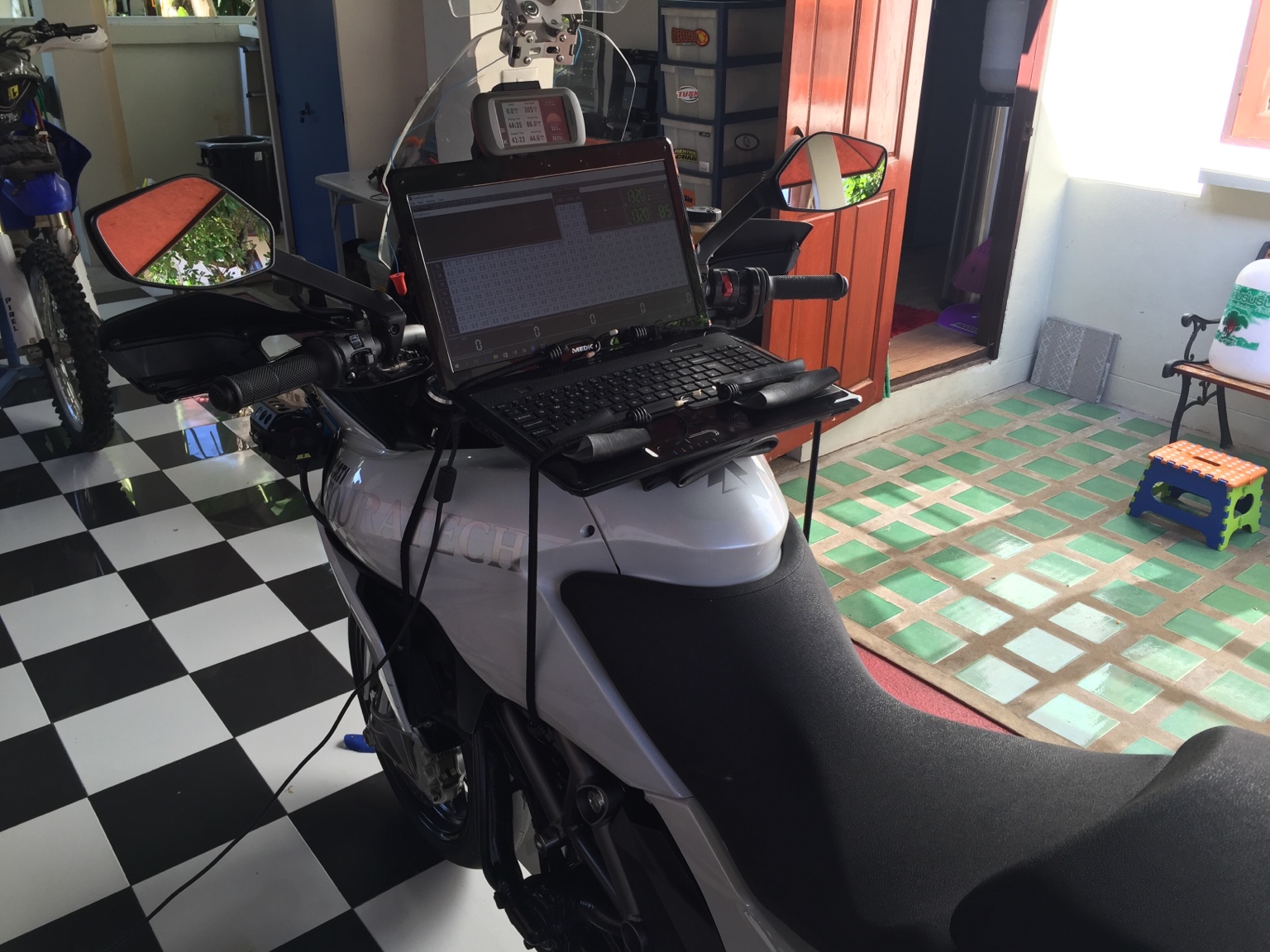

  13. So I got out with the laptop strapped to the tank for a couple of hours. With the target screen open and roll on selected I proceeded to accelerate in first gear slowly through the rpm range. I can see the white dot passing through the box and cells being populated in the fuel table. It's not a text book as some of the Dyno videos but it seems to be working.
    Doing the same with different gears I start to collect a fair bit of a/f results. Not really sure what I'm suppose to do exactly in roll on mode. The a/f table doesn't seem to be updating (greying out) so I stopped and selected auto tune also. I still don't think it was updating so I occasionally stopped after some runs and highlighted the bold figures and hit key 'C' to correct the fuel table manually, the figures now become greyed out. Now I start feeling a difference in the fuelling the bike is definitely becoming smoother and it is quite noticeable. So just working with different gears and going through the rpm range, stopping and manually correcting the table with key 'C' seems to be doing the trick.
    I also start logging, bit late but anyway........ Hour or so later laptop battery dies and I start heading home. The bike feels great and I start wondering what it's going to be like after the second cylinder is tuned.
    Now I think I made a mistake with the saving file, infact I didn't as the battery on the laptop just ran out. I thought after pressing 'c' the table was updated and the ECU automatically, not so. After I got home and shut the bike off I plugged the laptop back into a power source put the ignition on, pulled the trim file from the ECU and compared it to the termi slip on trim I had been using. Unfortunately it was the same so I hadn't saved the corrections into the ECU. Lesson learnt and will make sure I run the log from the start and try flash the table with the corrections before the battery runs out.
    Next ride I'm not going to use roll on or auto tune. I will just try and populate the tables using each gear through the rpm range, stop and manually correct the trim table by highlighting the a/f captured bold numbers and hitting 'C'
    [​IMG][​IMG][​IMG]

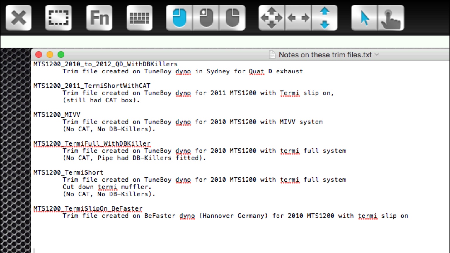

  17. There are 3 trim files provided that were tuned without the CAT fitted- Termi Full, Termi Short and MIVV. When you flash your ECU load all 3 of these trim files and go ride and test which one feels best. Note that these trim tables are to get you in the ballpark with your fuelling. It seems most are happy with whatever trim they felt made a difference and stuck with it however to get the full benefit install a wide band and fine tune the map to your own bike.
    A side note- I had the decat and MIVV system. I uploaded the trim file for the MIVV but couldn't get it to work so eventually after plenty head bashing I reverted back to the stock system.

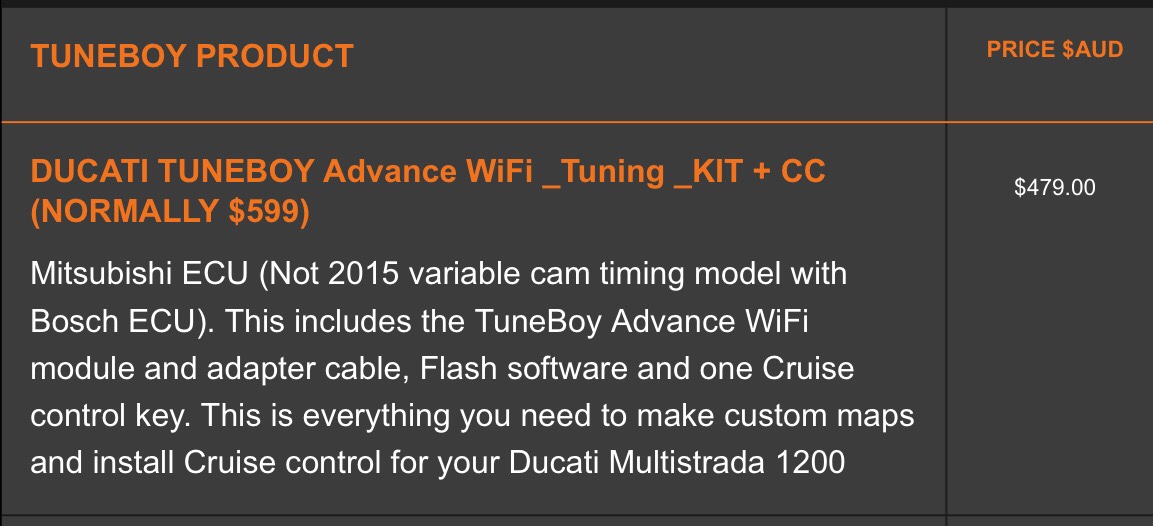

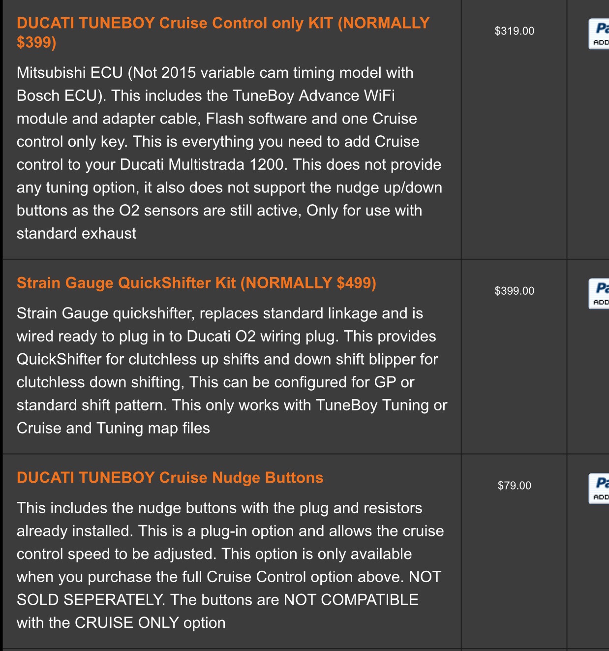

    You need the cruise control only kit (319AUS$) plus the additional nudge button (79AUS$).
    However you've thrown a spanner into the works by saying your going to decat your exhaust. I might be wrong but this could mess up your fuelling. For 479AUS$ you get the advance tuning kit plus the cruise control kit (not sure if the nudge buttons comes with this package, doesn't say).
    This option will also give you the option to reset your throttle position sensors electronically at the twist grip and at the throttle bodies. Something that normally requires doing if you mess about with your exhaust/air filter etc.
    You could chance just going with the first option for just under 400AUS$. Afterwards if you decat the bike and it runs like a bag of nails there is always the option to purchase the extra tuning key for 159AUS$.
    Agree there is too many options from Tuneboy and it becomes somewhat confusing. Their trying to milk the money out of us by tempting us with the various "add-ons". With the release of the new multi which includes cruise control (and quick shifter ?!?) as standard maybe time for Tuneboy to compact their options a little.
