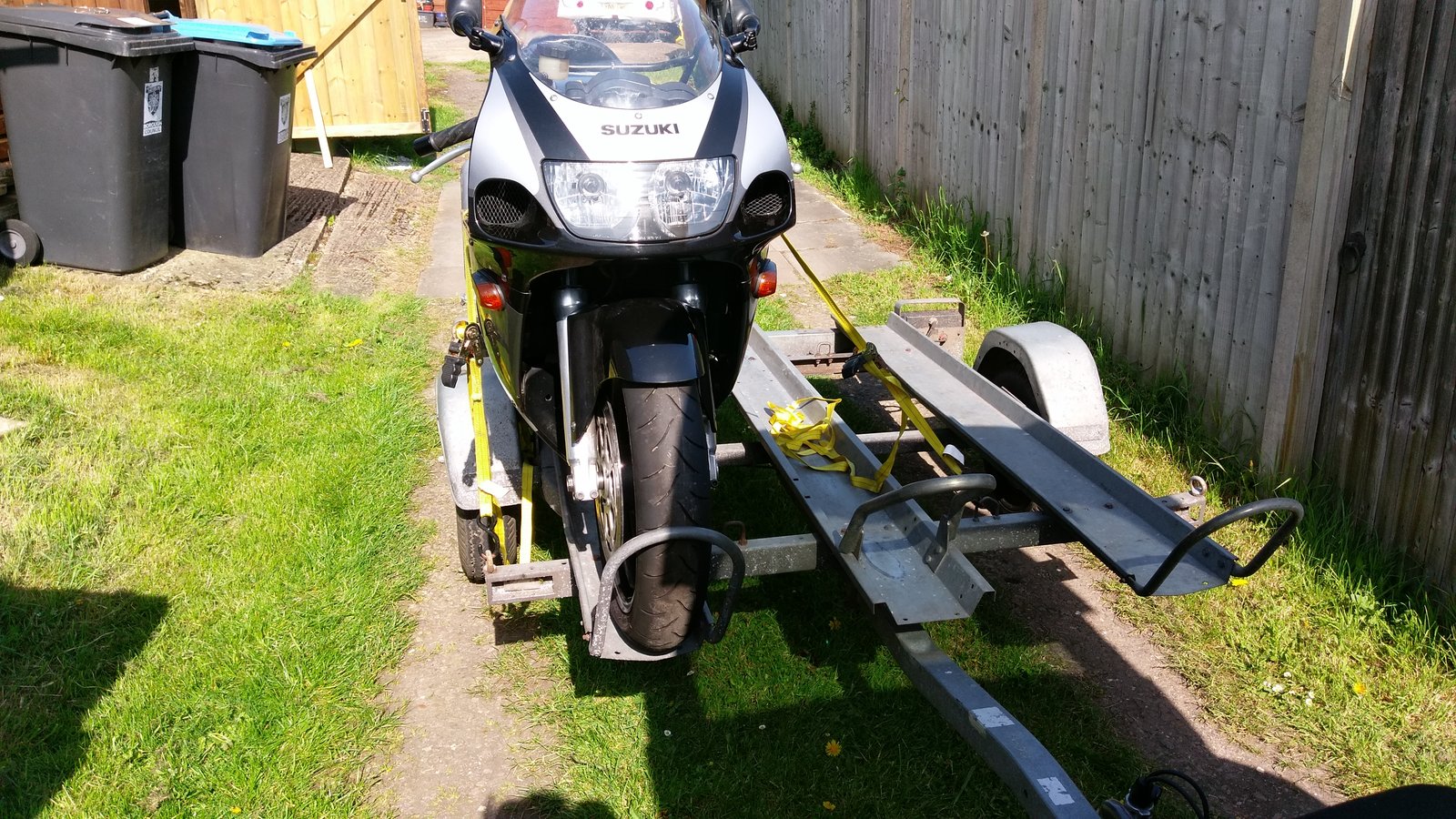

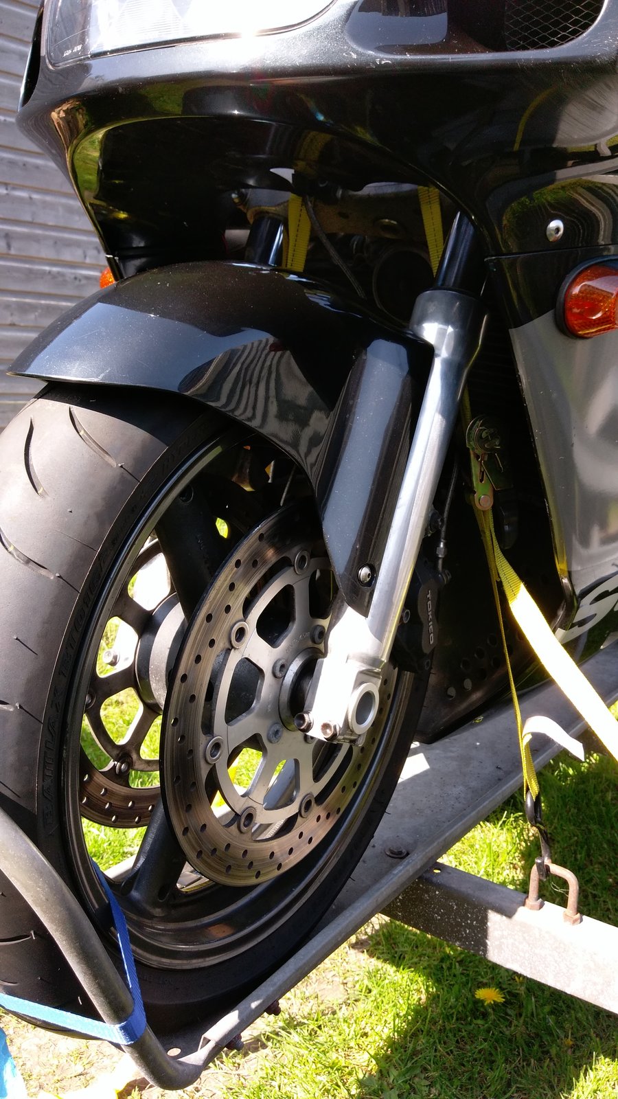

  1. Need to take 2 bikes to track soon, is this straping OK once I've done the rear similar? IMAG0135.jpg
  2. if it was mine i would have a small strap around the front wheel to the locator bracket:thinkingface:
  3. I've tended to zip tie the front brake lever on also
  4. Only one way to find out... worst case it's only a suzuki!!! Sorry....
  5. Those loose straps will get caught in the wheel :eyes:
  6. Apologies if this seems so obvious, check the trailers tyre pressures are correct. I've seen quite a few trailers have a lil wobble due to incorrect tyre pressures.
  7. Sounds like the voice of experience. ..
  8. I would extend the inboard straps to attach on the other side which would provide better triangulation.

  12. Both scare the bjesus Otta me... I've never used a bike trailer but have been to bed with a few pyscos..
