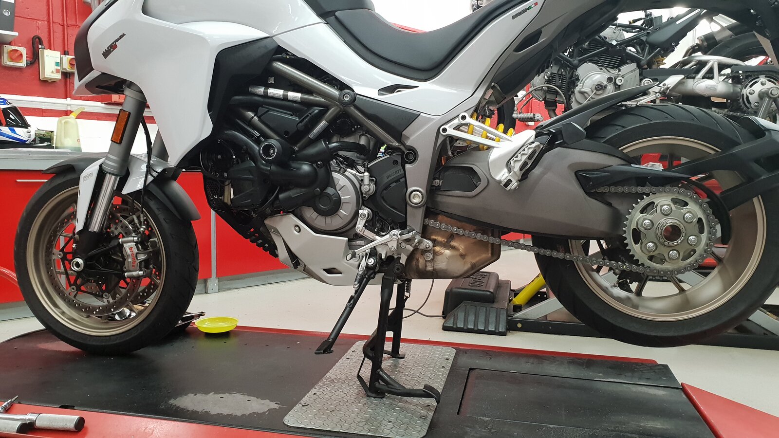

Reminds me of the centre stand conundrum on my brand new 1260 Multi... This was at the first service at JHP in Coventry. I'd bought the bike at DMC Stoke who'd created a 1260s Touring from a std 1260s as they didn't have a Touring in stock in white. Turns out they'd fitted a stand from the Enduro. At the time I had a gravel drive so it worked OK... though not particularly impressive ground clearance. DMC sent me a new centre stand to fit myself as I wasn't prepared to ride up there to have it fitted. They got a fairly chamfered one back. Are you sure they're not Enduro forks?
