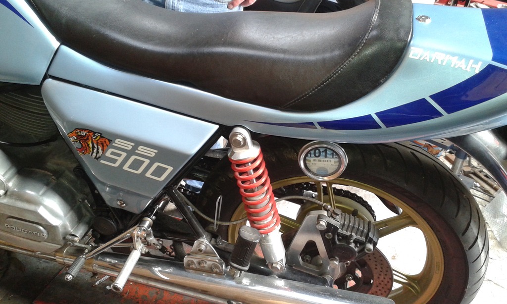

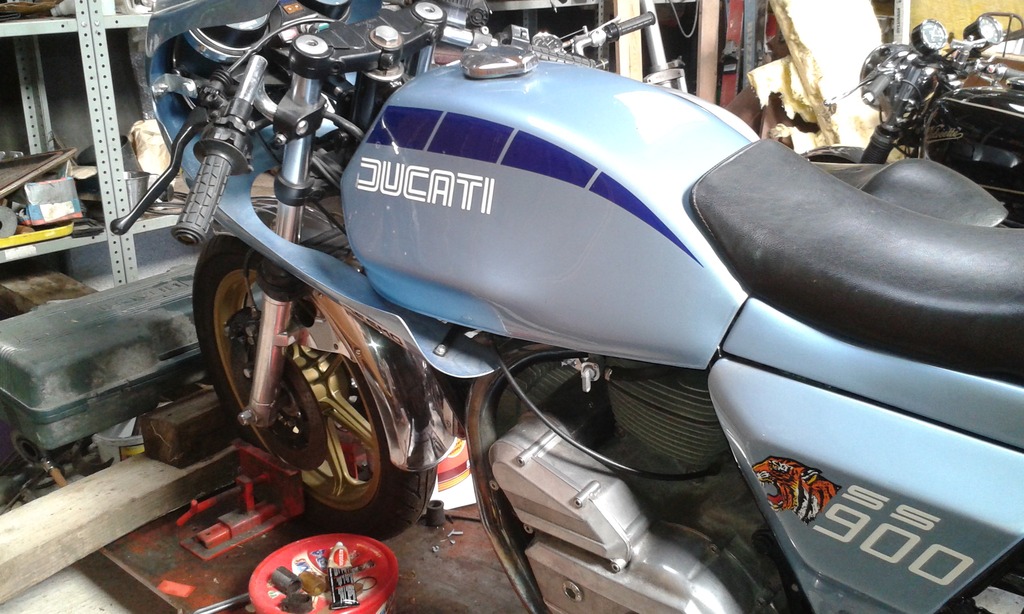

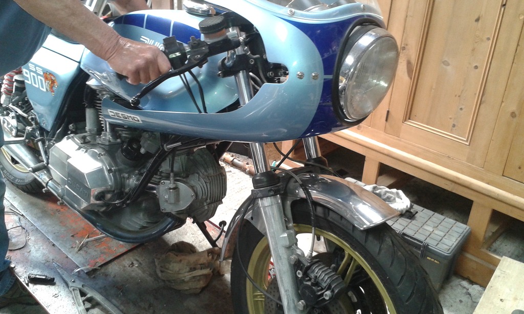

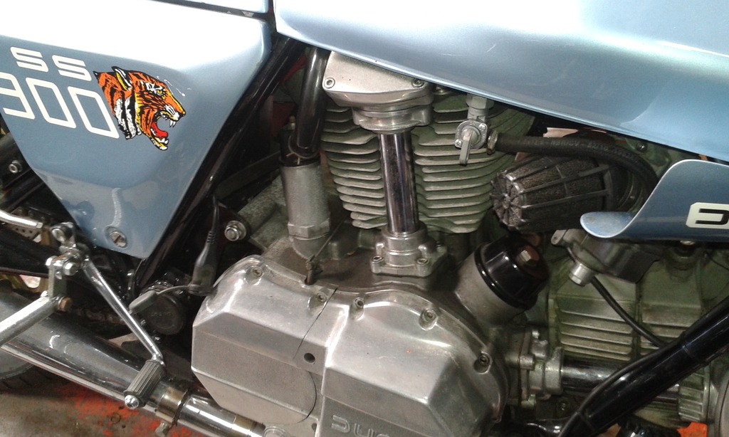

From the photos, there are some non-standard parts such as omission of indicators, lowered footrests, different rear suspension units, extra brace between the fork legs, aftermarket air filters, braided brake hoses - all done in the best possible taste. Looks like FPS wheels and Conti silencers - if so those are the good parts to have.
