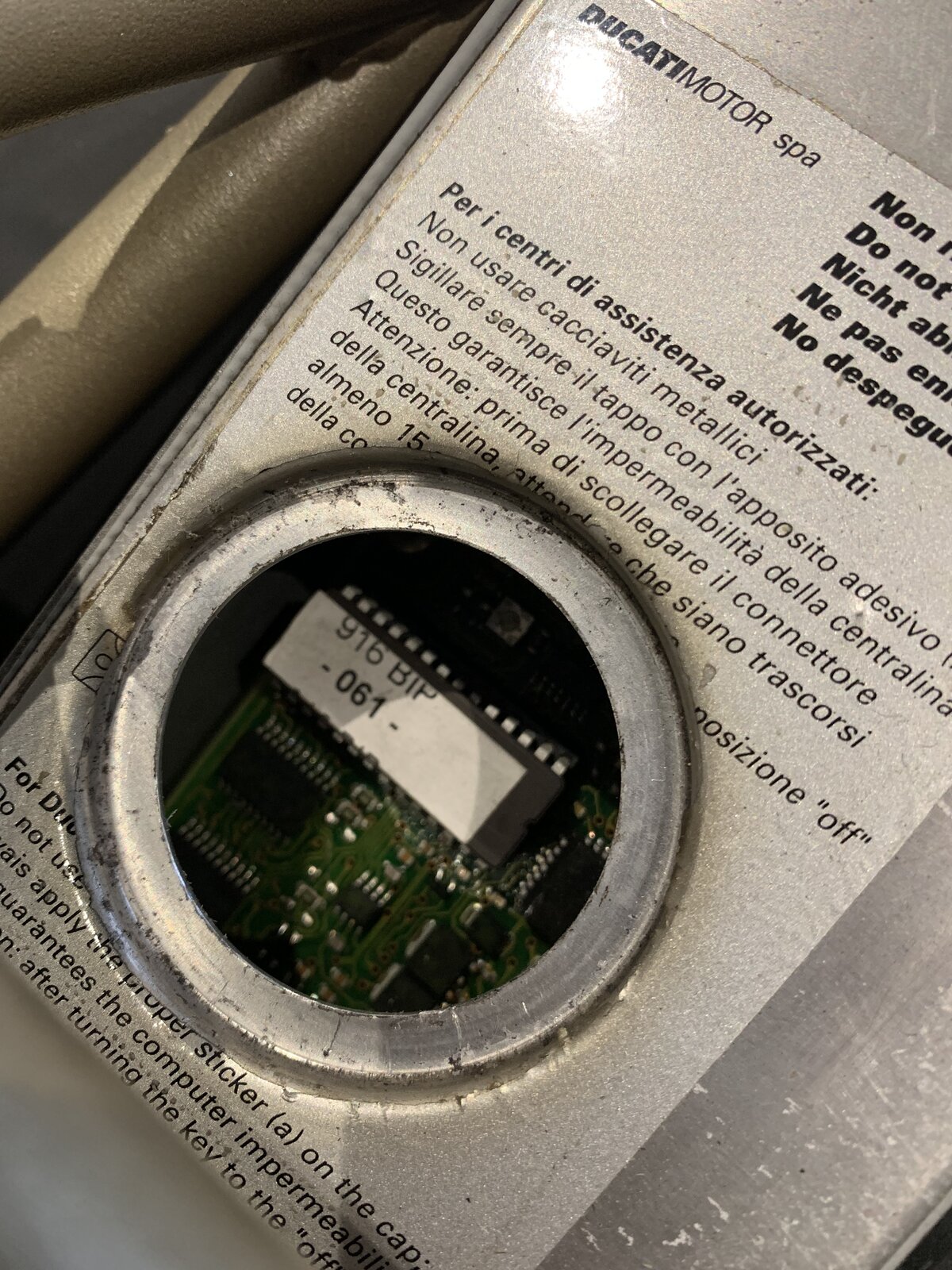

  1. Hi all, I have a 98 916 with full termi system, 45mm I’m curious as to what the chip should be as I have a 061 fitted.
    Any help would be great.
  2. 45mm is standard, Termignoni or not. Standard chip is good.
  3. The 061 EPROM is for standard silencers 95/98 916 Bip & Senna, for open silencers you need the 062 EPROM.
  4. that’s the info I’m after, where is best to get one?
