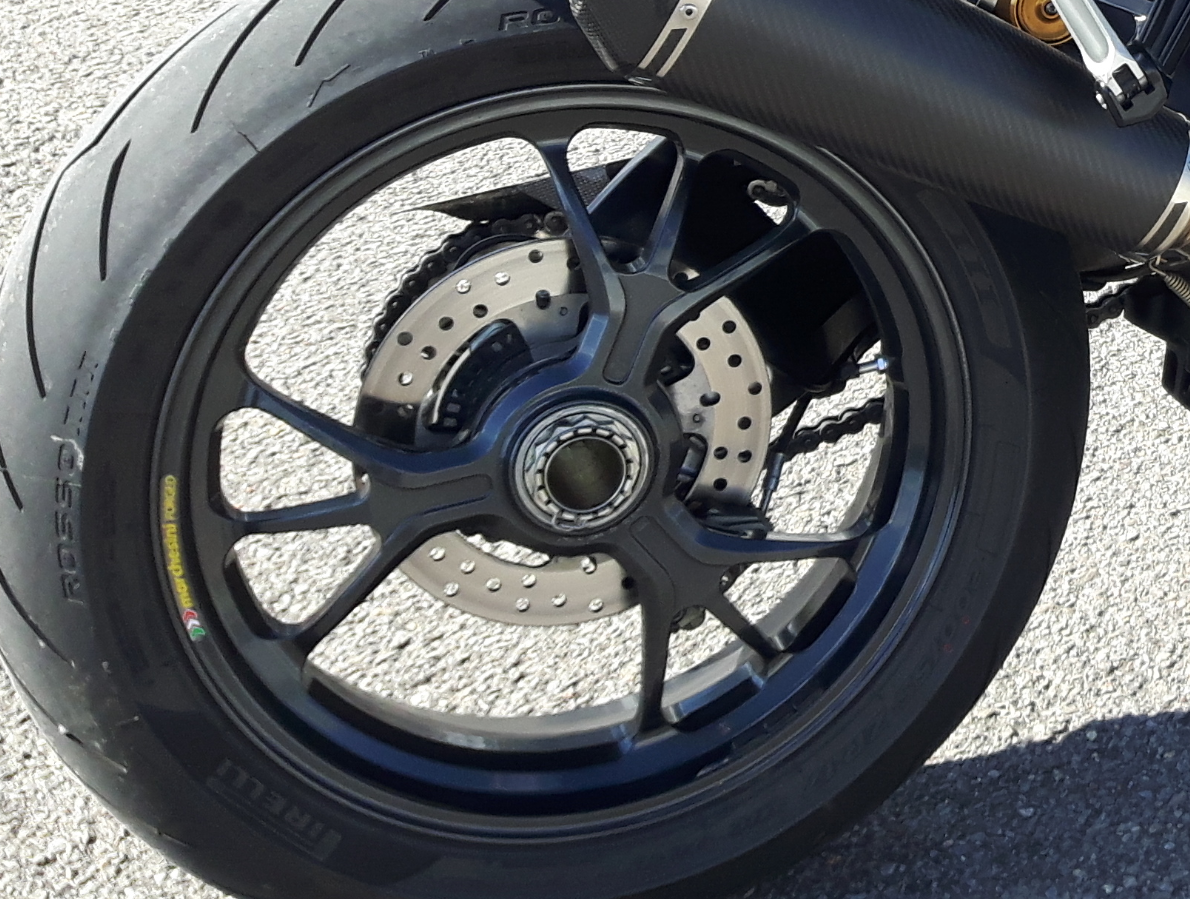

  12. What wheels did you get on yours and did you feel much difference?
    Changing to Marchesini’s or OZ’s is only about 6lbs reduction in weight but then again that is nearly a 30% reduction.
  13. In my case, I went the OEM way and paid the premium of the forged Marchesini's that came with the bike.

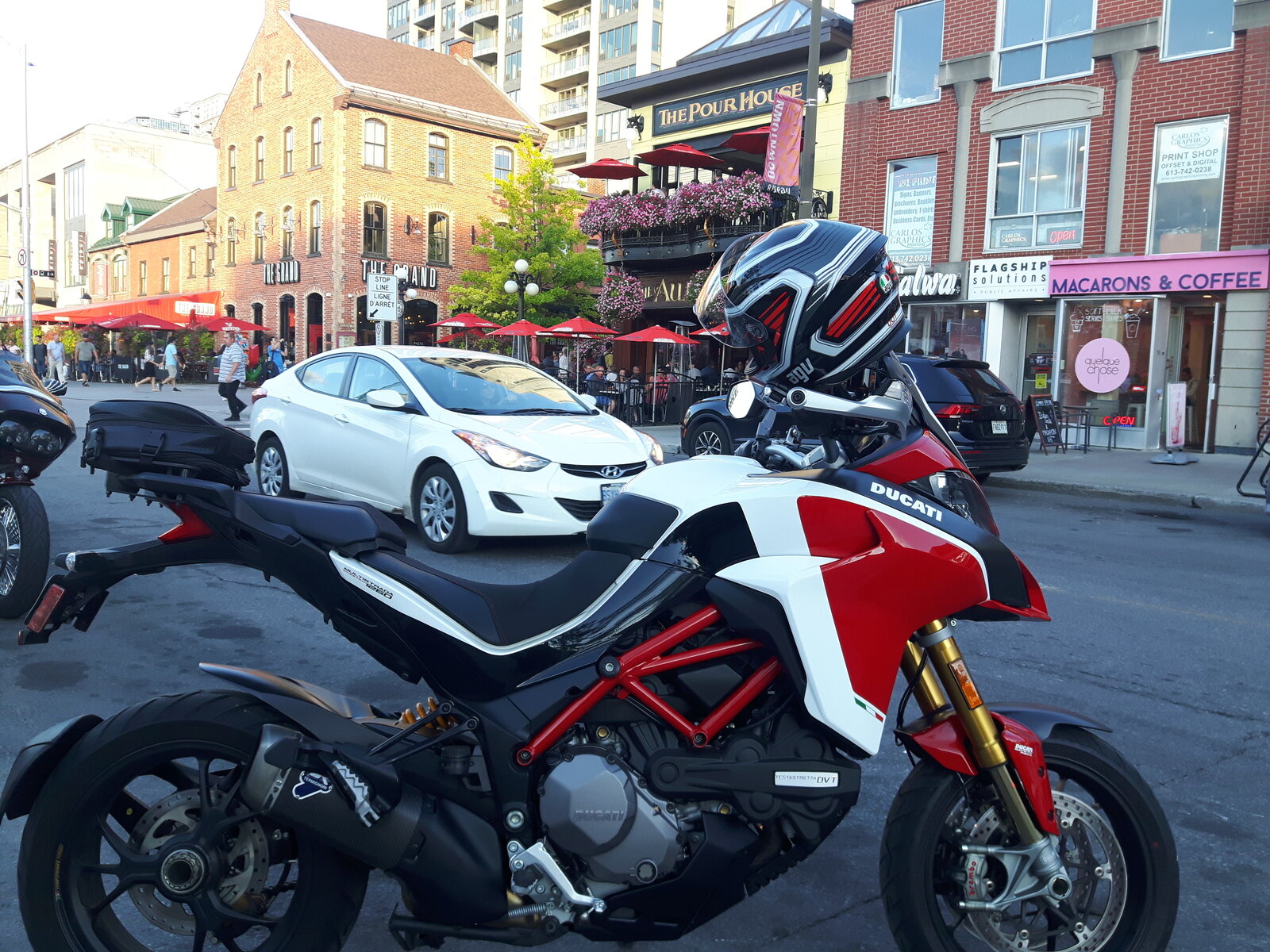

  14. I get that. Women just don’t understand the need for lightweight wheels.

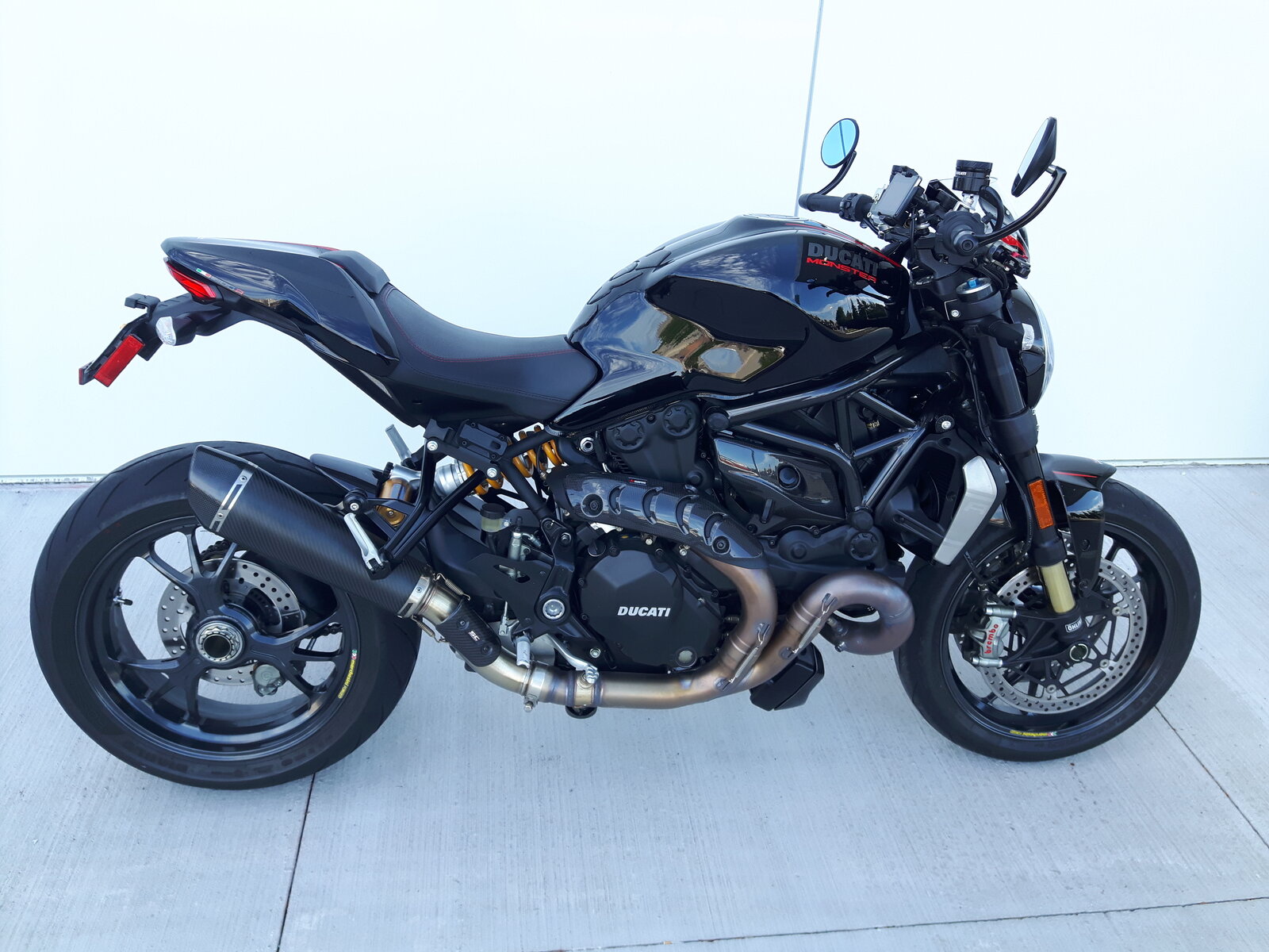

    It would be really interesting to ride two bikes, back to back. 1 with standard, 1 with lightweight wheels.
    Pics of the bike and wheels please.
  15. Not exactly great pictures of just the wheels.
    20180812_174533.jpg 20190829_190413.jpg 20191031_165844.jpg Screenshot from 2021-02-14 19:23:19.png
    #15 DarR, Feb 15, 2021

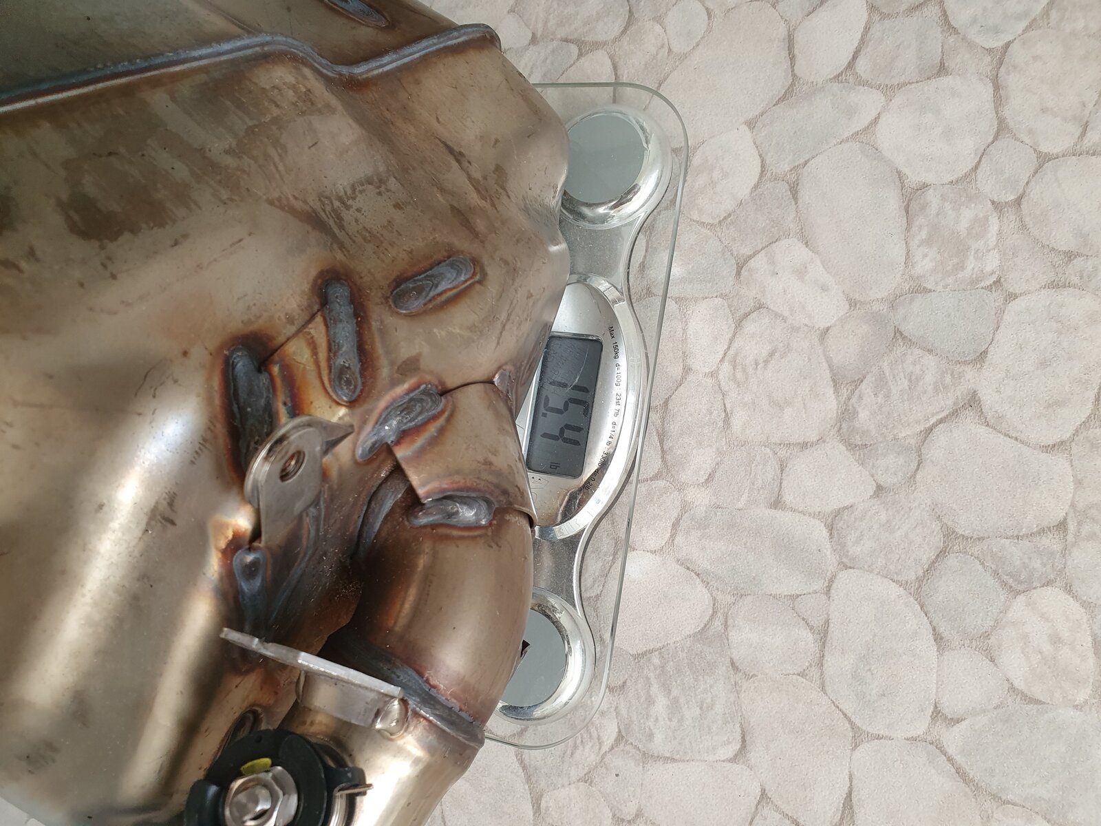

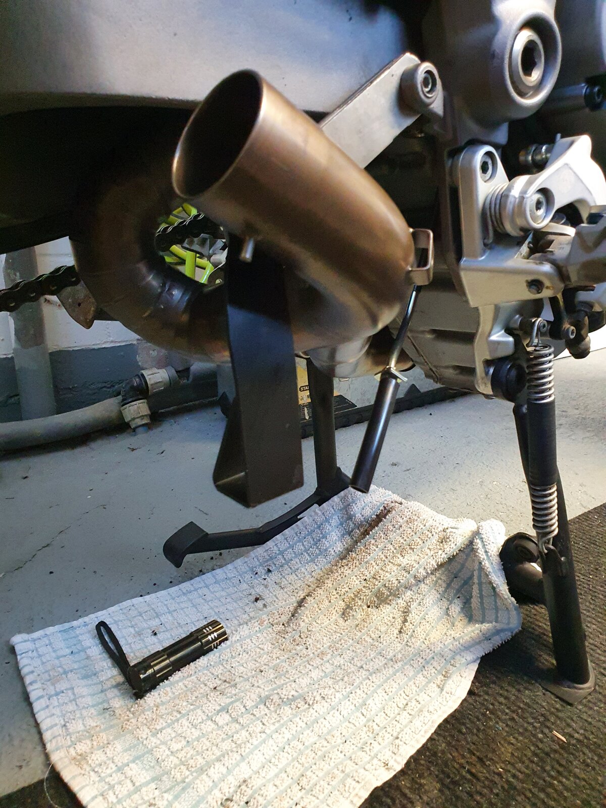

  19. Gone for the decat option, for now . Might look at the wheels if some come up at a decent price but I'm not paying £2.5k + for some. Just awaiting delivery of a termi end can that should be here tomorrow.

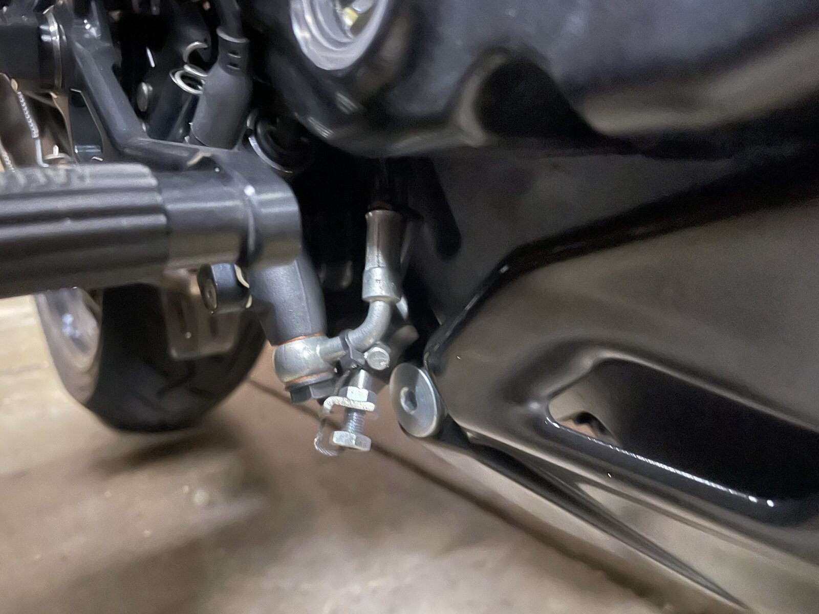

    Just thinking of how to hide the exhaust valve cable now !?!
  20. You can run the exhaust cable in front of your foot peg and zip tie it to the brake line at the bottom, next to the rear master cylinder - that’s how the instructions that come with the Termi have you do it. Pretty well hidden.
