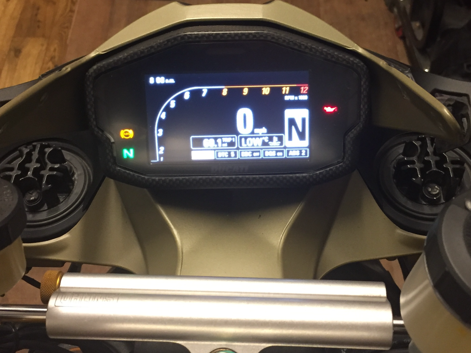

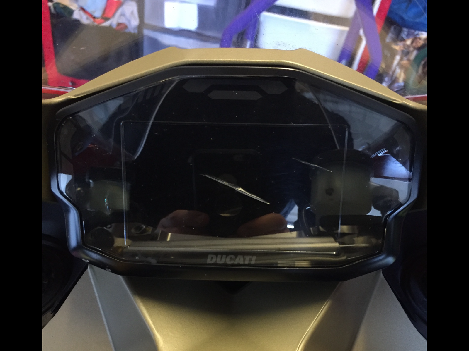

  9. Here’s my dash before and after I repaired it.
    Before
    After
    In the picture I had fitted a Matt screen protector which I have now removed as I didn’t like it. It made the screen look a little blurry. Anyway no more cracks, happy days.
    Keep us posted you your choice. :upyeah:

  11. That looks great. Did you remove the dash entirely to open it up? Was it screwed together or glued, or clips?

  16. Yes I had to fully remove the dash. The Dash is glued together which does make it a little difficult to pries apart. I did make quite a lot of marks around the outside of the dash getting it apart but once the new carbon surround is fitted it hides all that so it wasn't a problem.
    Once you have the dash split its just a case of dremeling out the cracked screen. I cut the screen out to the profile of the black edge.
    Then all you have to do is buy some UV stabilised Perspex and cut it to fit perfect inside the new carbon surround, then glue the whole lot back together. Job done :upyeah:
