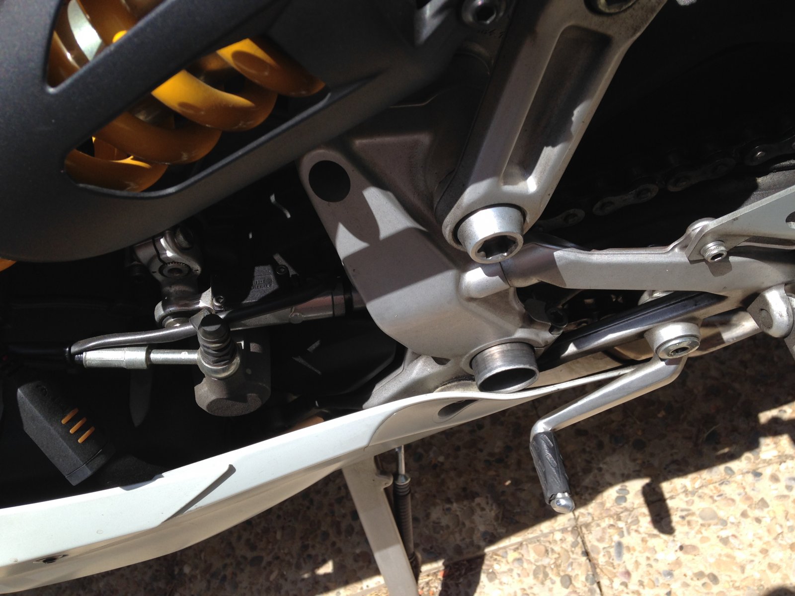

  1. anyone had this happen?
    Done 2k on my current trip and just walked out to the bike to see the swing arm pin has been working itself out! Only thing stopping it is the fairing!
    Going to knock it back in and tighten the bolt. Anything else to it?
  2. So called Hyside Ducati Romford and they gave some assistance over the phone.
    10mm centre bolt to put it back in and a 6mm pinch bolt to keep it there. So all looks good now.
    Unbelievable amount of travel on this for me so id recomend people check thiers; however this doesnt look to be a common fault on a Panigale but more common for track bikes (mine is not).

  3. I check the pinch bolts regularly as part of my cleaning/maintainence routine cos things have a habit of vibratrstig loose on these bikes
