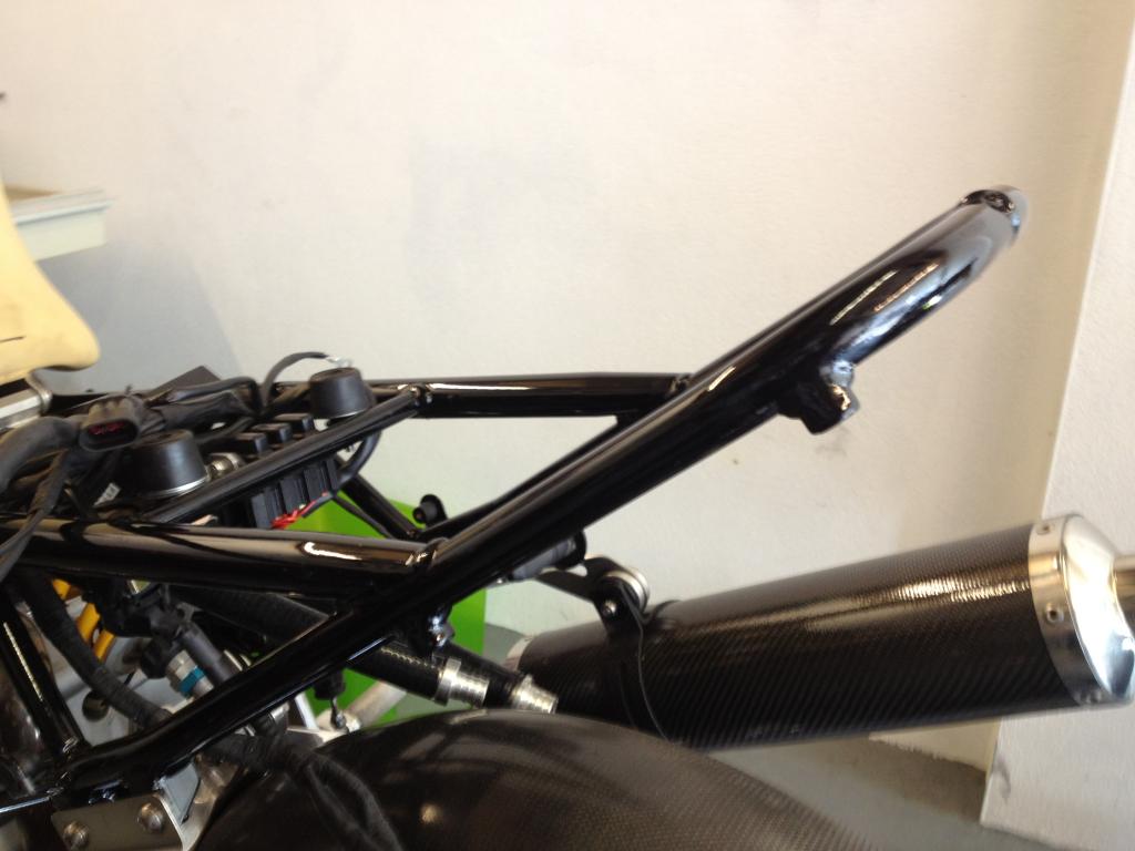

  19. You can cut off those little bits of tubing at the back of the frame - will lose at least 1kg - all adds up :upyeah:
