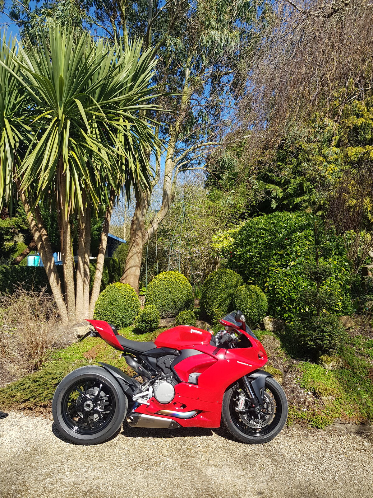

This has happened a few times now, seems to be when the bike has properly warmed up. If I open it up, at the high end of the revs it will suddenly cut out very briefly then kick back in again. It's booked in for it's yearly service in a few weeks so will get them to have a look, just wondered if anyone had any ideas or heard of anything similar
