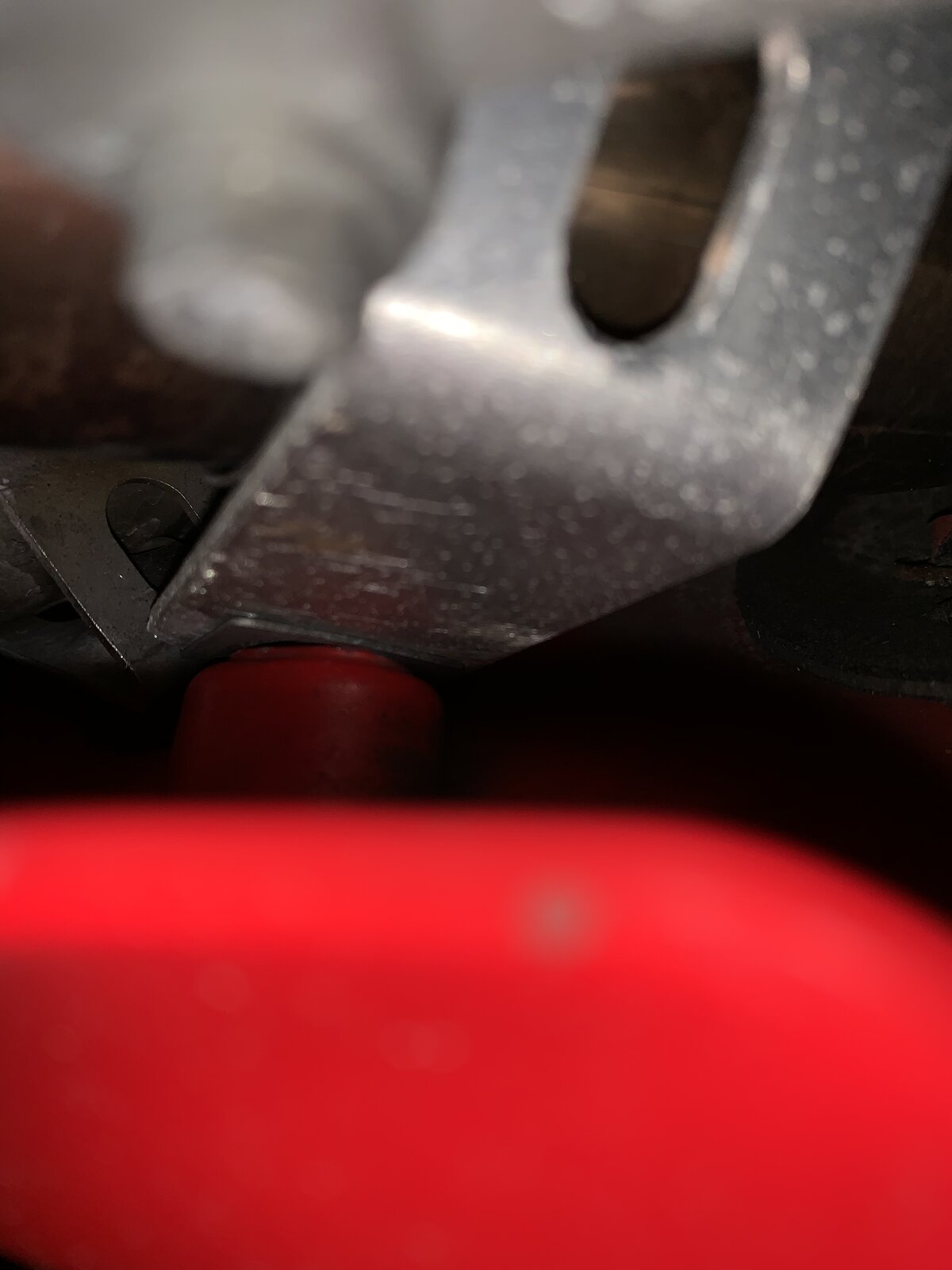

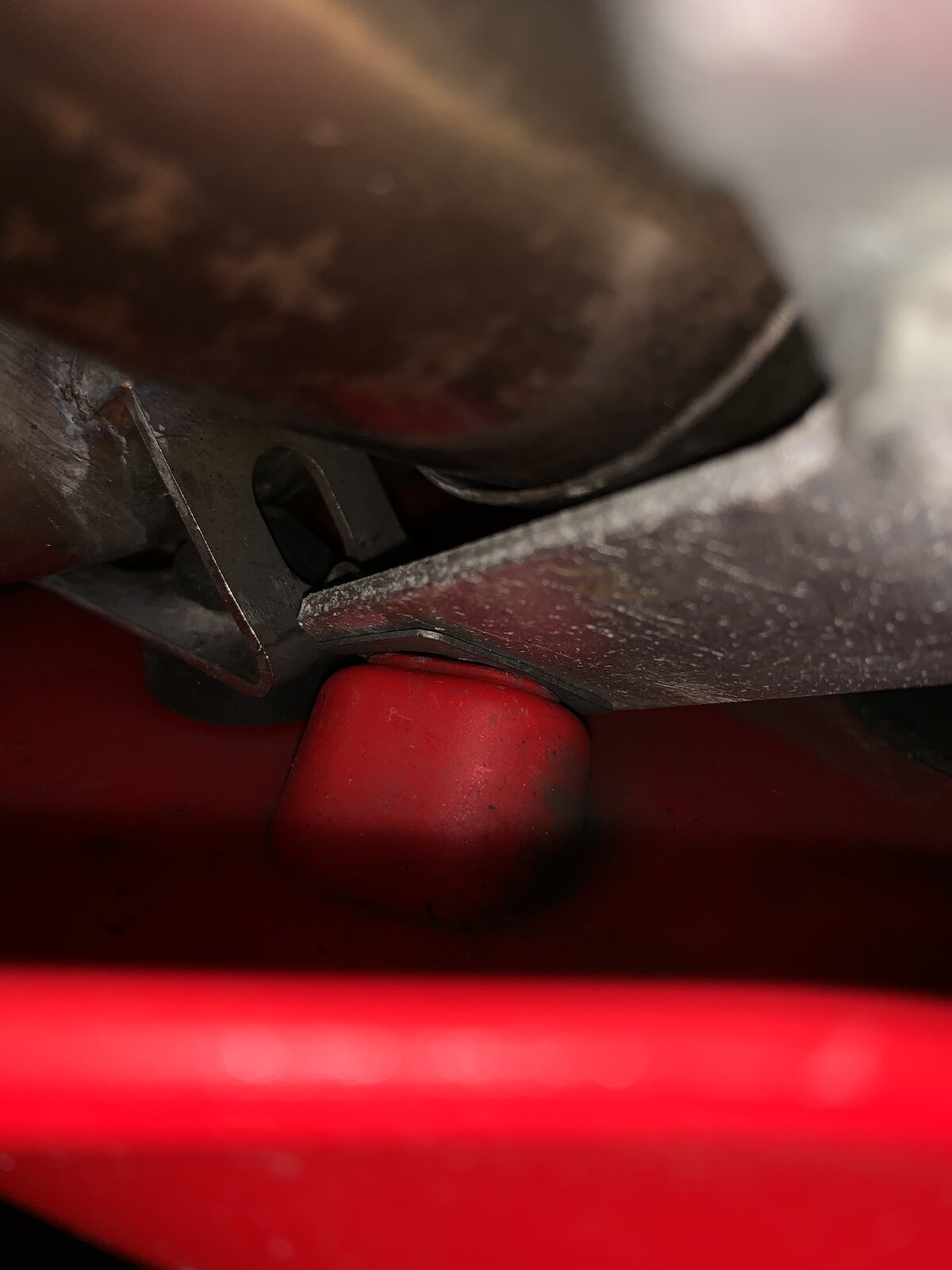

  9. 09CE2582-9F1A-43F4-AB38-66C6721A30C2.jpeg C6428296-1C99-4C41-BBDC-7F7D3695C3F7.jpeg Pics for reference if that helps. Note the rubber stopper which keeps the fairing off the pipe.
  10. Very helpful @Codfather ! Thank you very much!! I’ve noticed the rubber bracket, but didn’t thought that the rubber was for separate the fairing. This makes things more easier. ;)
