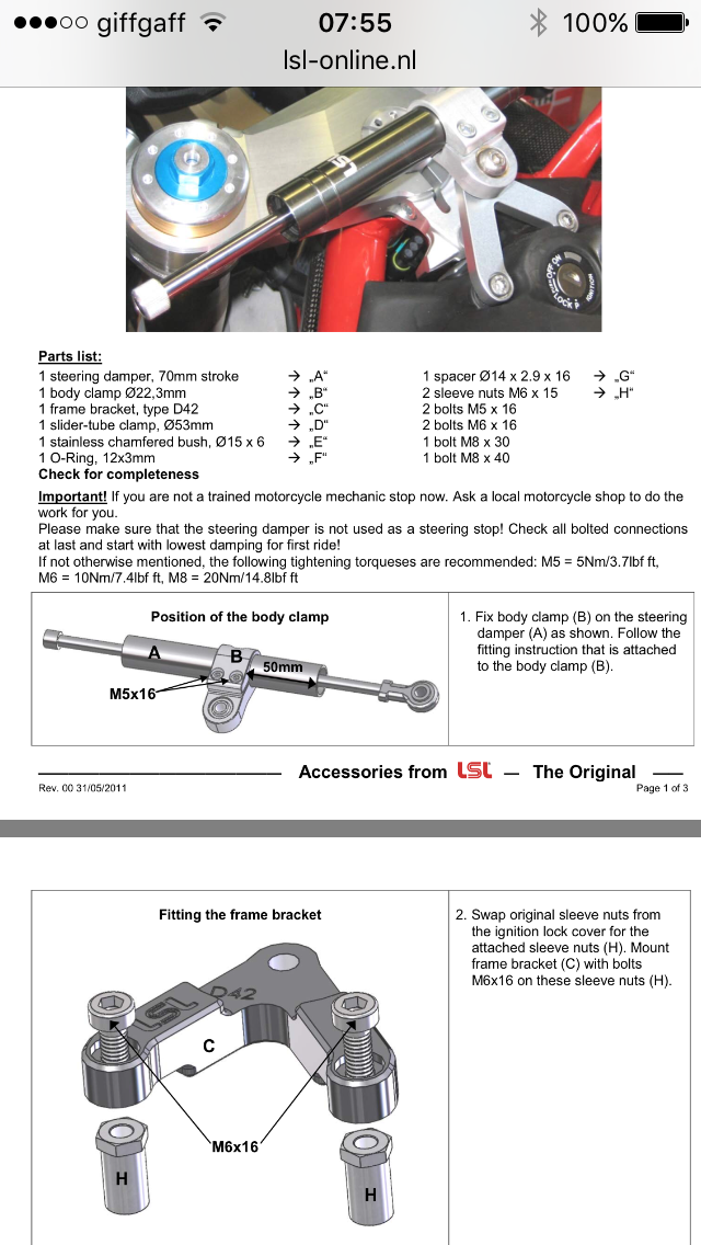

  1. image.png image.png Morning all, I have bought a Lsl steering damper 2nd and both me and the pervious owner didn't know you changed the fixing bolts that screws into the frame and ignition cover but he's sold the bike already. If anyone has them then this is brilliant and can I buy them, or, I think this is more likely does anyone have one and can give me the sizes of it, I know it's a M6 thread but it's the length of it I'm unsure about as it needs to support the cover.
    Here's a image of the fitting instructions, it's item H
    Thanks in advance. Stu
  2. Have you tried sourcing some from the manufacturer?
    If they are not UK based, making it less practical to get some sent to you, I'm sure they'd be helpful in telling what spec the sleeve bolts are.
