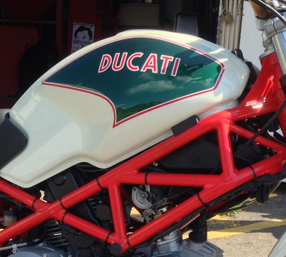

  2. Interesting monster adaption. Assume that’s just a pic and not yours?
    Throw over panniers are as good as it gets probably unless you can fab some brackets up.
  3. Nope, that's my bike, pictured near Chertsey 2-3 years ago.

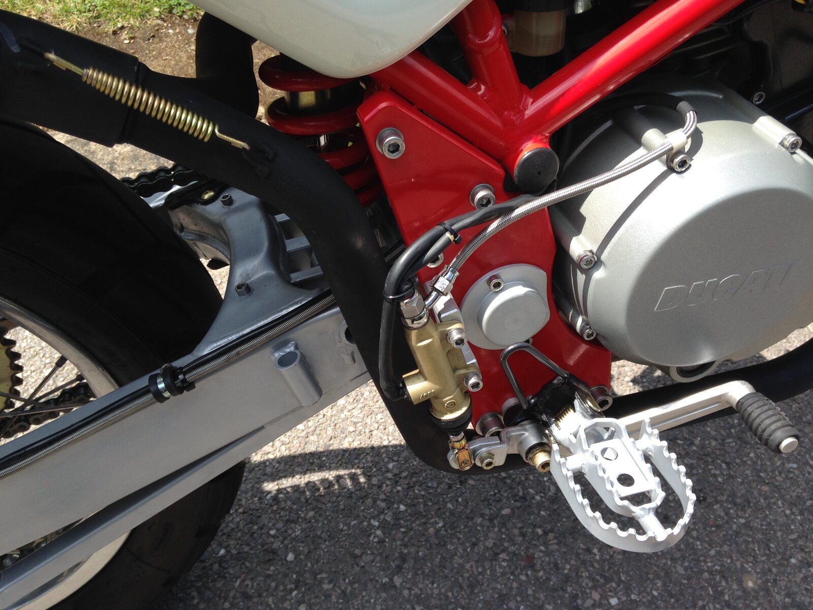

  4. What’s the swingarm? Have you just added a brace?
    Challenge with monster is the old school 1 piece seat. Otherwise you could ditch the rear seat and fit a top box. Although that may be possible anyway, but if it’s off road I’m guessing panniers better option?
  5. Yep, standard Monster swing arm, but braced and with a mount for a Dakar style prop stand. The swing arm pivot (originally from the rear of the engine) is now supported by plates bolted to the frame so it has more lateral strength and won't break the crank case if it takes a whack off-road.
    The font end is Cagiva Elefant, as are various bits like the foot pegs. The steering head angle has been reduced so it didn't end up looking like a chopper! Steering tube braced to give extra strength.
    Just need to sort panniers!! :) I am sure I have seen some bars that provide support for soft panniers... anyone familiar with those?

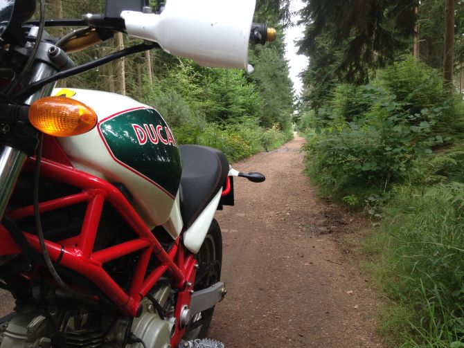

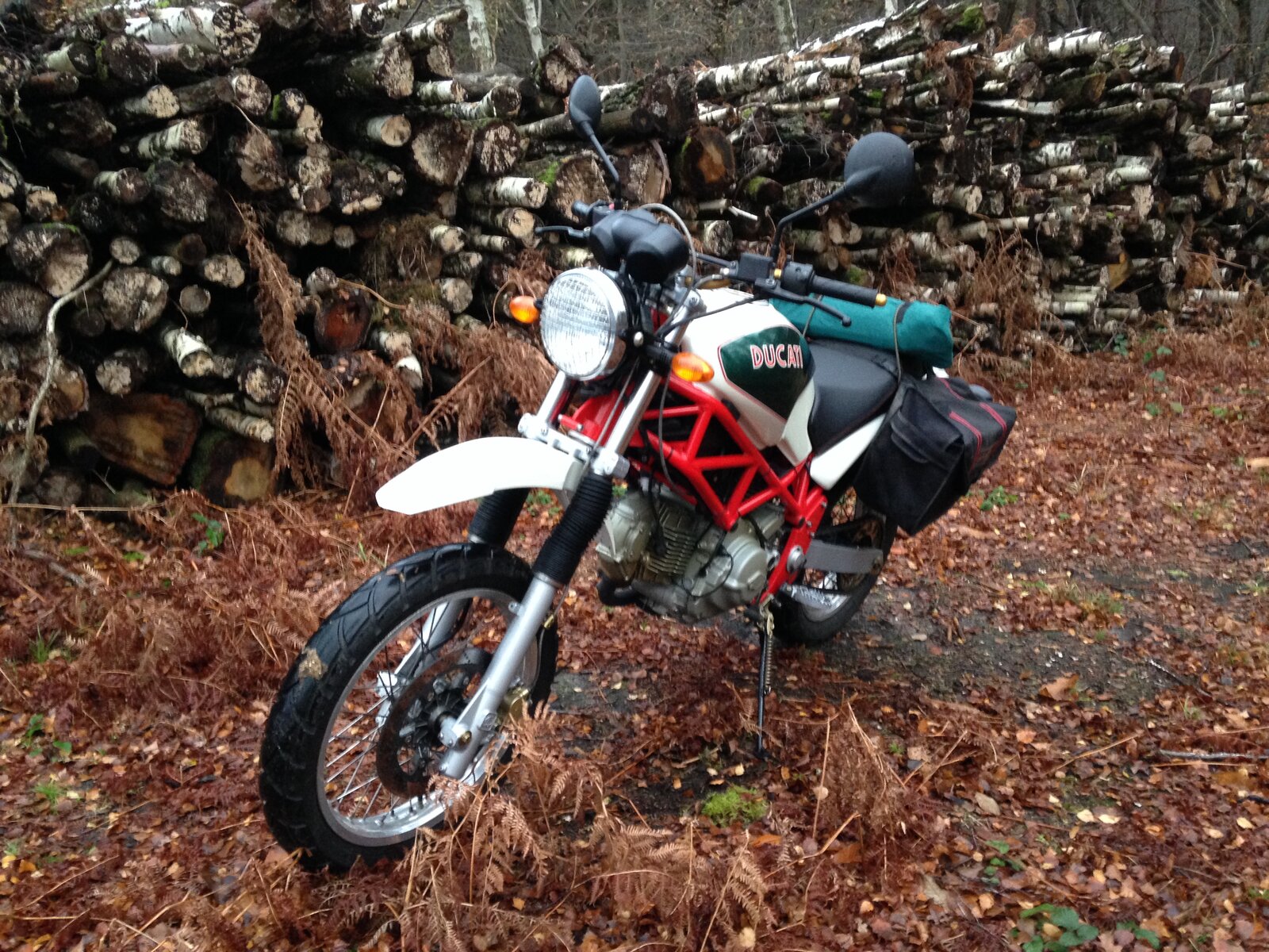

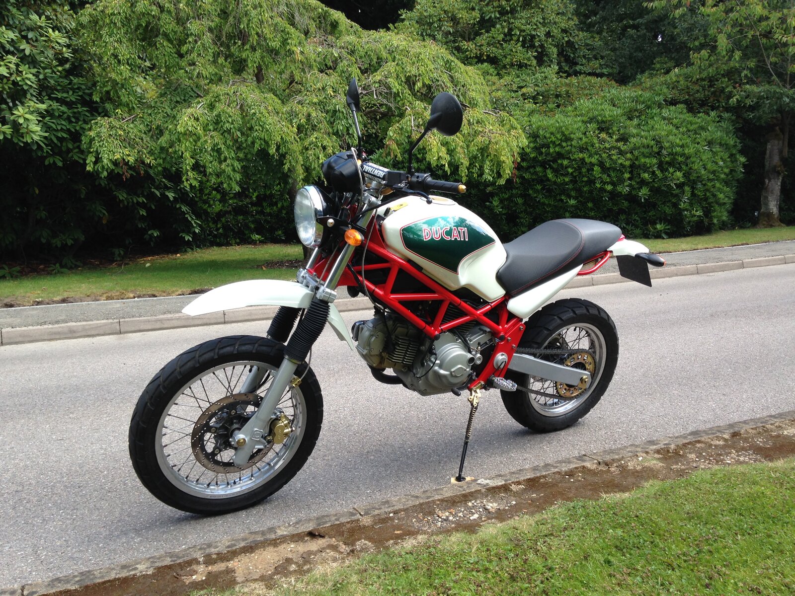

  7. I think it looks great, have you got some more pictures?

  10. Sure, here we are:

  18. Not sure what happened there - I was describing the engineering solution for the swing arm support which entails a steel shaft that runs through the original crank case bearings, and into oversized bearings pressed into the support plates so the whole thing is very rigid.
    I was incredibly fortunate to have the assistance of Gavin Robertson, who designed the whole solution. Gavin has a long history of fitting barking mad Ducati motors into Cagiva Elefant chassis.
