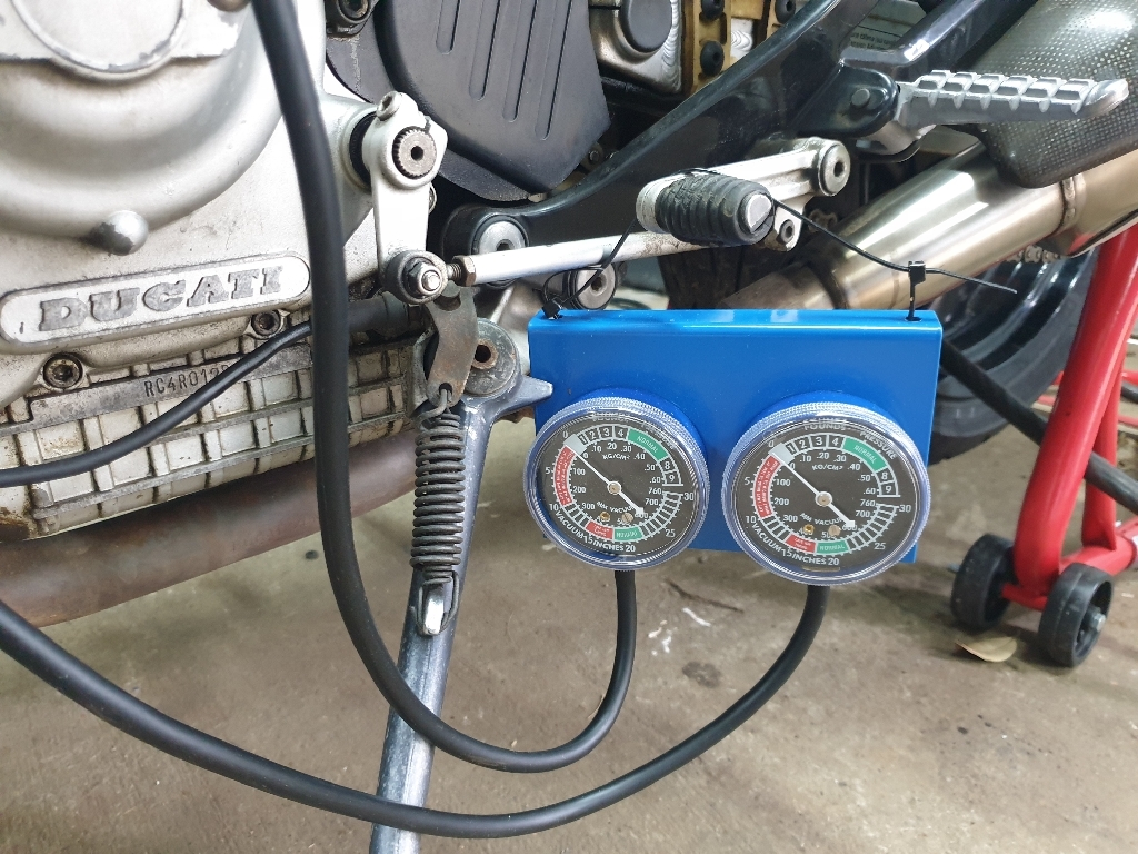

  11. After getting the carbs back in I needed to balance them and set the idle. I bought a cheap set of gauges and after calibrating them I found that lying on the ground was the best position to adjust the carbs so this was a good place to hang them where I could see them.
    The idle screw is not too bad to access but the butterfly sync screw is a right pain :joy:
    Anyway, job jobbed so onto the next thing.

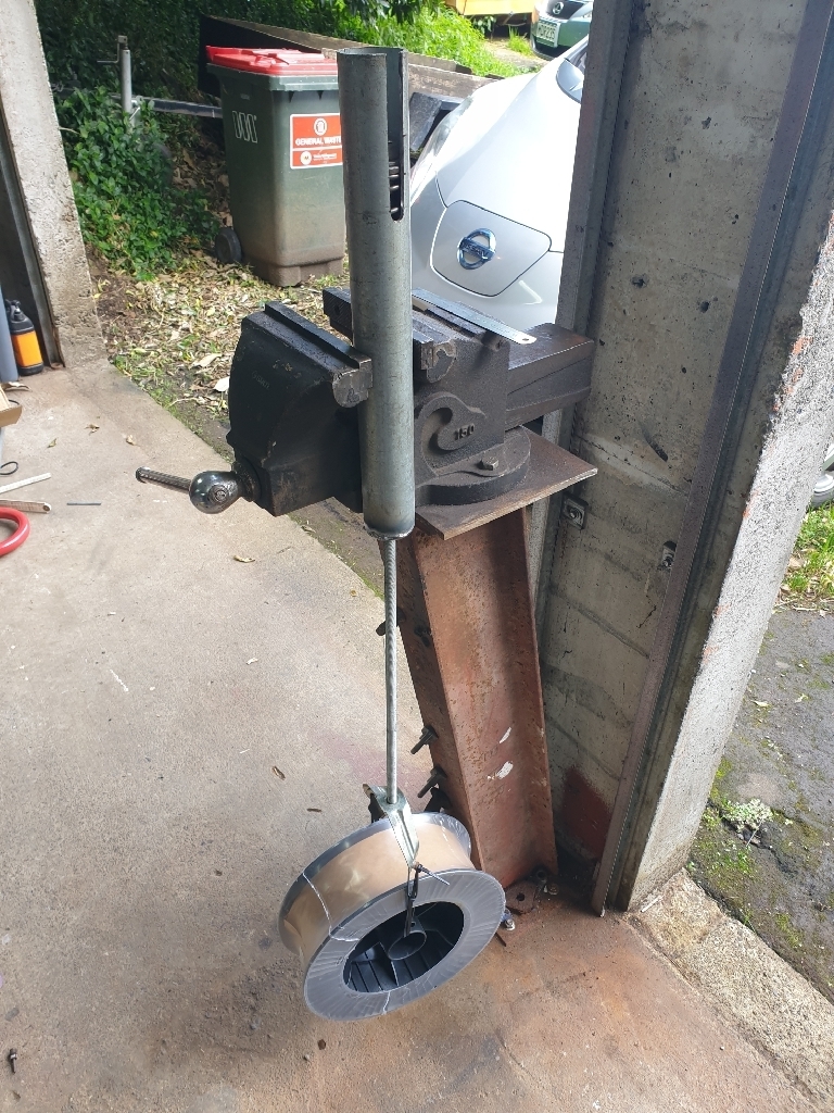

    The oil looked good and level was about 110ml, the spring seemed weedy so I cobbled together a thing to measure the rate. Made from a bit of scaffolding I found when out walking the dog, some misc washers and top hat spacers held together with a couple tacks and some all thread. An unopened 15kg roll of mig wire provided the load for measuring.
    The 15kg weight compressed the spring 25mm which makes the rate 0.60kg/mm :eek: Online calculators suggest 0.85 for me so I have some of those on their way.

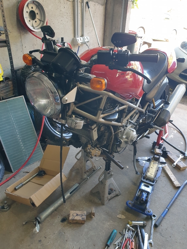

  18. I'm only making a little progress at the moment, just doing small jobs as I wait for parts.

    Some 0.85kg/mm springs to replace the 0.6 ones. A quick go in my spring rate measurer shows they compressed about 18mm which is spot on. 0.85 marks on the left and 0.6 on the right. The spring is a bit longer so I'll need a shorter spacer but will leave that and sag adjustment for later.

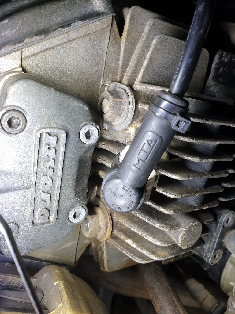

  19. A bit more progress, I have four studs out so far, these didn't give me too much grief. Repeated heating and doses of atf/acetone mix and they eventually came out. The vertical cyl studs feel like they may give trouble though.
    After getting the vert cylinder off I was keen to see the state of the crank plug but found it well seated and nowhere near touching anything.
    This was surprising as it means the ally bits on the strainer came from somewhere else.
    Something has happened to this engine at some point as the horizontal head has marks from something banging around but the piston and cylinder don't so maybe the bits on the strainer were just leftovers from an earlier failure.
  20. Looks like you may have been lucky there then. Is that gasket sealer I can see in that lower picture?
