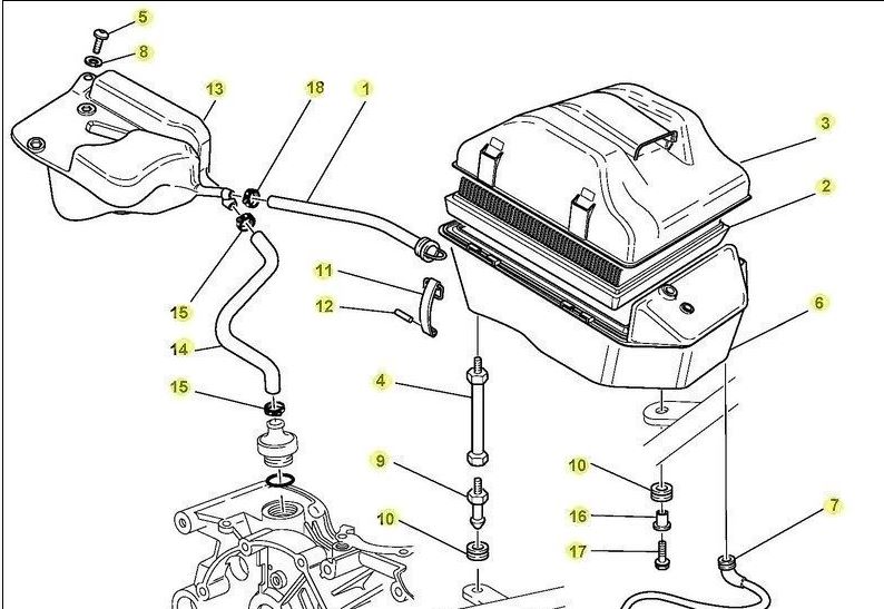

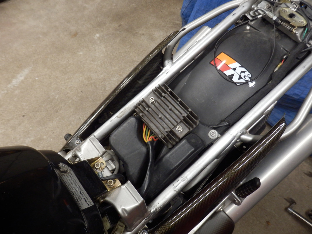

    The Reg/Rec is sited under the saddle, not behind the headstock, and is bolted down to the top of the oil breather box.

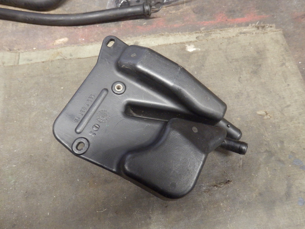

    The breather box is a complicated molded shape, and there simply isn't room to fit the newer MOSFET Reg/Rec.
    Firstly, I should say that despite all the arguments for and against the standard breather system I decided I want to keep a standard(ish) system and do not want to fit a separate K&N style filter on a pipe connected to the engine breather outlet.
    I did think about slicing the upper raised sections off the breather box and plastic welding on a simple flat top section, which as you can see from this image should be possible.
    But even with a flat top there is very little room under the saddle as the MOSFET is significantly taller than the old unit.

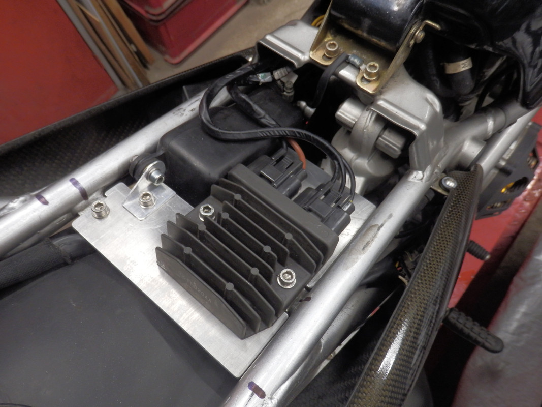

  2. What I did have to hand is an old M900/750/600 Carbie Oil Breather box:
    This will do the same job, but freed up a lot of space to mount the new Reg/Rec on a simple Aluminium plate, with a little angled bracket to attach the Carbie Breather box.
    If it all works OK I might make a new plate with the box mount integrated as a folded up tab.

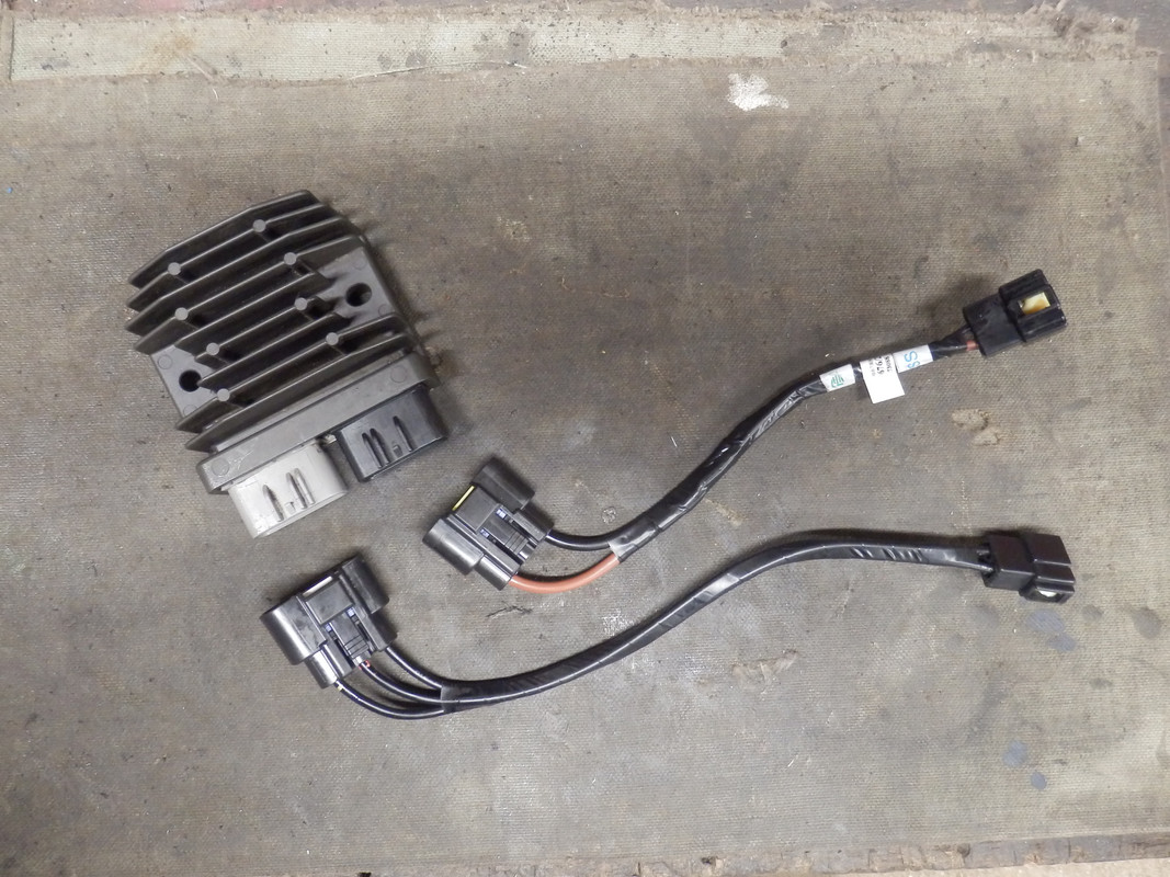

  9. Just get the Panigale, Diavel… or newer R/R off eBay or similar and the Triumph link cable for less then £80 for the pair. These very rarely fail nowadays so no need to buy new.
  10. Yep, just need to keep an eye on Ebay for one that comes up Buy it now really cheap.
    Yes, but all three Reg/Recs I've brought off ebay have cost me less than £30ea. And all three are from later Ducatis.
    Most people who are breaking a Triumph now know that the link cables make the newer Reg/Rec a plug and play exercise on lots of older bikes, so I ask private sellers listing other parts if they have them.
    Perhaps they are not aware how sought after they are so I've been picking them up for £5 or £10 a pair.
    They are only @£35 new from a Triumph dealer though.

  14. Is there much airflow under the seat to cool the reg/rec? First thought says no...
  15. Nope, no airflow.
    But, my thought is that if Ducati put the std one there, and the new one generates far less heat, it will be OK.
    It's also now bolted to a large Aluminium plate that is open on it's back side to any air flow.
    Whereas the std set up bolts it to a plastic box connected directly to the crankcase breather.
    Whichever way you look at it the replacement is better with regard to heat generation and dissipation.
  16. Agree with the above. The Panigale R/R gets zero airflow and is mounted on a plastic tray. It’ll be fine there especially with that alloy heat sink.
