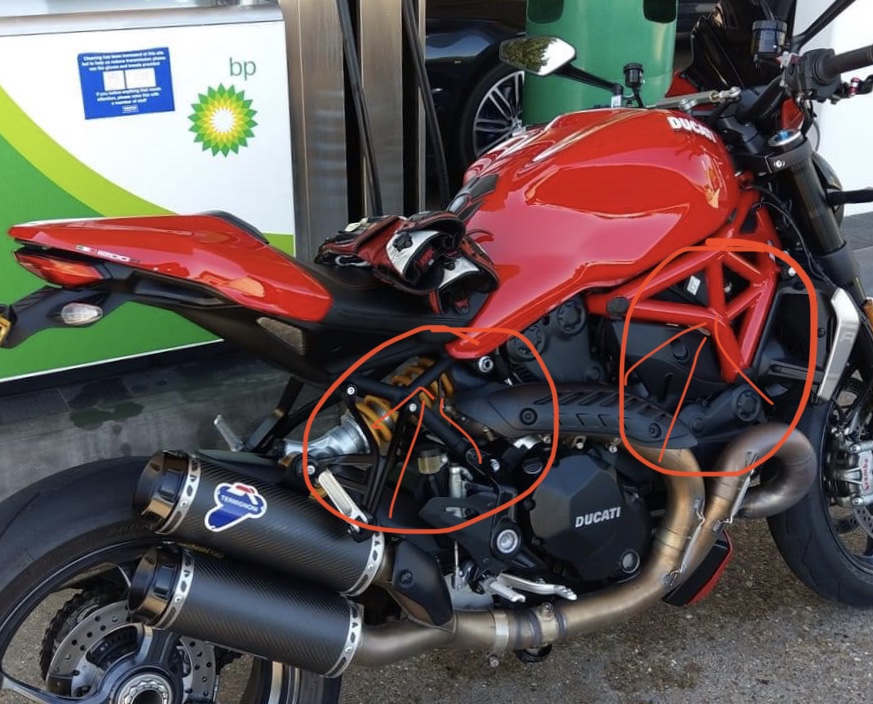

    I have a M1200R. 1st ride after it’s been cleaned I get orange rusty water coming from the 2 drain holes in the pic, that I stole from another post.
    Said orange water gets blown across the exhaust guard from the front hole and the swing arm and shock from the back.
    I’ve located the drain holes and can see they’re orange inside.
    Bit of a concern knowing the frame is rusting from the inside out.
    Anyone had this and located where the water is getting in in the first place?
    Cheers
  2. They're not meant to get wet..
  3. My guess is that they are not really drain holes, rather they are hot-air expansion holes for during welding. All the tubes are closed end, so I expect you're getting water ingress through a weld gap. Can you get enough junk off the frame and force air into the 'drain' hole & see where the entry point is (cos it'll be pissing out orange!)?
  4. that is alarming particularly considering that it's happening to two separate welded assys. No idea how it started or what caused it, but makes me wonder if whole bike got "a lot wetter/damper than usual" at some point.
    Would be good to know how many miles old? owned from new?
  5. It will only be light surface rust on the inside of the tube, not a structural concern at all, it would take many years to progress to the point where the frame was weakened, I would suggest placing a small domestic fan heater near the tubes to warm them enough for the water to evaporate and then feed a WD40 tube into the hole and give it a blast, obviously don’t get the area too hot for fear of damaging surrounding parts, next time you wash it do so with a soft brush and soapy water and take care when rinsing, a watering can is reasonably good for this, above all do not use a jet washer, they force water into many areas that it shouldn’t be.

  15. My guess is that there are weld gaps at the other end of the tubes that have the 'drain' holes in them - watch for orange egress at those welds when you pop the compressor air up their 'drain' holes.
    I'm not intimately familiar with the Monster frame so am just making assumptions...
    I second the Waxoyl solution as above (but if it's a new bike I'd certainly mention it to Ducati).
