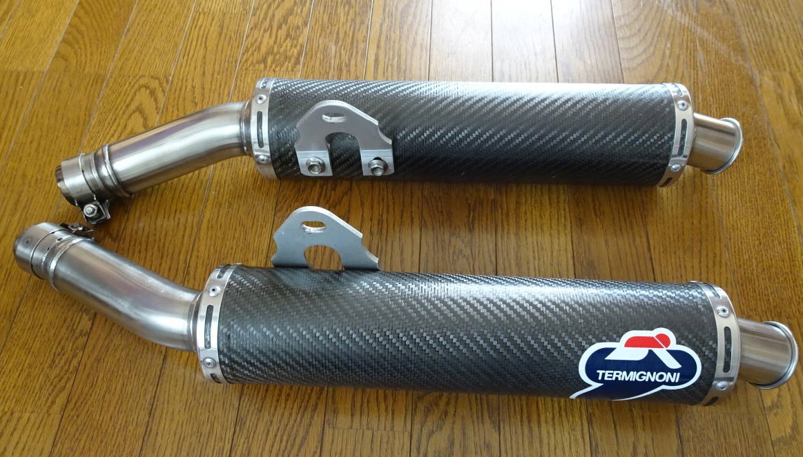

  1. I have been keeping an eye for some Termignoni's near me without much luck but I have found some for sale apparently off an M400. Would these be a viable option for me?
    From all my searching I get the vague impression that they would fit and from the pic they don't seem any smaller than other 900 cans. I can't see Termignoni making cans specifically for the 400, what are the odds these are 900 items? The seller doesn't know either.
    :thinkingface:
  2. Yeah, I'd be taking a punt on them. Certainly if the asking price isn't too high. :upyeah:
  3. The header pipes are different on the 900 vs. the 750/600/400 due to the longer cylinders etc. but AFAIK the cans are the same.
    Why would Ducati have made them any different?, especially at a time when they weren't particularly flush with cash and that the smaller engined models were (presumably) made to a tight budget, meaning extra R&D would be out of the equation, as they were essentially the same bike but sold for less so use existing parts where possible and even more so with aftermarket parts, I would think.
    Plus, the cans in the picture look great to me. :upyeah:
