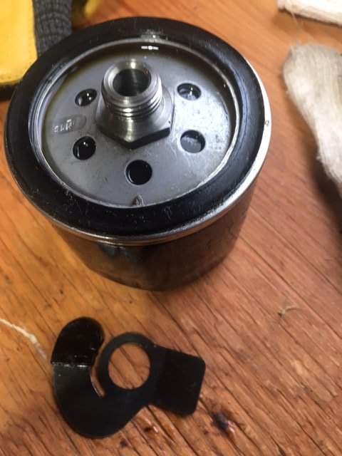

  4. You mean this, right?
  5. Yes. The the diverter plate.
