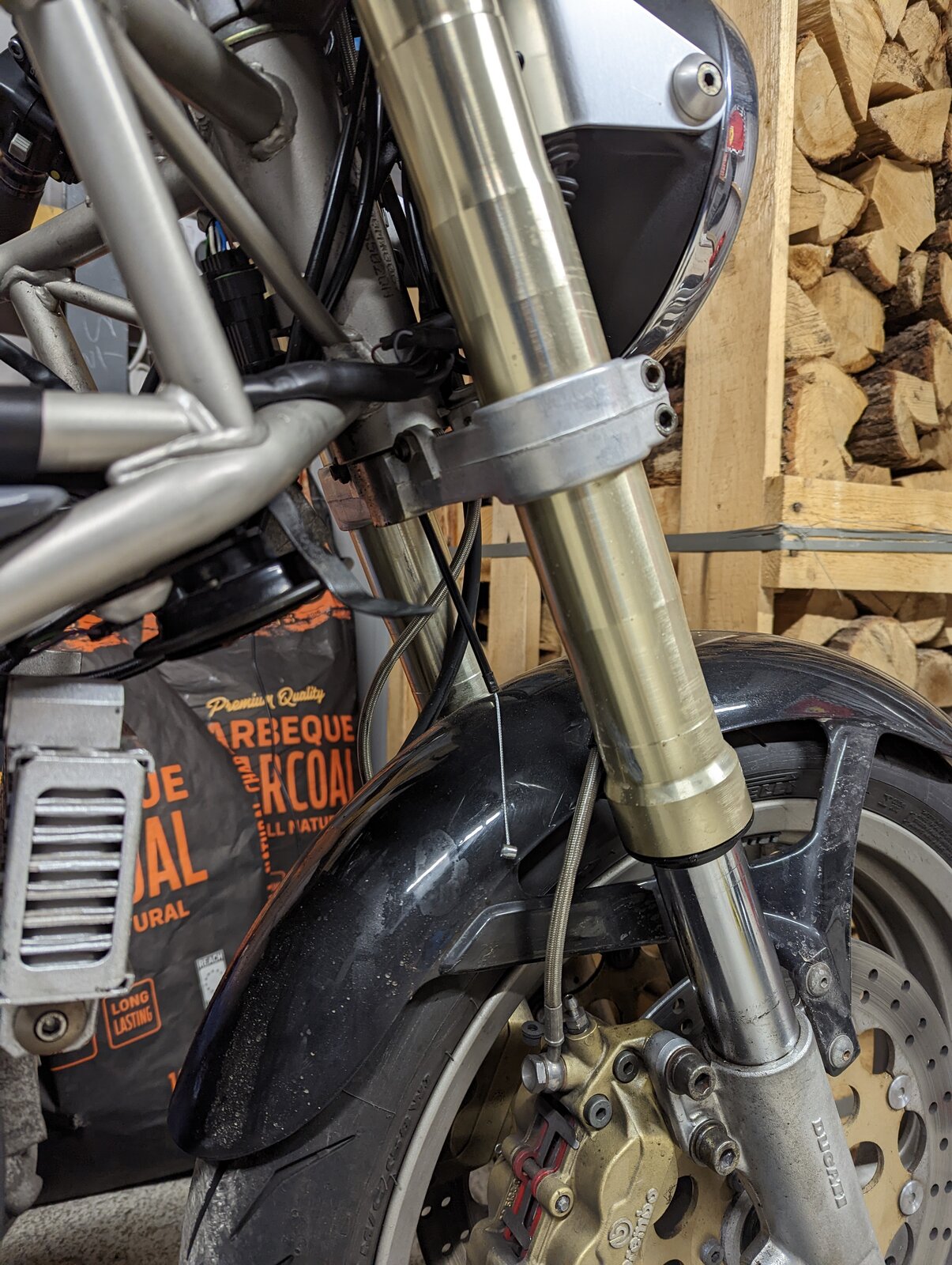

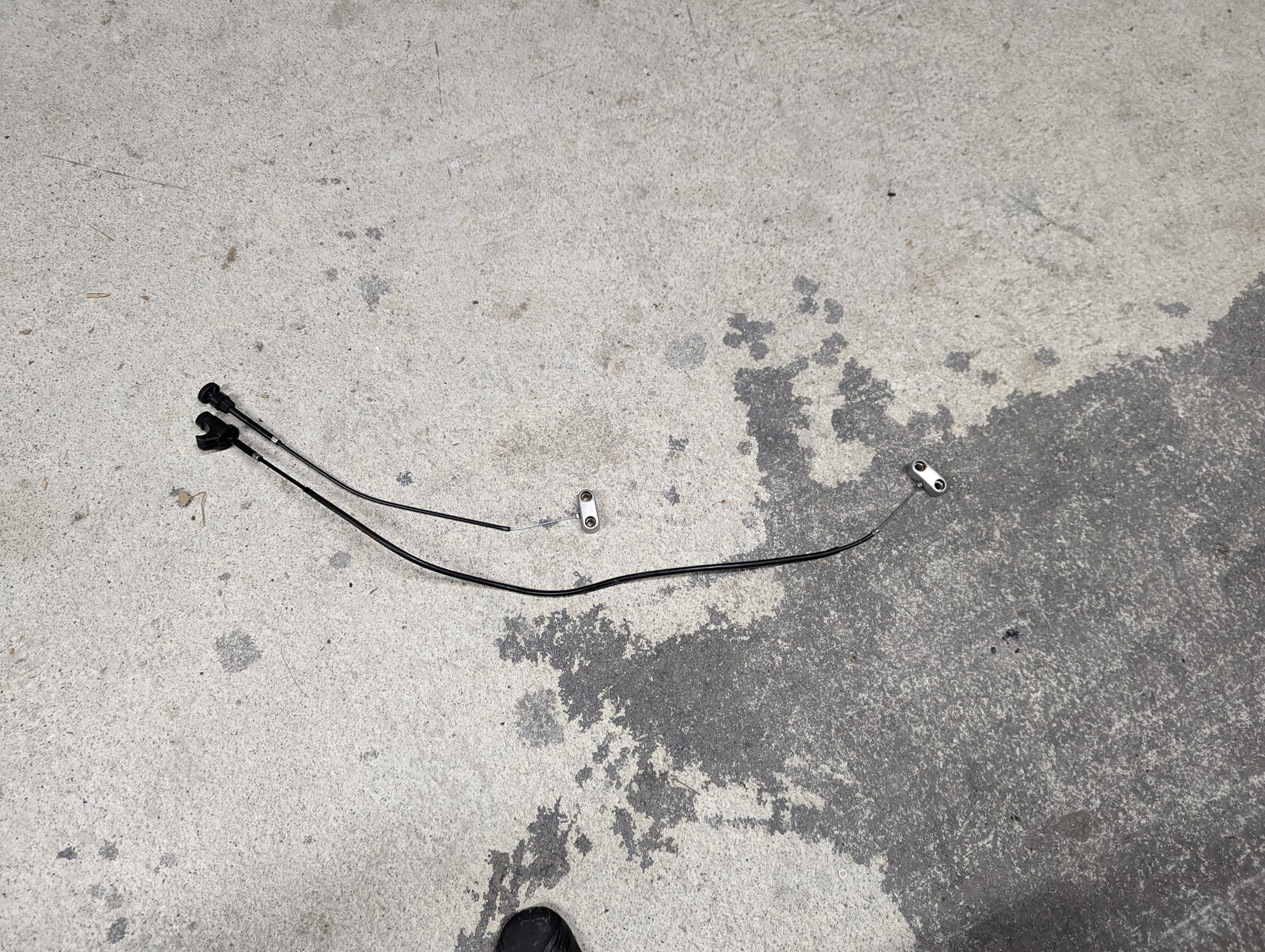

    I ordered choke cable off Ducati via vin but it is about 60cm too short , no way will it reach
    Does anyone know the correct part number, I can only see two, cable via center stem or mounted to the handle bars
  2. Did the have the choke mounted on the side of the frame at one time ?
  3. No , was always via the center stem
    OE Dealer sent me 65540011A , also goes via the stem but is alot shorter , both 65540021A or 65540011A are listed for the bike
    I think the OE Dealer taught 65540021A was the handle bar choke (Clamps to the handle bars) but appears it is also for the center stem but longer
  4. You need the 65540021A by the looks of things. That lists for VIN numbers 004463 to 9914. The '11A part number is for bikes up to 4462.
