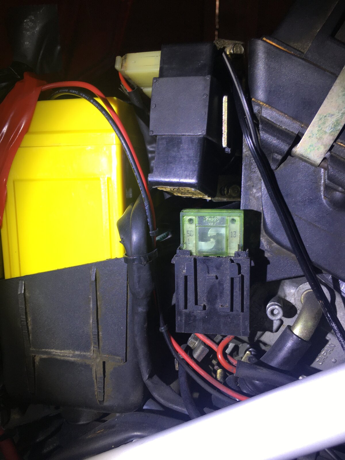

  4. This could be something to do with it!, 30 amp fuse at the right hand side of the battery is blown, but why has it blown I wonder?? F8C3DCE8-0C85-49FA-80BA-26DB2451A757.jpeg
