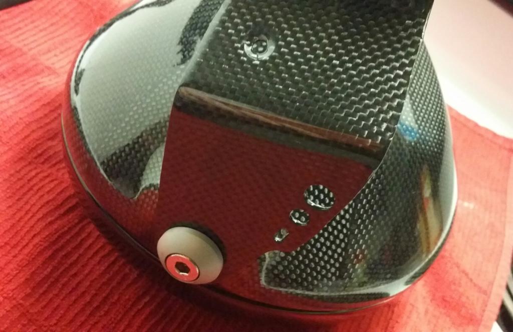

    - Motodemic drop in LED conversion with Motowheels carbon fiber bucket

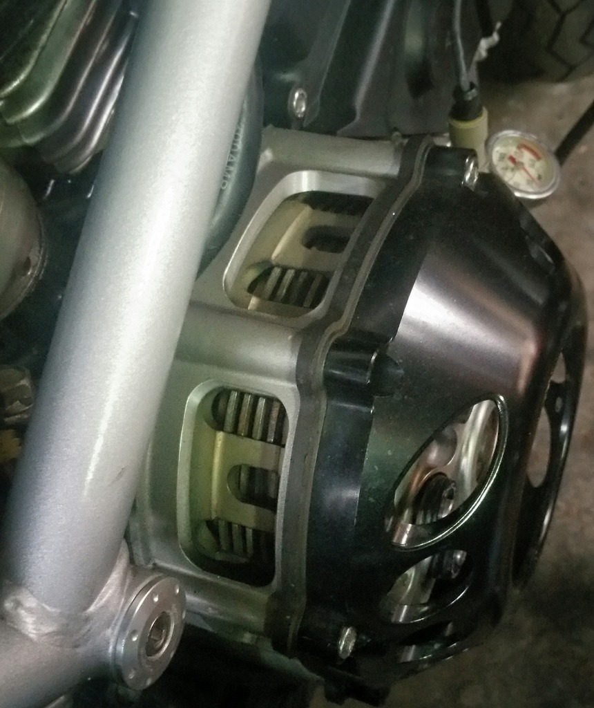

    He also machined my clutch side engine cover which came out great:
