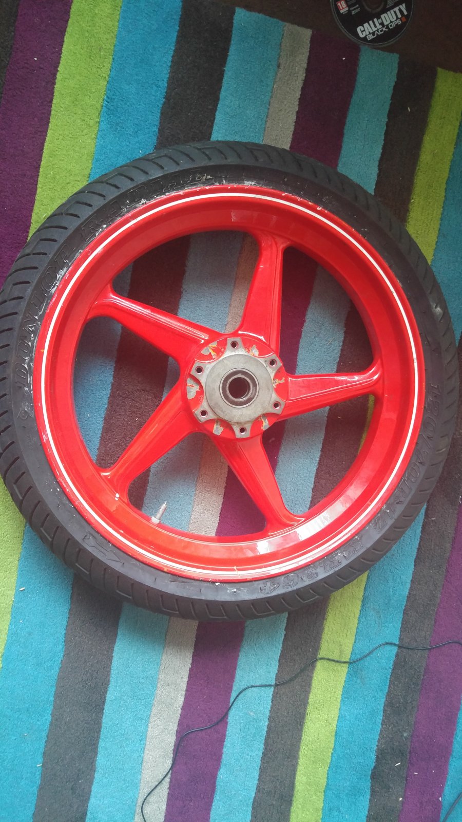

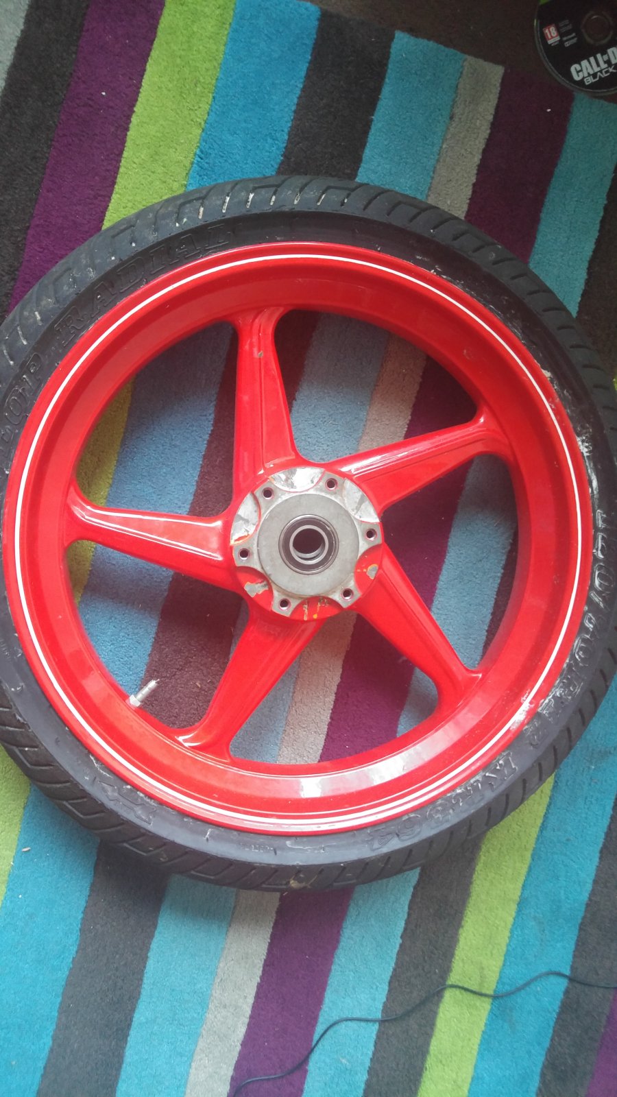

  1. Ok, I have a pair of wheels (single sided swingarm type) and I have no discs on the front. It it not standard disc fitment so I was was wandering if anyone could help in identifying the bugger.
    heres a few details:
    6 hole pcd
    100mm centres on pcd
    80mm centre shoulder
    105mm face to face on discs mount surfaces
    748/916/998 axle fits with current bearings.
    Any help appreciated.
  2. I can't help with the wheel, but are you sure the tyre is on the right way around?
  3. My first thought is a Marvic. I'll google for a while and see if I can find an exact match. Andy
  4. That's a Dymag. Got one like that on my 916.
  5. Yeah I reckon dymag, but I need to get discs and i am unsure on what will fit

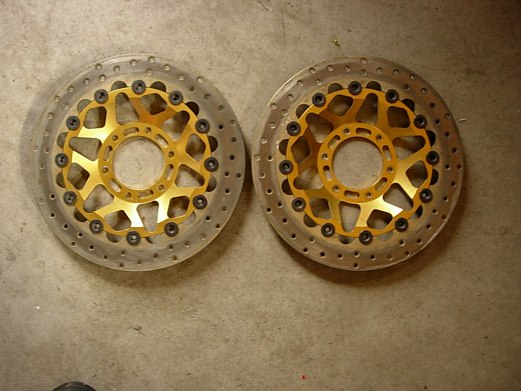

  6. These will fit, Duc 851/888/916 Brembo corsa brembo 320 racing.jpg
