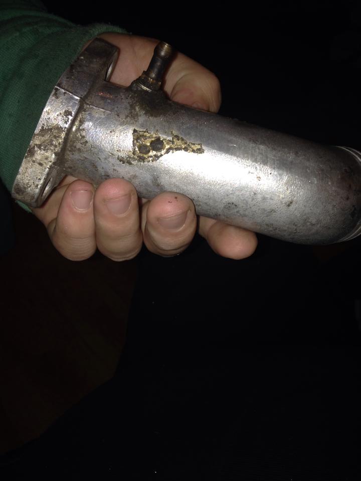

    So, after my other thread, in which it became apparent I had fitted 600 manifolds to my 750ss engine, and in effect restricting it. I bought a pair of 750ss manifolds.
    All good, but I notice they have little take off things. My old 750 didn't have these, nor my 600. so I am wondering what they are for? It is probably a dopey question, but one I thought worth an ask! I am planning to simply blank them off and fit as normal.
    Please see the pic for what I am referring to.
    Cheers,
    Ben
  2. Looks like someone has added a permanent spigot for the balancer tubes.......
    I have two screws on each manifold one on the outer side and one the inner side, which I have stuck an M5 allen screw in each one.........
    Or....maybe some silly sod fitted a performance vacuum gauge!!!
  3. There is a blanking screw on the other side.
    I'll just blank them off :) after a decent polish of course!
  4. Cheers both! valuable info :)
  5. the manifolds will be off a monster,it will be the vacume take off for the fuel pump.Did you check out the difference in bore size?
  6. They will work OK......
  7. hmmm.. either way, they'll be blanked off :)
    I am going to do them tonight! I'll make note of the size difference for reference. and I did note the '7' on these.
  8. Is the correct answer, blanking them will be fine usually one has a little rubber cap that blanks it off while the other goes to the pump
