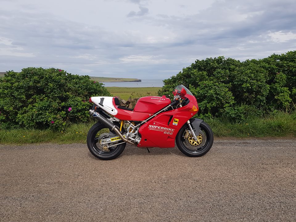

    Oh and your 888 is stunning, thanks for the picture :upyeah:
