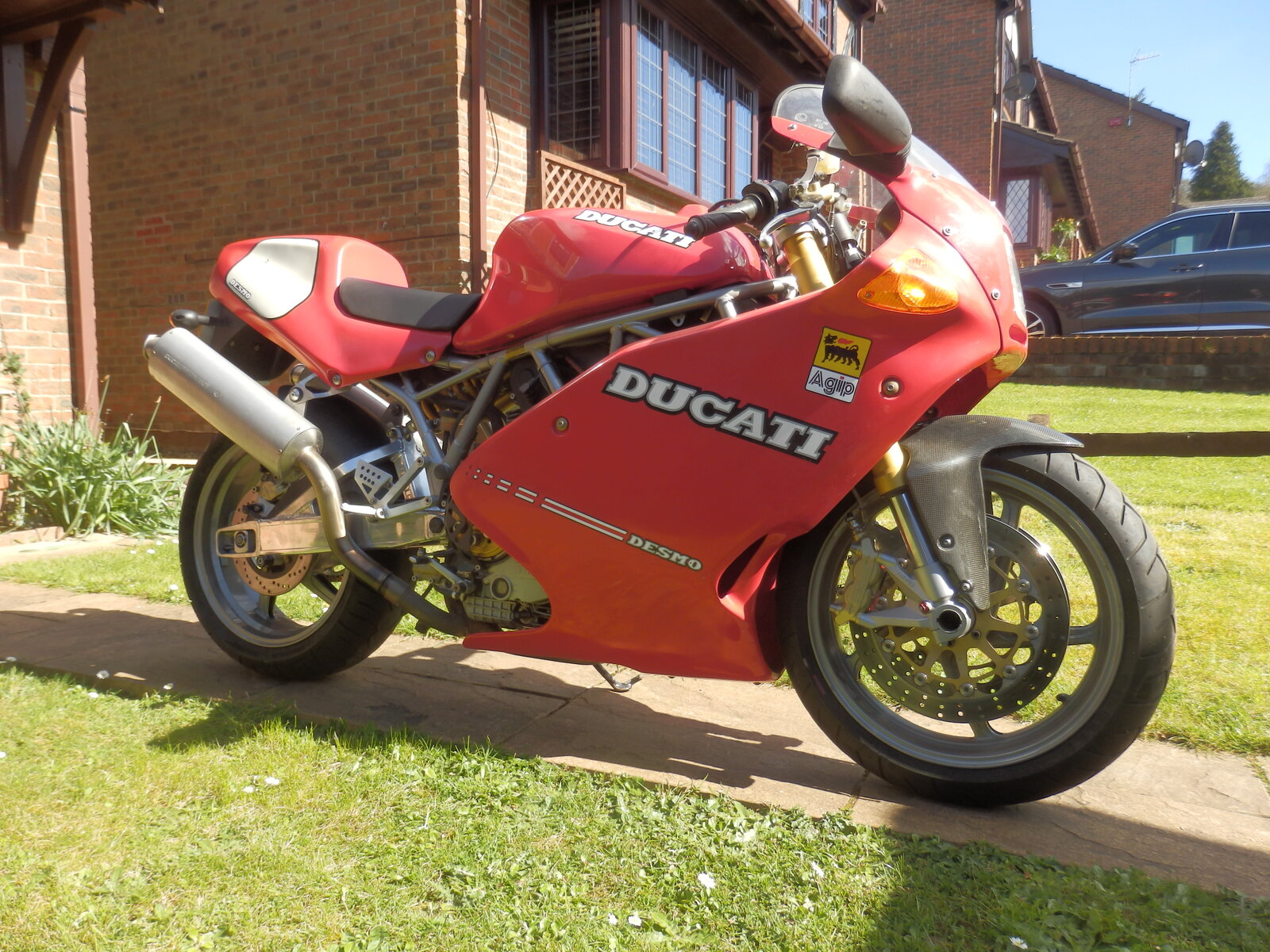

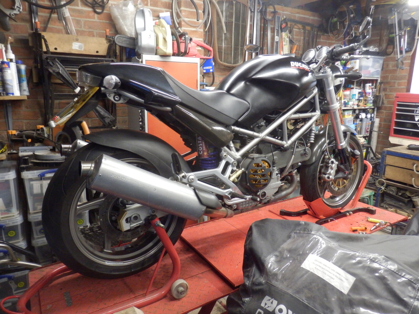

    I have 2 bikes with Marchesini 5 Spoke wheels, my 2005 1000SS/SL Mongrel which came with them as a 1000SS from the factory, and my 2004 M1000 which I converted to them as I prefer the look to the more common 3 spokes.

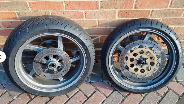

    When the Wheels below came up for sale quite locally on Ebay with new tyres at a really good price I snapped them up as the SS needs new tyres.
    They were advertised as from an ST4S.
    The plan was to pop the new wheels in the SS after changing the rear bearings, and still be able to use it whilst getting the old wheels Powdercoated Gold, then swap the tyres over so the SS ended up with the new tyres on Gold Wheels.
    The Front wheels swapped out seamlessly, as expected, but I did swap the discs over for the ones currently on the bike as the new wheel had quite rough very early M900/SS discs on it.
    I changed the bearings and internal spacer in the Rear wheel, fitted it with the SS Sprocket carrier and couldn’t get it to fit the Swingarm, the assembly was just too wide.
    This was where my belief that all the 5 spoke wheels fitted to bikes of this era are identical fell down.
    Hence warning other people.
    Careful measurement has revealed one small but game changing difference. The raised bosses on the wheel that the Cush drive rubbers are pressed into, and the central boss for the wheel bearing are 5mm taller/longer on this rear wheel than on the other two Rear wheels. Bugger.
    I started thinking about how I could machine the wheel back to the same size as the others, including deepening the Bearing counterbore, but had to come to the conclusion that my own Lathe/Mill just wasn’t big enough to take the wheel. Bugger2.
    I retired disjected to a cuppa in front of the telly and realised that in my particular case I have a really simple solution, especially as it will be temporary until the old wheels are powdercoated.
    As part of the recent fitment of a JMC Swingarm to the SS the bike now has a 9mm spacer between the Sprocket carrier and swingarm, so I can easily move the wheel over 5mm. It will then be properly central in the bike, and the Caliper carrier will fit where it should the other side.
    There is @8mm of additional thread on the gearbox output shaft so I can pack the front sprocket out 5mm with a hardened thrust washer, and I can move the plastic chain ‘slide’ over a few mm on the swingarm.
    However, Beware, if you are buying these wheels to use in a different Ducati, despite looking identical they may not fit.
