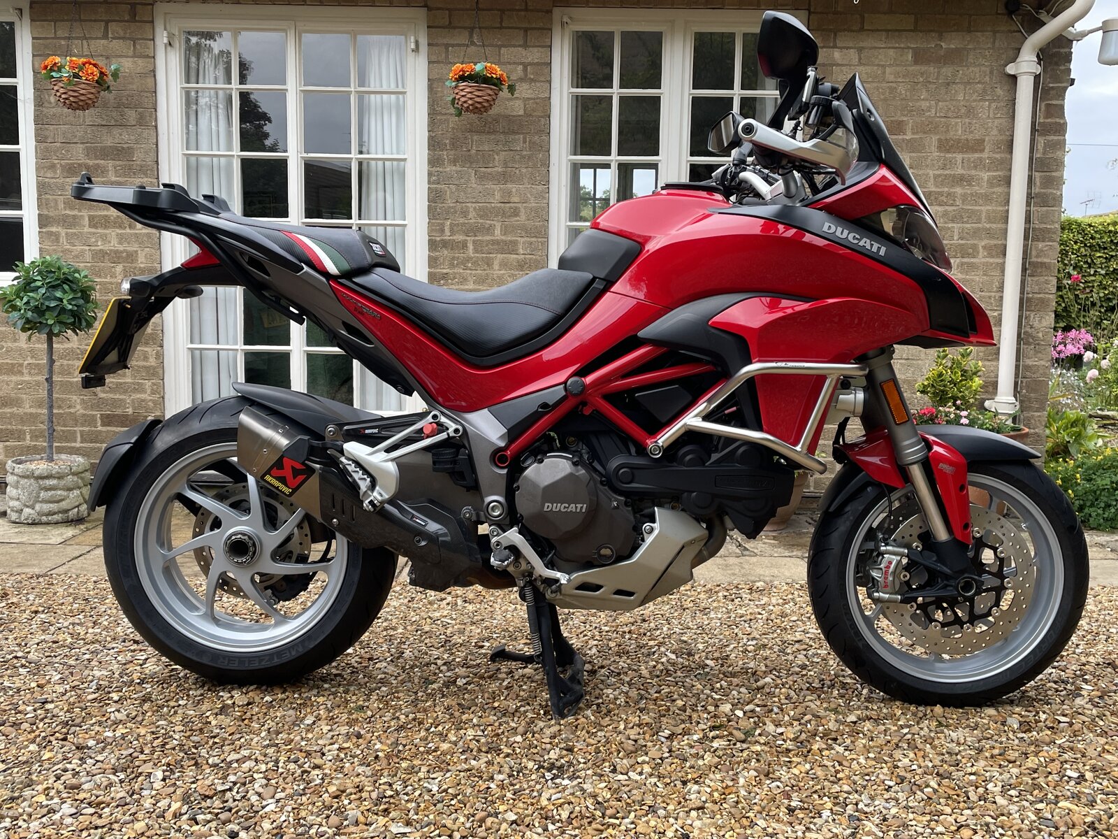

    Hi Meng, 1198 wheels will fit the DVT’s. I changed the bearings in Marchesini’s, no problem with the right tools.
