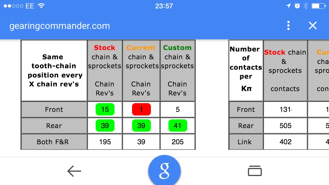

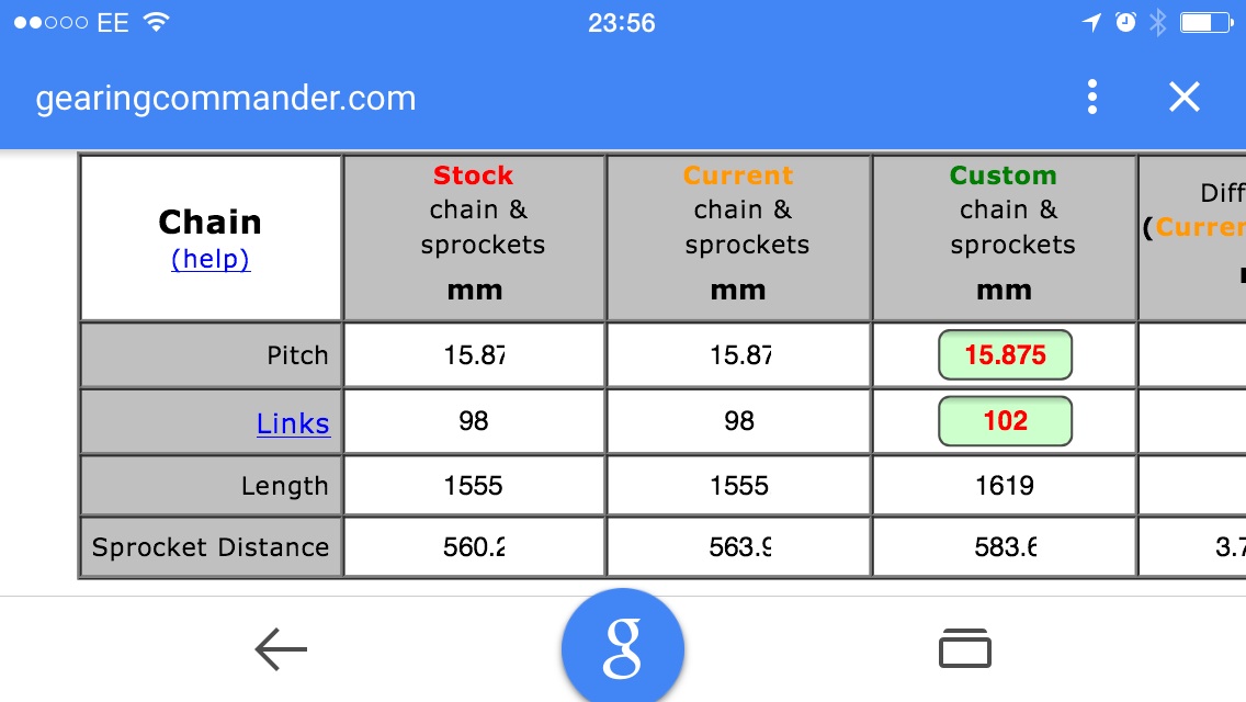

  16. A natty tool on Gearcommander is at the bottom of the page which shows you the distance between sprockets as you change them & the chain
    Stock 15-39 98 Links
    Current 14-39 98 Links
    Custom 15-41 102 Links
    Shows an increase of 24mm between sprockets
    Interesting is this one
    it shows that 98 links & 14/39 is not a good combination for wear
