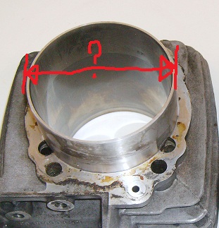

  1. Can someone please measure the OD of a 900's barrel/cylinder Spiggot.
    The part which sits inside the crankcases.
    92mm ID ?? OD
    Cheers
  2. Is it not same size as piston so 92mm?
  4. Will a OD of 102mm fit inside the crank cases ?
  5. Not without boring the openings as the cylinders are a snug fit. Don't know how far they can be bored?
  6. My bad, 102 that number sounds familiar? DS barrels?
  7. Imola,
    The cylinder is in the loft but corresponding female housing in the crank case is nominally 100 (measured 100.1), from a 92 900ss so ties up with dukedesmo.
    Cheers Gaz.
