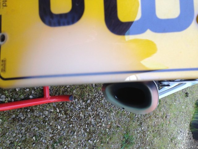

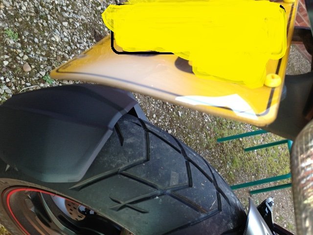

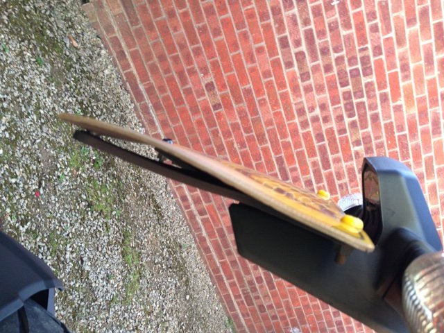

  1. Disappointed isnt the word, done 400 miles and the number plate is melting on the PP with the full Termig system. Missed a phone call from Ducati Italy tonight but they are calling back tomorrow, I guess to ask if I am happy with the bike which I am except for the melting number plate! Had to buy a new one on Sat to go out for a ride incase Mr Policeman pulled me. :mad: IMG_1278a.jpg IMG_1277a.jpg

  4. Very common issue, covered to death on here eventually the rear splash guard can melt also if you're carrying a bit of weight
  5. I mounted mine on sheet of aluminium with small washer better plate and sheet cures issue. Ducati response is for racing use so wouldn't have plate!!!

  7. I have put a prototype ali plate with exhaust tape in between and seems to work but looks pig ugly. Will look to modify on prototype number 2....

  8. I've noticed with the termi pipe and termi footpeg / exhaust mount that it mounts too close towards the tire. Even with the smaller american plate it melted the reflector and blackened the turn signal. Before I powder coat the rear foot peg / exhaust bracket I'm going to bend it out as far as I can or maybe even cut and weld it to hold the muffler 1 or 2 inches further out. It's not the greatest design for the money. If your taking your pass. pegs off andy has a bracket designed that could probably be made to move out a bit.

  12. Did you come up with a MkII solution for this, or did you stay with the square of aluminium? I've just ordered my full Termi system and I thought I'd sort out the number plate before it arrives to head that issue off at the pass. I've seen recommendations for using aluminium and also various heat tapes and wondered if you had come up with the perfect solution :)

    Just ordered the sticky backed heat reflecting sheet off eBay recommended by Psy69, 6000 miles and 9 months and the plate is going black and bendy, so I need to do something.
