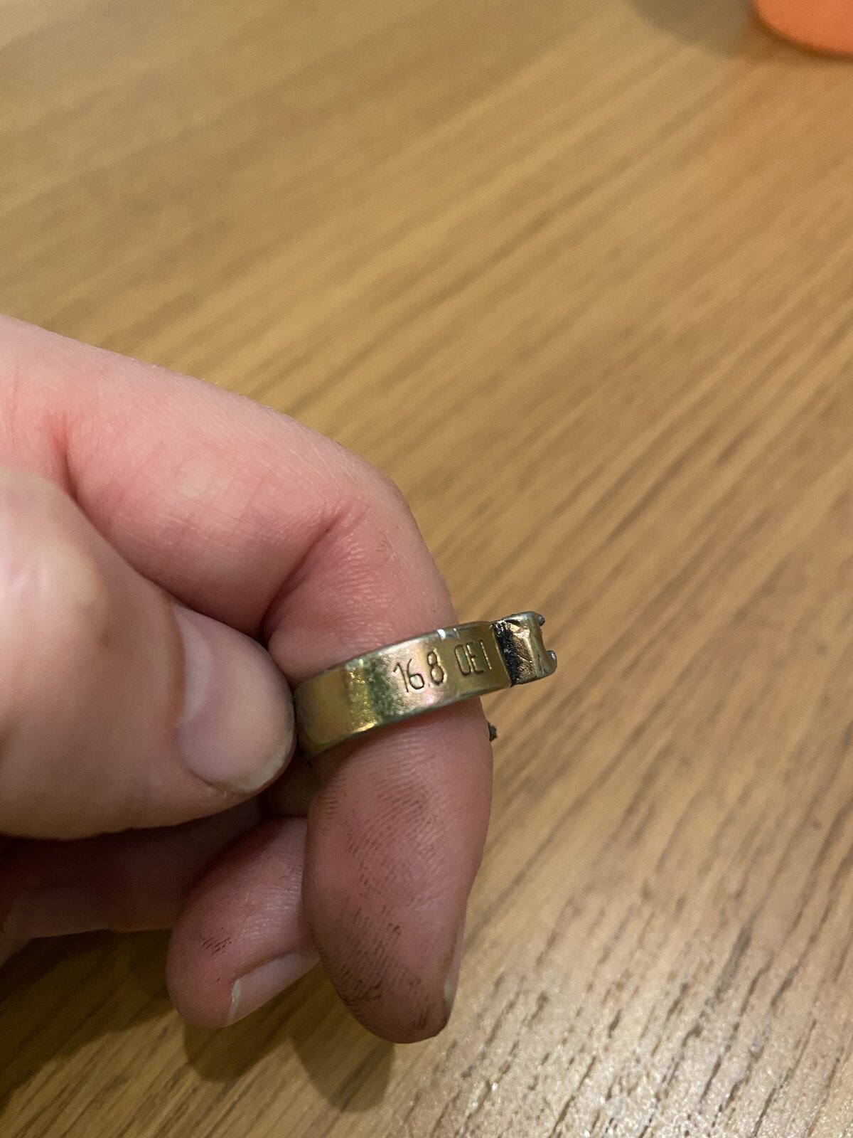

  14. So this is the clip, oetiker 16.8 it says. Now, I look for it on eBay and only see min and max diameter reference. Am I right I’m presuming that 16.8 is the max?
    the ones on eBay are 14.8-16.8 oetiker clips
    just so I order the right ones!
  15. I had a poke around my spares box but could not find my spare clips. Hoped to be able to confirm for definite. Can’t find them, but, if I were to guess I think you are right 16.8 max. When you pinch the ears it clamps down as you know and I think a couple of mm sounds about right. Someone May well know for sure. @Denzil the Ducati ?
