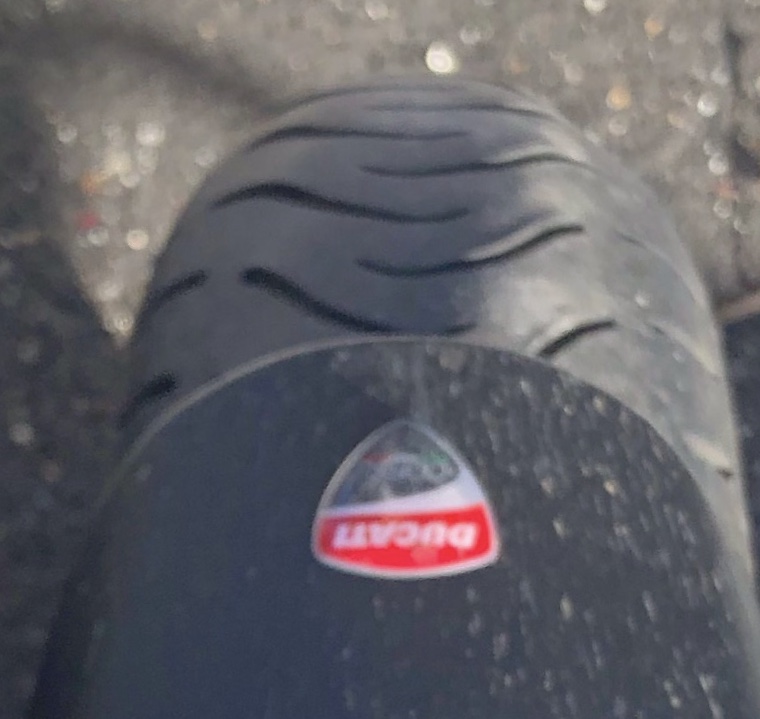

  1. Bought a 2nd hand set of Metzeler Roadtec 01’s for the dvt ( not interested in the ‘oh bloody hell 2nd hand tyres !!! ‘ )
    I did want pilot 4’s , but none in stock
    Rear with 6mm , front 4mm ..pressure tested etc, no repairs £100 fitted by respected mobile fitters

    You’ll love this !,!, in my opinion the 01 was just about the poorest quality tyre I’ve ever run. Never felt confident in its feedback and wore out in a very short time leaving a bloody awful shape. Front felt like it was going to under on every right turn (And yes I’m a quick rider with over 40 years experience) upload_2020-5-7_17-22-22.jpeg
