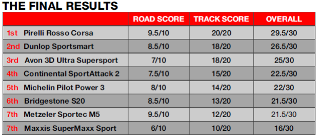

  6. fwiw : Perfomance bikes tested there is to test... the differences are huge.. i keep a close look at tires as well and frankly, i haven't heard anything yet to change from the Pirelli SC2 's ... grip is something you can't get enough off.. :)

  7. No racetecs on there though.
  8. true , but 20/20 track and 29,5 total seems like pritty damn good and bloody hard to beat... :) and the a 15% gap with nr2 Dunlop is also impressive. reads a bit like game, set and match...
