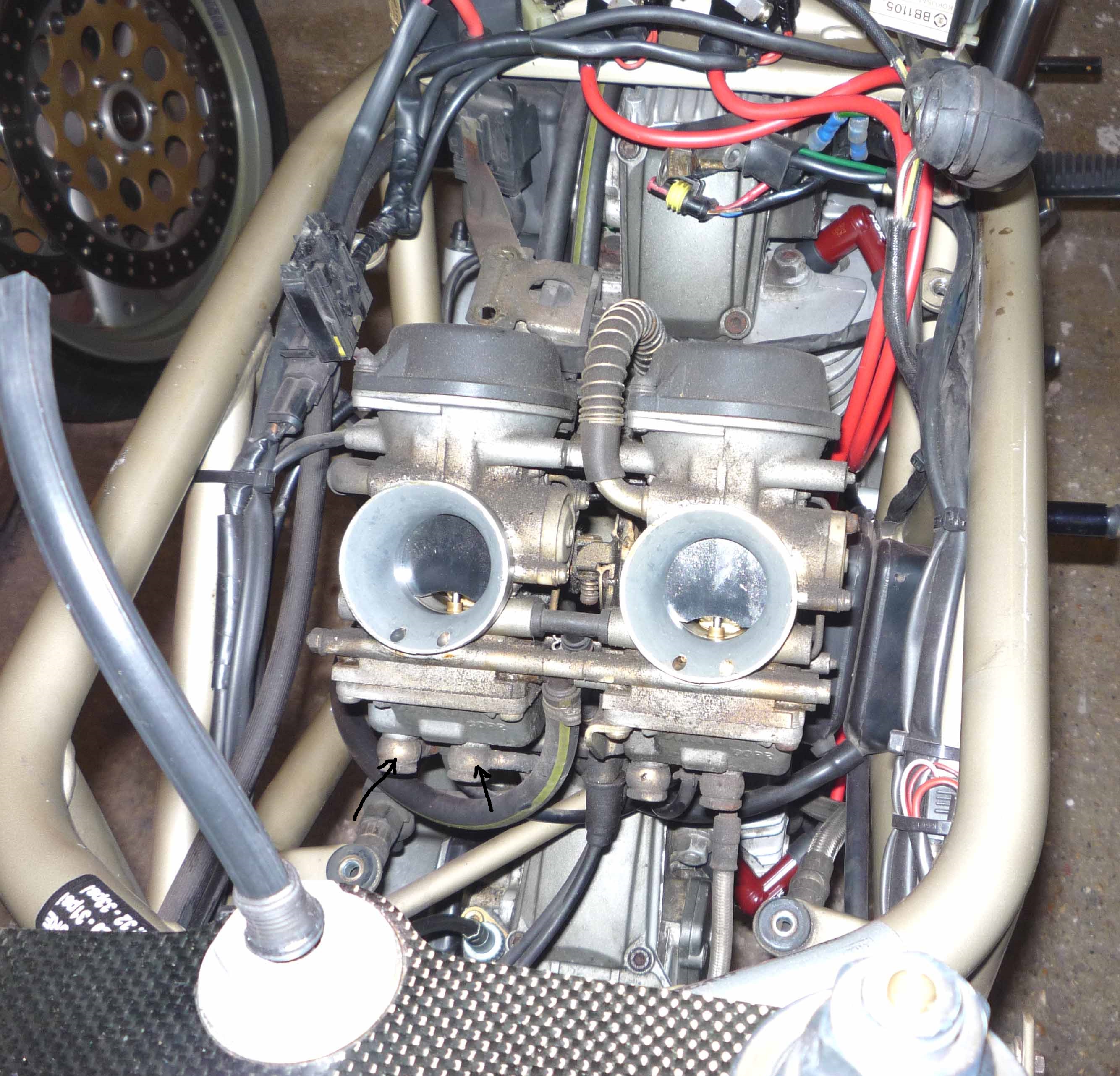

    What are the unions I`ve arrowed in your pic and do they have copper washers?
    I`ve been quoted £350-ish for this job, that`s to remove, strip, clean and replace the carbs, that`s the price if it all comes apart with no rounded bolts etc.
  14. The banjos are for the carb heaters, you may or may not have these, they are the same fittings as the brake lines.
