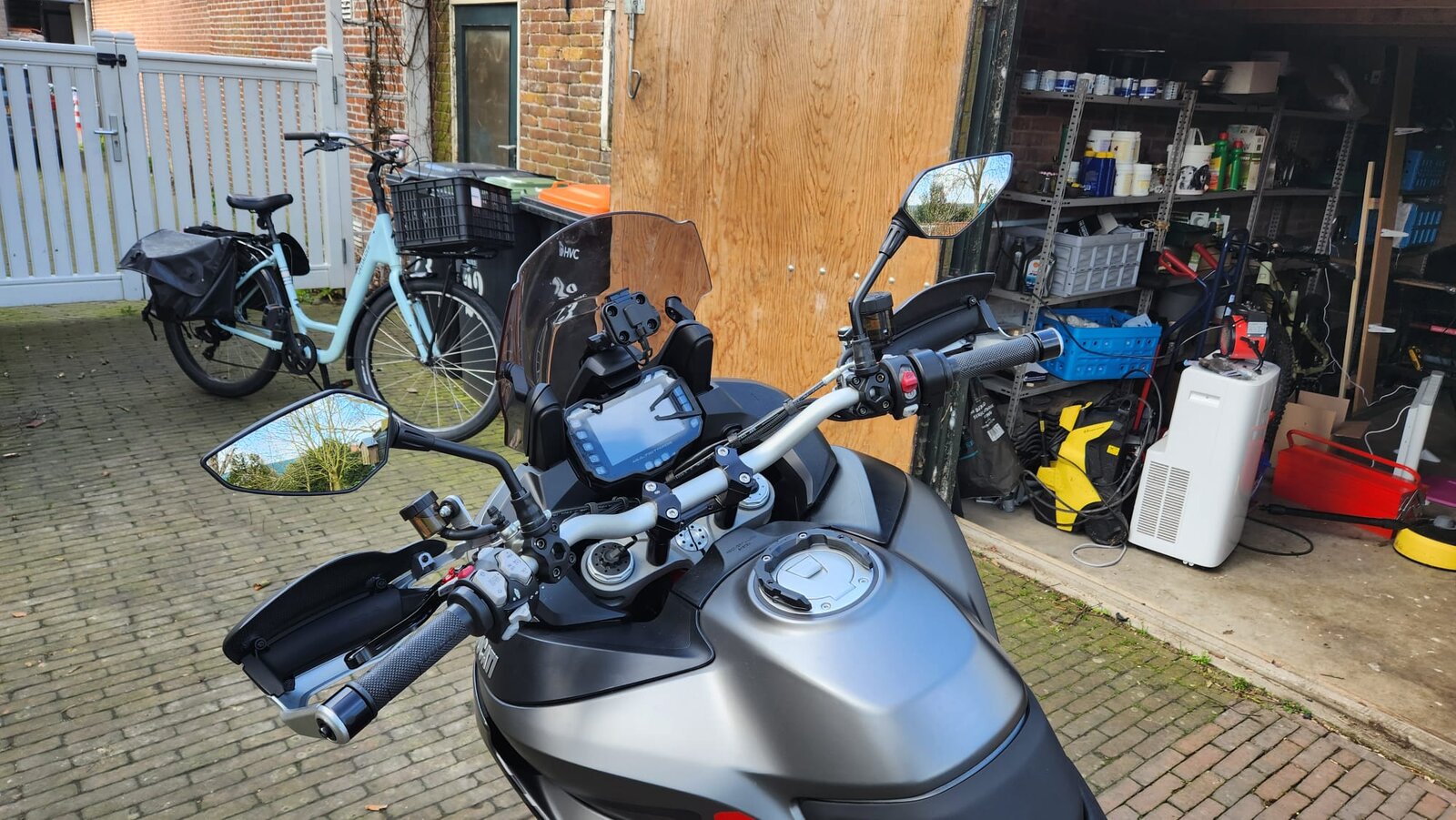

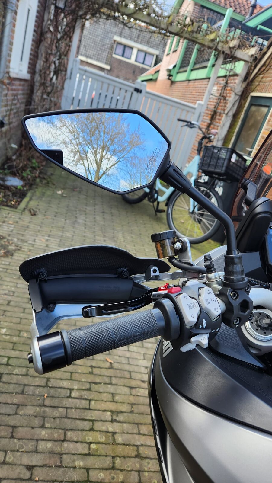

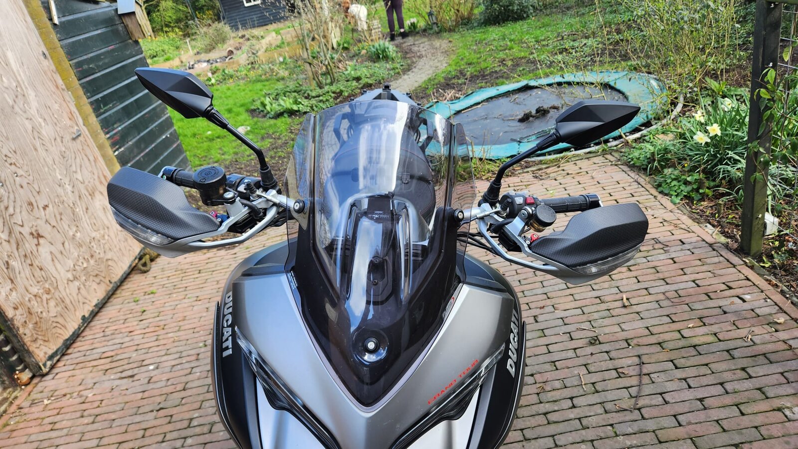

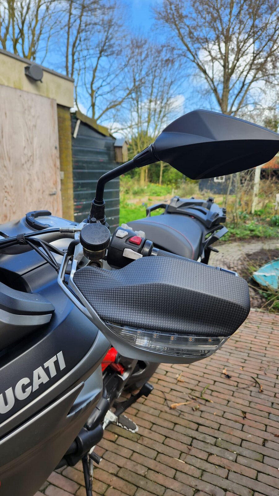

    I replaced the mirrors with the following and after a recent trip to Spain, I can confirm that visibility is drastically improved (no excessive vibrations unlike OEM) and with a rubber gromet provided, they sit very well and I've been able to adjust the bar tilt according to my riding style. As an added bonus, I don't feel as much wind turbulence on my shoulders. Although I can't confirm, it may be placebo.
    Oh, and adjusting them on the road is a breeze compared to the old ones. No need to faff about if you have a pillion or not.
    I ordered the following:
    Mirrors / Adapters / Bar Risers
    Pics attached of the results
